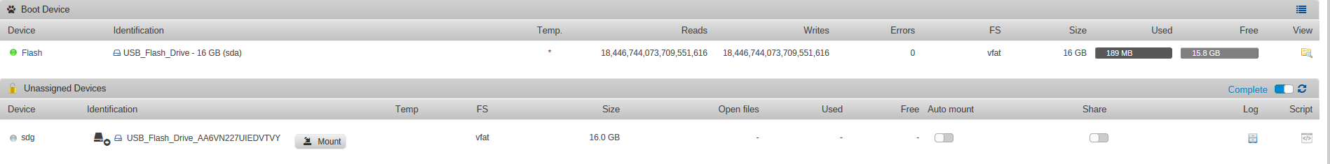

Boot Device is an Unassigned Devices too?
look at the picture, my stick is as boot device and unassigned device and the config is not loadet, so i have no docker etc.

after a restart it shows normal but this is in the log:
Tower root: error: /plugins/unassigned.devices/UnassignedDevices.php: wrong csrf_token
Is the USB-Stick broken ?
Can i use another and not loose all my settings ?
It's either broken or dropping out, try a different USB port, USB 2.0 preferred
Okay i will try it and write back if it comes again
thank you
