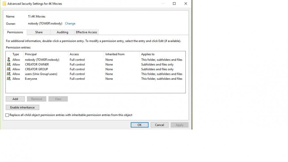

September 13, 20188 yr Until yesterday, I have not had any issues other than transfer speeds, copying from my windows 10 computer, to unraid server 6.5.3 Yesterday, I swapped out my C:\ drive with a Samsung SSD. Now the new Samsung drive is my C:\ drive and my old C:\ drive is now my D:\ drive I immediately began to get permission issues when copying folders between those 2 drives, and have finally figured it out. Todays issues is that I can not copy anything from either C:\ or D:\ to my mapped Tower Drive T:\Media 192.168.2.7 My Tower is mapped to my main Media folder T:\ drive and normally I use windows explorer to drag and drop between windows and my server. Now I'm getting a Destination Folder Access Denied Warning. Then it says you need permission to perform this action, try again or cancel. So, I have 7 or 8 folders setup up under 192.168.2.7\media 4K movies Disney Movies Downloads Fitness Videos Kindle Books Looney Tunes Movies Music Videos My Music Shared Photos TV Shows Sports Windows Software and Games When I try and drag and drop To most of these folders, I get that error. But not all of them. Seems like the permission issues I'm having are with the following folders Disney Movies Fitness Videos Looney Tunes Movies Music Videos My Music TV Shows Sports I also noticed that the permissions are different between the different shares

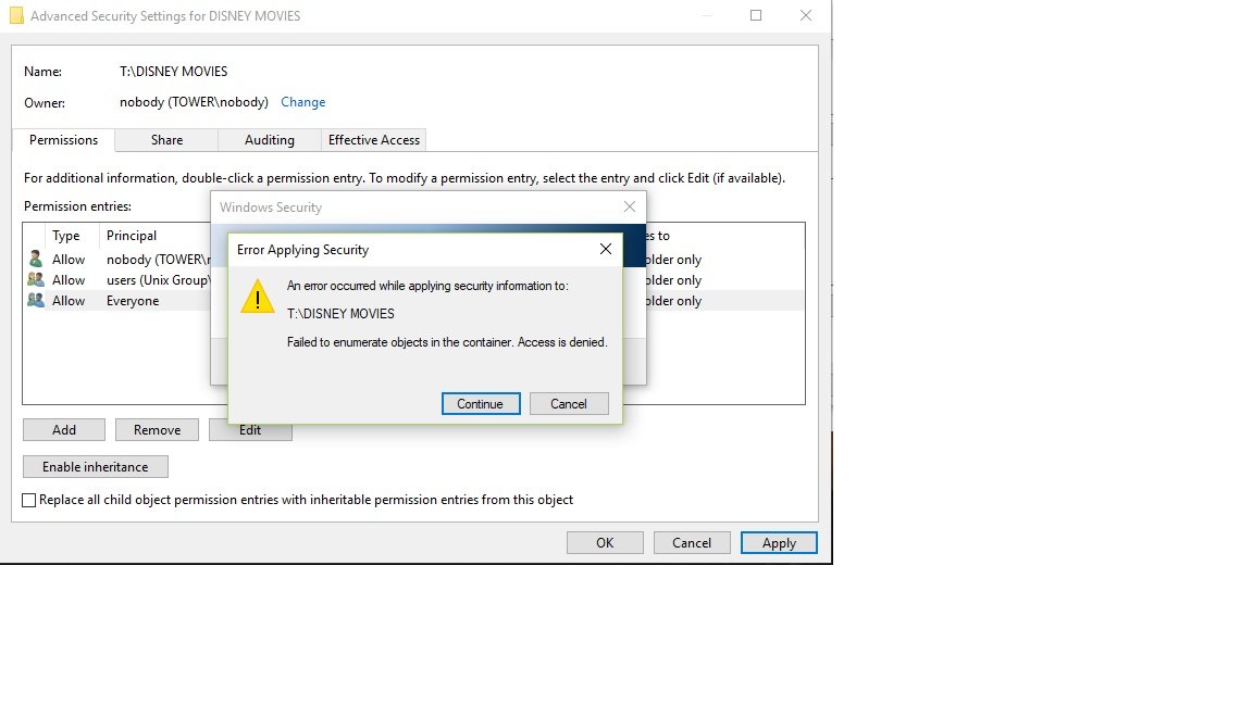

September 13, 20188 yr Author Now When I try and change the permissions, Im getting enumerate objects in the container, access is denied in the following folders 9 minutes ago, icemounty said: Disney Movies Fitness Videos Looney Tunes Movies Music Videos My Music TV Shows Sports

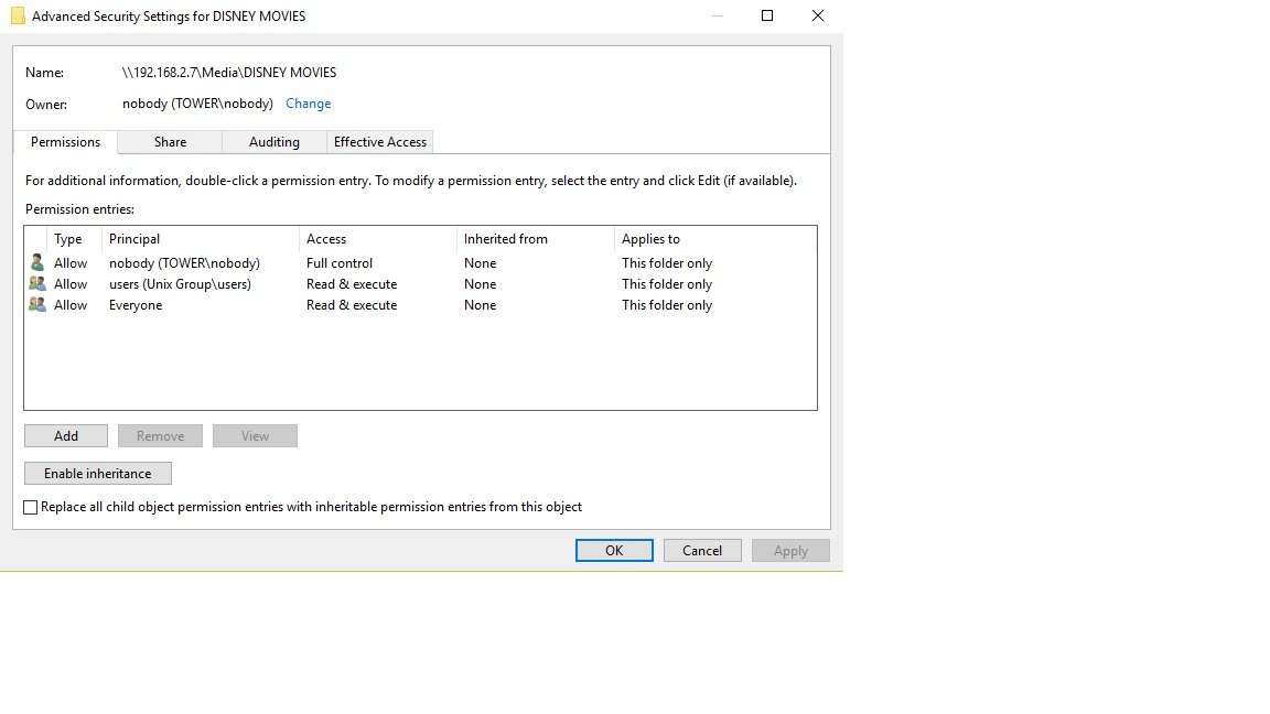

September 13, 20188 yr Author can I make permission changes on my unraid server by accessing the gui through a web interface, or do I need to make changes directly though the server? For instance, while using windows explorer, under advanced setting folders that has my Disney media, the owner is listed as nobody which I assume is the default ownership. It lists full control. But the 2 other (users and everyone) only allows to read and execute. I guess I just dont understand where in the gui I need to change the permissions back to where they were before.
