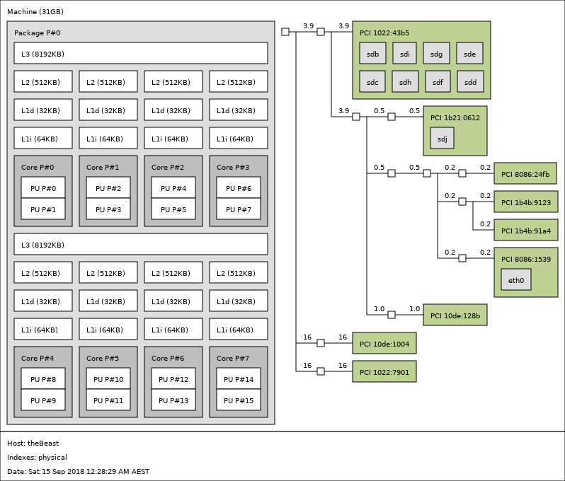

I installed some stuff to figure out what package is best for me to run cpu stuff on for my gpu, but wasn't quite sure how to interpret it. It seems I should be doing all latency cpu stuff on the first package?

Running the vm on 0-7 with unraid pinned to 8-9 has almost resolved it. The performance isn't quite 100%, but runs at 80 fps at worst and normally around 140 fps which is far better than it was initially. GPU load is around 95% once the textures have finished loading in which would probably indicate this is as good as I'm gonna get performance wise i would imagine. Its still lacking 30% of native, but is playable.
