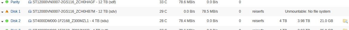

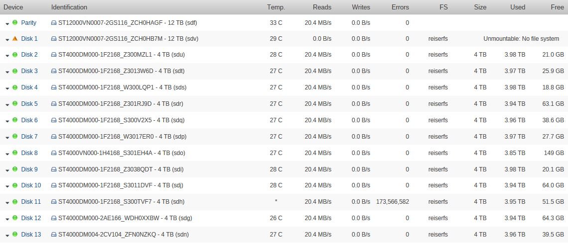

The rebuild just finished fine, without a single read error. Unfortunatly after a reebot the server is still showing drive1  as "unmountable no filesystem" like in the screenshot above, could this been an issue due to the 2 failed rebuild??
Edited by mason
diag removed
Thanks I did that, but for my understanding. Why does this happend if the rebuild starts proper from the beginning and does finish without errors?
This is the output of the check, It told me to repair the superblock. Then i did another check, which told me to rebuild-tree. I did that too and it came up with a handful of damaged files, no loss there. So far array looks fine. Can I be confident to go from here? I'm still a little estranged about the whole thing.
Guess for any further step I'll wait for the replacement LSI controllers... and might switch to xfs in a longrun.
thanks for your help so far Johnnie
