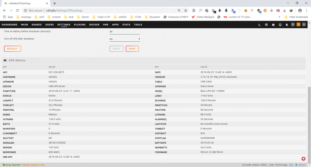

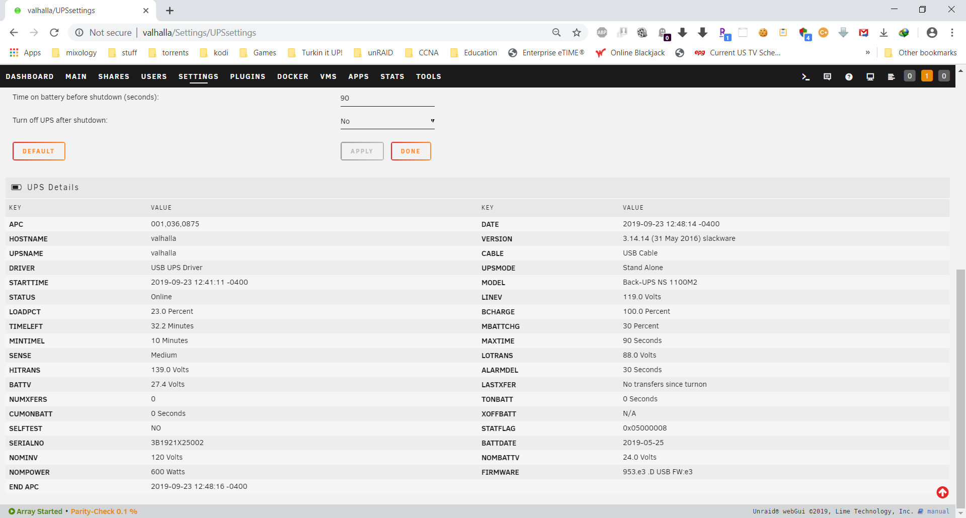

Just wanted to say that my old APC Back-UPS 550 finally bit the dust.  I had it for over 5 years & the battery has been replaced once.  I just bought a new APC Back-UPS 1100 & made no changes to apc-deamon.  It appears to be working just fine.
  • 4 months later...
I just replaced my UPS and I am running into the problem of not getting all the stats. I followed the instructions to enable modbus, but within NUT, that is not an option to use that as a device type. Has anyone got this working with NUT?  I have 2 unraid servers so I need NUT so the 2 servers can talk with the one UPS.
I just use the built-in UPS tools in Unraid (and I use the Modbus method).  Main server is set to master, the other is set to slave.  Timings are set to ensure the slave will shut down first.

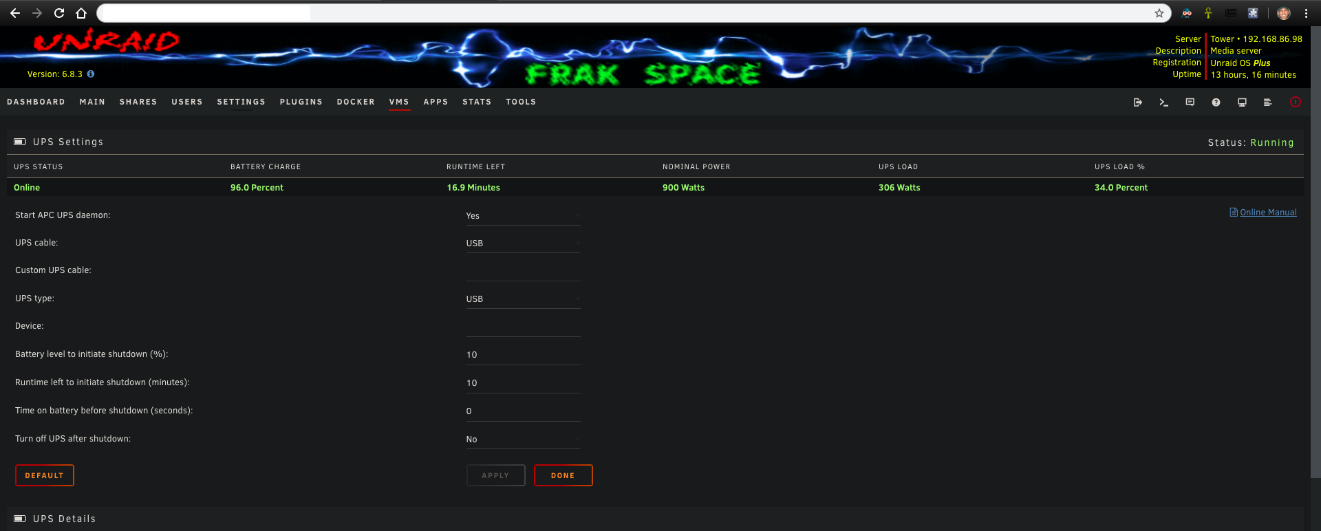

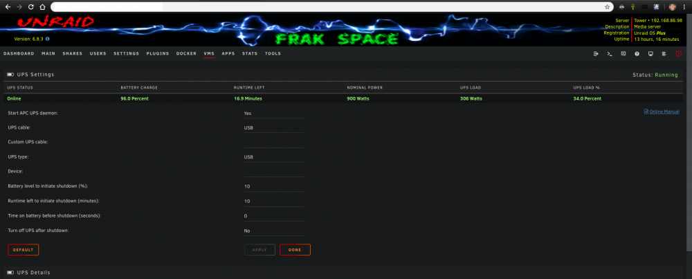

I wanted to share my settings that finally got it to work with my brand new APC UPS. I bought this unit from Amazon. It's a 1500VA BX1500M model.
 The settings in the above posts didn't work for me. Ironically, the most obvious ones did. Just set both cable and type to USB and it will work.
I have two servers on it which is probably why the runtime is only 17 minutes. I was hoping for more. Oh well.
WHY?  You really want ample battery reserves left when the final shutdown is completed.  The reason being that when the power comes back on, it will take eight-plus hours to fully recharge the batteries.  If you don't wait for the recharge to finish before you restart the servers, you may not have a enough charge to shut the servers down if you have a second outage.
What I suggest  is that you consider what type of power outages you have and how long they last.  In my area, if the power is out fifteen seconds, it will out for a couple of hours minimum!  So I have the power-on-battery set to thirty seconds.
