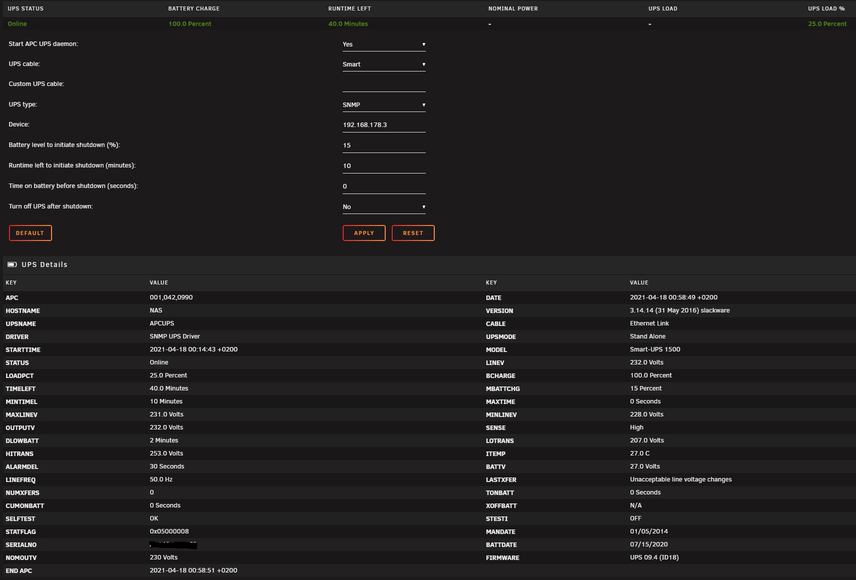

What's a good supported APC UPS for Unraid?  I'm not looking to power the server throughout the night just 10-15 minutes enough for it to shutdown safely.
Hey,
is there any way to show up the "nominal power" and "ups load" with my UPS?
I use a APC Smart-UPS 1500 with UPS 09.4 (ID18) Firmware.
The UPS is connected with a Network Management Card 2 (ethernet cable).
@i-B4se, according to http://apcupsd.org/manual/manual.html#connecting-apcupsd-to-a-snmp-ups , you may try to populate the "Device" setting with "IPAddr:161:APC", in case the autodetection of the "vendor" qualifier fails with our UPS.
Another option seems to switch from SNMP to PCNET protocol, see http://apcupsd.org/manual/manual.html#powerchute-network-shutdown-driver-pcnet  , if your UPS/Network management card support it.
But it's pure guess, I have no practical experience with Network Card / SNMP APC UPSes.
Good luck, from my painful personal experience, getting apcupsd to work properly with an APC UPS with USB connection can be a long story ...

Anybody found a solution? I'm trying with a Smart-UPS C 1500 and afer upgrading to ver.14 no Load is reported neither with NUT Settings nor  UPS settings. Modbus is not available in that model and would like to enable load reporting.
Thanx!

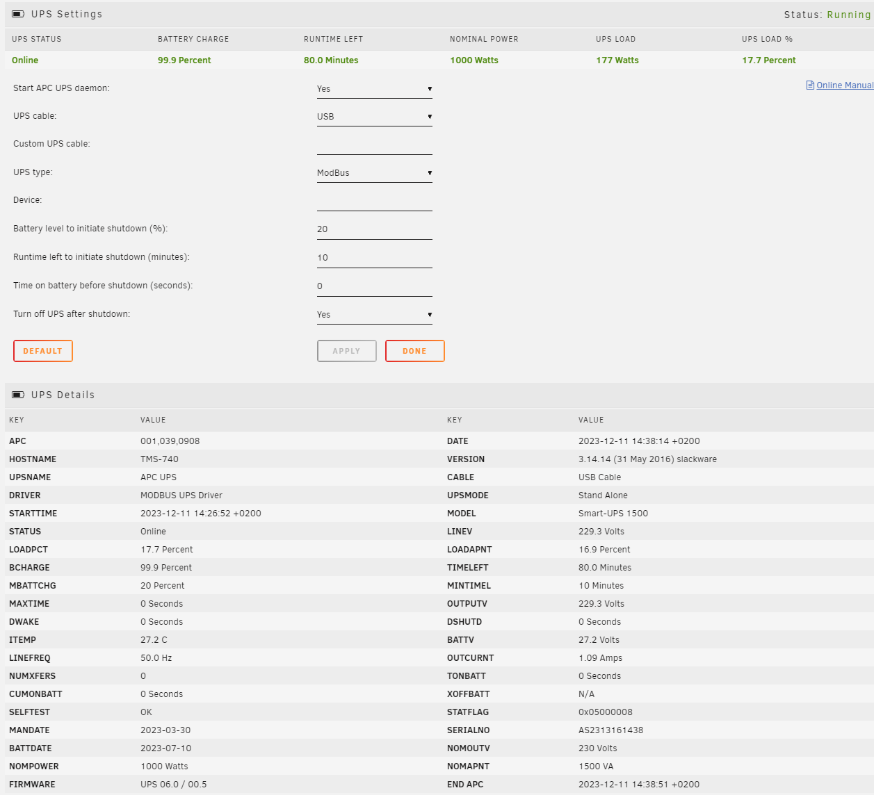

On 10/19/2020 at 4:48 PM, Gnomuz said:
Hi all,
I wanted to report an issue I have with my brand new APC UPS SMC1000IC (tower model) on my DIY Unraid server (6.9.0 beta 30).
After many attempts stopping and starting the daemon, with the UPS plugged or unplugged, I finally reached a stable behaviour :
- when the server boots with the UPS plugged in, the daemon gets fanciful information, and the workaround is to unplug the UPS, restart the daemon, plug the UPS back, and everything is back to normal
- when the server boots with the UPS unplugged, and I plug it after the boot process is over, communication with the UPS is established, and all information are correct at first sight
So, I highly suspect the apcupsd dameon establishes the communication "a bit" too early, at a stage where the USB "stack" on my server is not totally ready (sorry for the improper words, I'm not an Unraid/Linux expert...). To try and sort it out, I thought that delaying the launch of the apcupsd plugin / daemon might be a solution, but I didn't find any setting or thread on this forum to do so.
Just got a SMT1500RMI2UC and was getting desperate. Thank you for posting the solution!
With my model the behavior is exactly same. Enabling modbus on the UPS and setting the Unraid APC UPS daemon to use USB/Modbus results in garbage values. I restarted the APC UPS daemon after I had unplugged and replugged the USB-cable. So you can do it in that order too I guess. Simply restarting the daemon without unplugging the USB did not work.
I have set my UPS to power off after shutdown so I will be manually starting the server and can check that APC UPS daemon initializes properly. Still it is an extra thing to worry about so it would be great to have this working properly.
I was getting the basic information with USB/USB connection but was missing nominal power, usage and others. With USB/Modbus I get it all which is nice for my InluxDB/Grafana setup. My previous Back-UPS Pro worked with USB/USB out of box.
As a side note this model has an integrated ethernet but it works only with the cloud based monitoring. No local web management or control. I did not understand this when ordering. To get proper web based management and PCNet/SNMP functionality I would have to buy the optional network management card. I feel a bit cheated...
