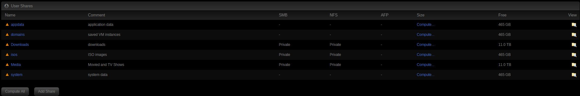

I attached some screens and diagnostics (before any reboot).

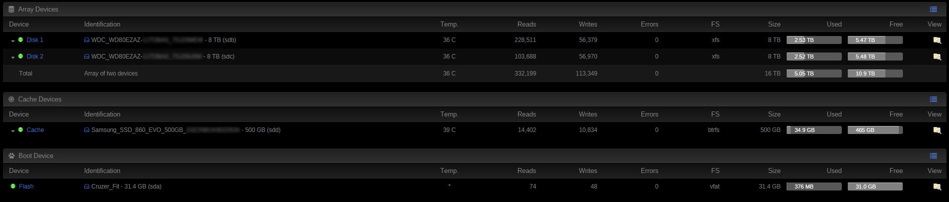

Is one of the disks full?

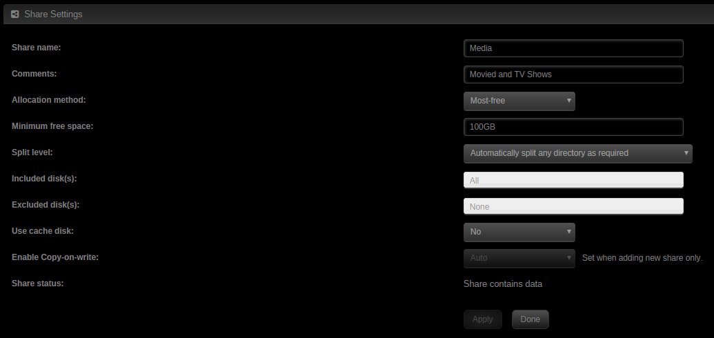

What did you set for allocation method, split level and minimum free space on the Media share?

All the answers to your questions can be taken from the screens I attached to my first post.
But here is the info you seek:
Disk full? No, each disk has 5+TB free space
Allocation method: Most-free
Split level: Automatically split any directory as required
Minimum free space: 100GB
I mean it works for now, after trying to copy the files to the upper directory. I don't know if this triggered something that fixed my problem. Just wanted to know why I had it in the first place.
Concerning shares: I'd like one share for media and subfolders for movies, tv shows etc.. Is there any reason this is not recommended?

Not a problem if you don't need different share setting for the subfolders, you can only chose settings for the top lever folder (share).
Did you change any of the share settings after you had the problem, or were they exactly as in your screenshot?

I had a minimum free space of 0KB before. Than I had the problem and searched this forum and found out this isn't a good idea so I changed it to 100GB which didn't solve my problem. Everything else was and still is like in the screenshots. It could well be that this is/was a windows problem.
