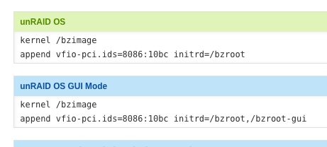

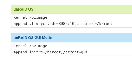

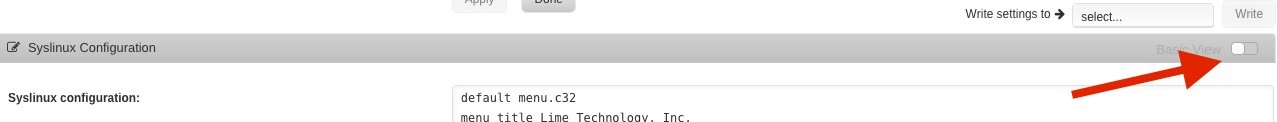

September 19, 20188 yr If you follow Spaceinvader One's guide, the "append" to the syslinux config is put in the spot for accessing unRAID via the default menu. If on the other hand you boot into unRAID via the GUI mode, then you must also append that. I found this out when configuring my pfsense vm and having to reboot multiple times, so I needed to login to the server directly via GUI mode, because the network would be down and not have access to unRAID to make changes, etc. Here's how: 1. From the "Main" tab, click on "Flash" as in Spaceinvader One's video. 2. Click on "Advanced view". 3. Notice the "Unraid OS" mode where you can see your previous append. 4. Notice the "Unraid OS GUI Mode" just below. 5. Append "Unraid OS GUI Mode" just like you did the standard mode. 6. Click "Apply" and reboot.
