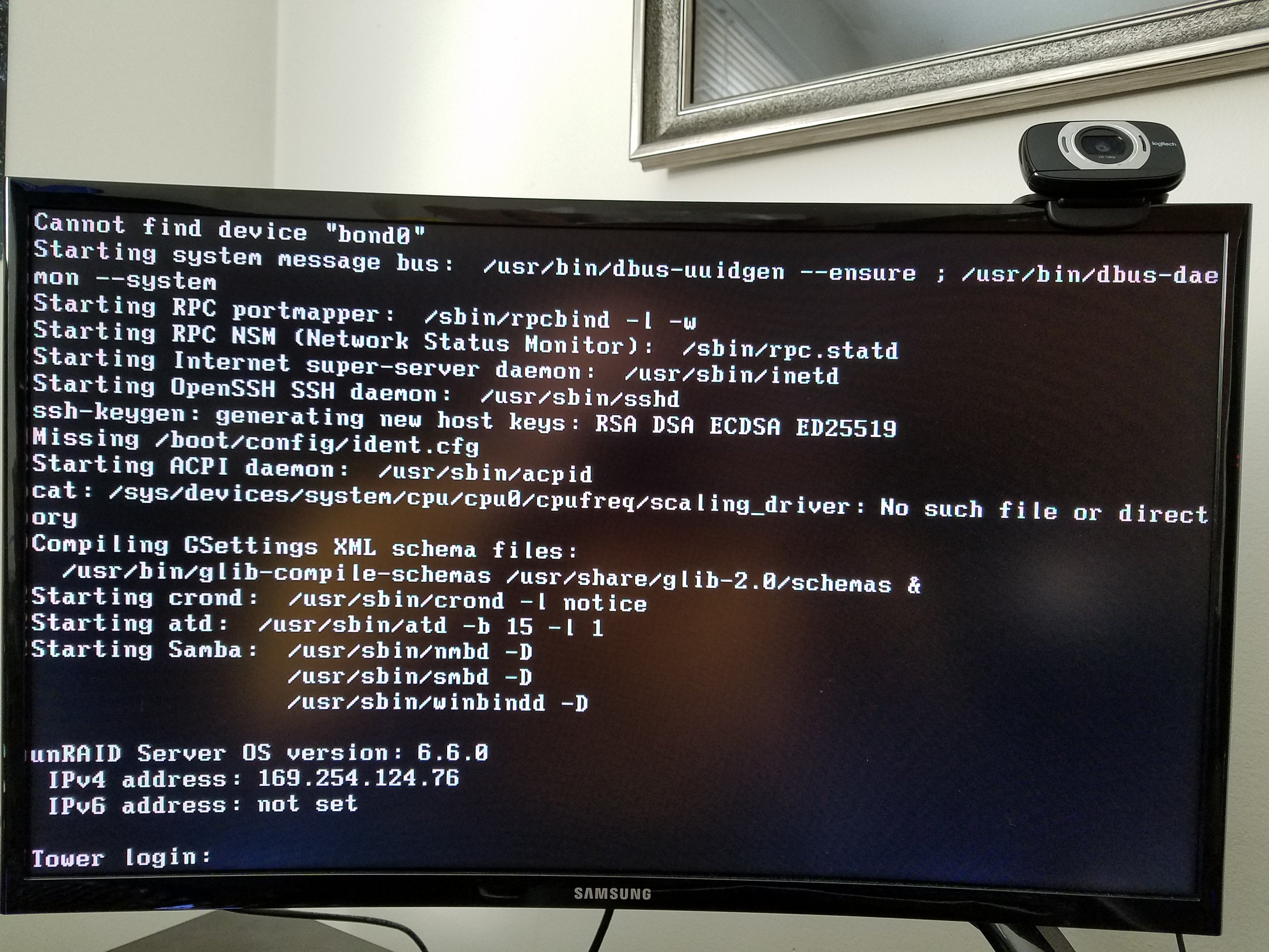

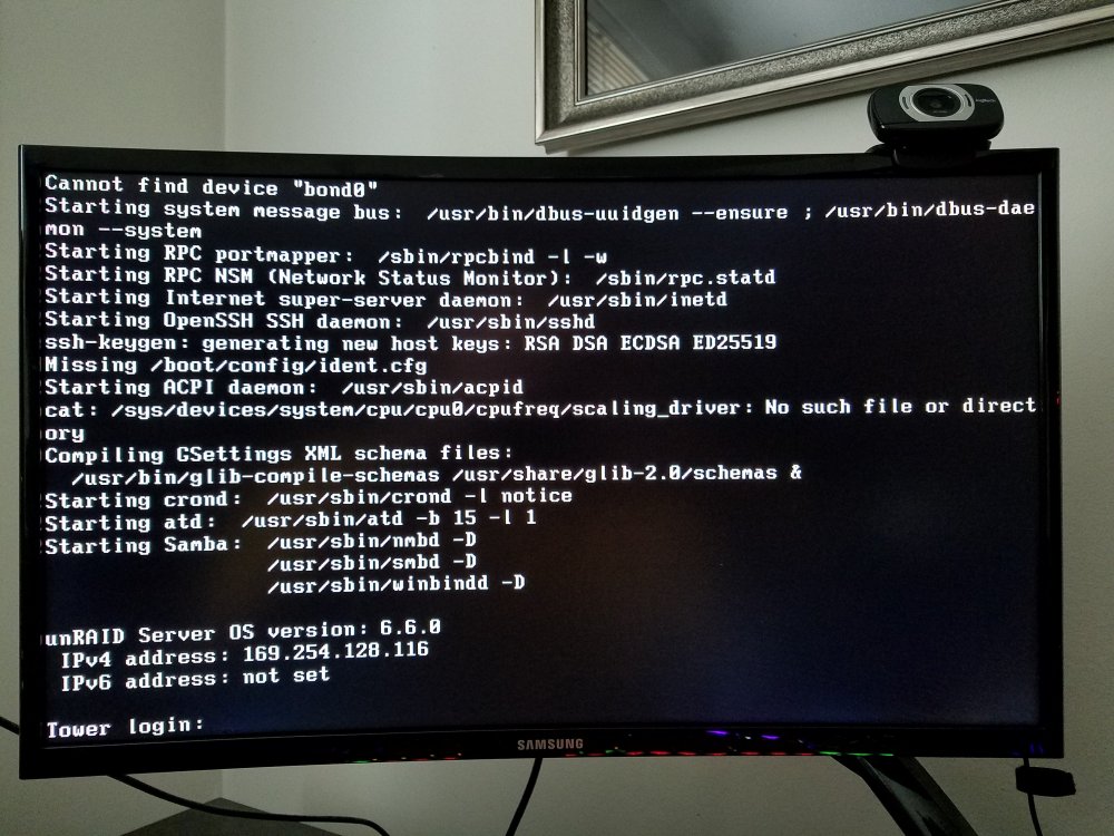

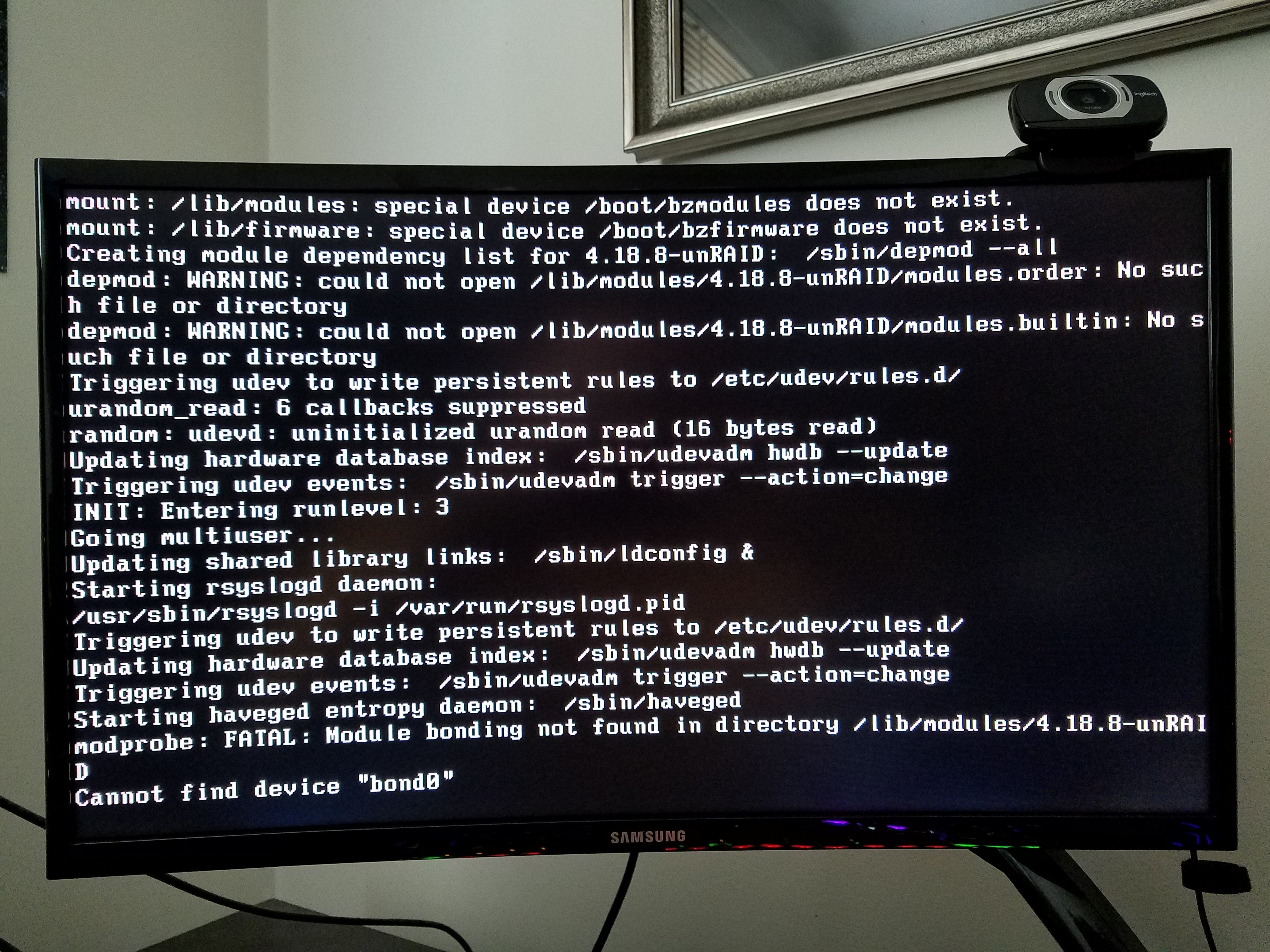

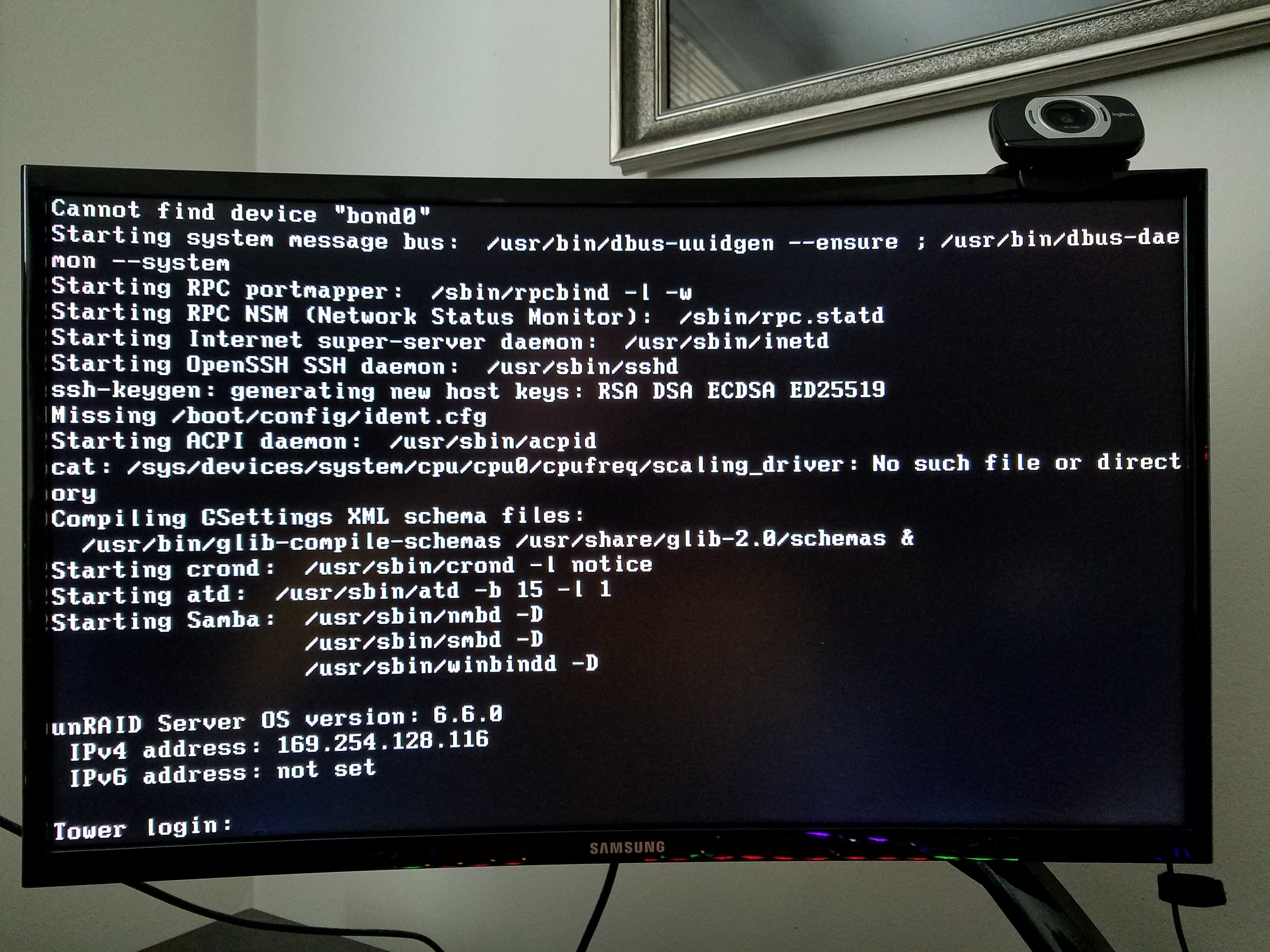

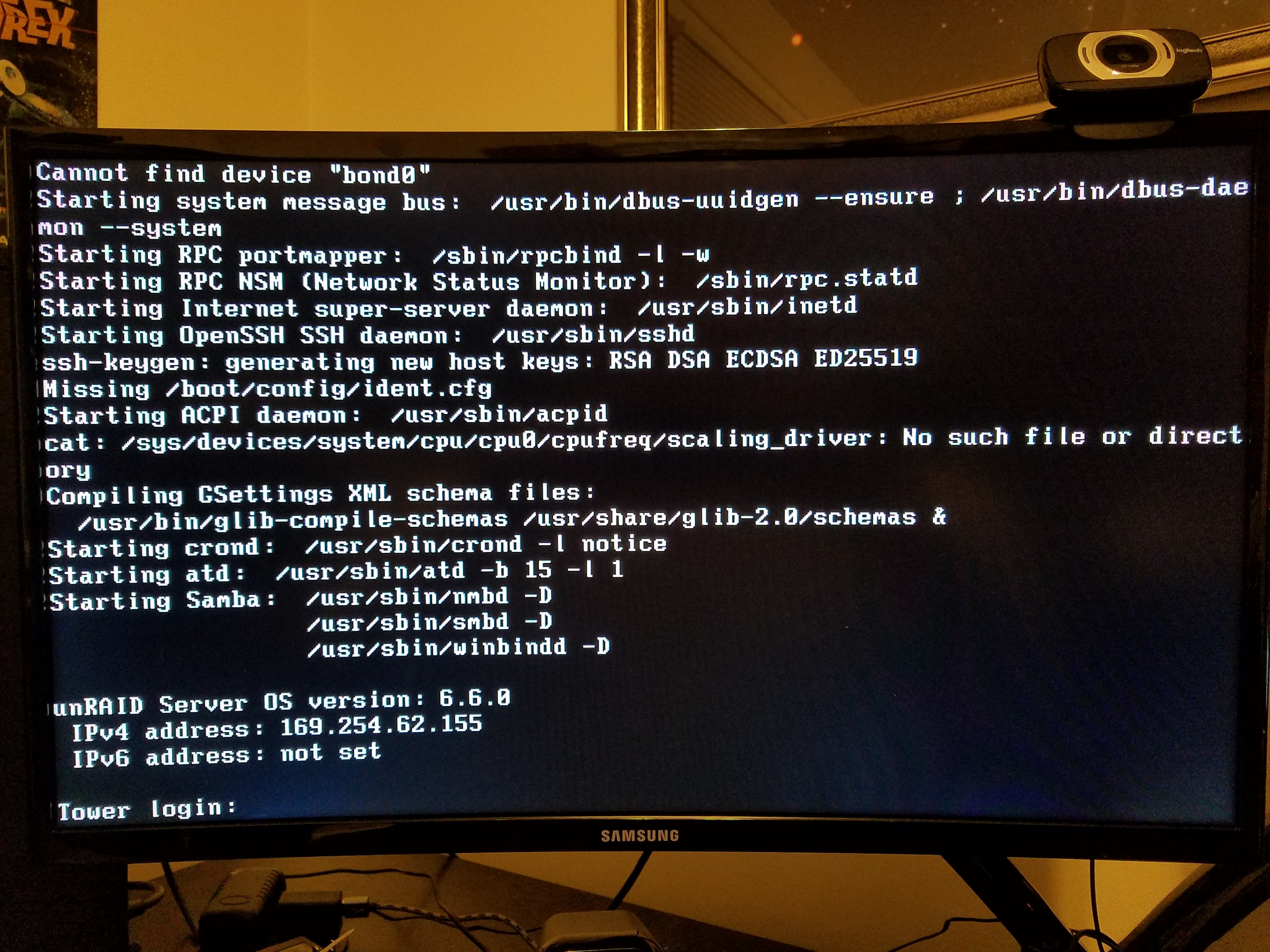

I just switched everything back to the original system and now i am getting a "Cannot Find Device "bond0"  I tried to save a diagnostic file to the USB, but it didnt seem to work.  Now it will not give me an IP to log in to.  I have even got a brand new USB drive and installed a fresh copy of UNRAID on it.
Delete from the flash drive config folder network.cfg and network-rules.cfg and reboot
I tried that already.  it didnt work.  I even unhooked all of the drives and just tried to boot from the USB, it still sees that the bond0 connection is not there.  It cant save it to the RAM, right?  That is the only memory that i can think of that would save a setting like that.

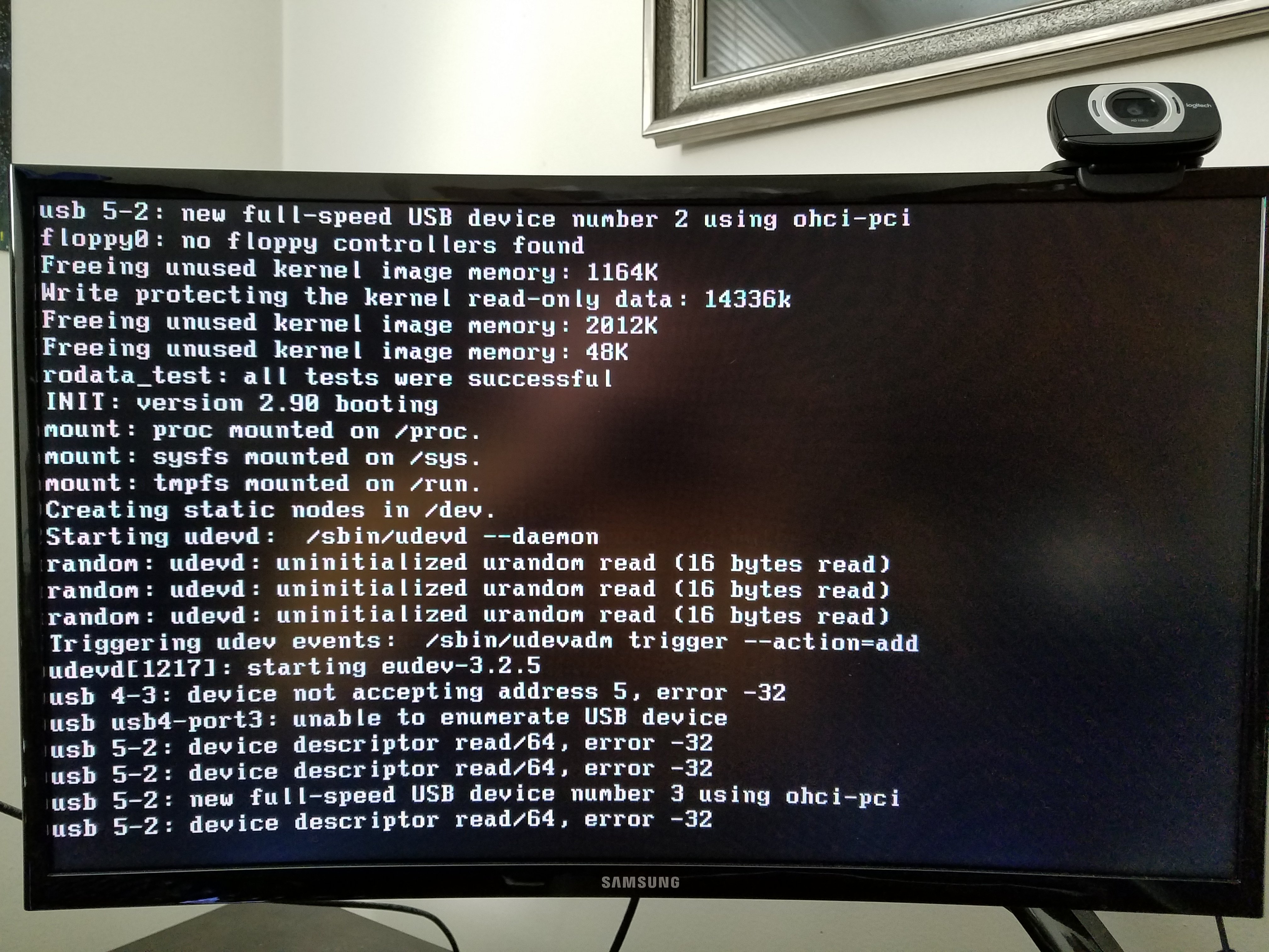

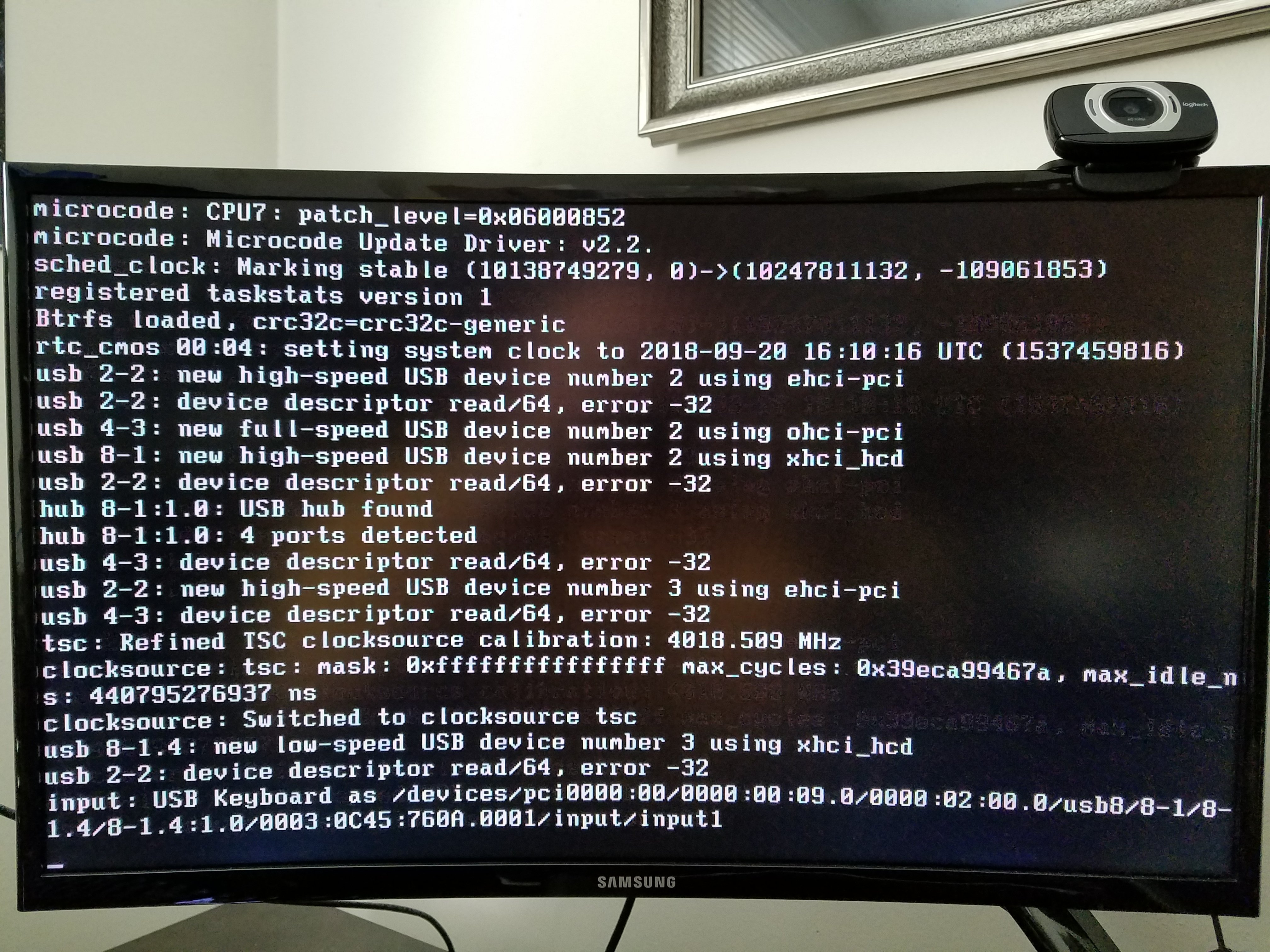

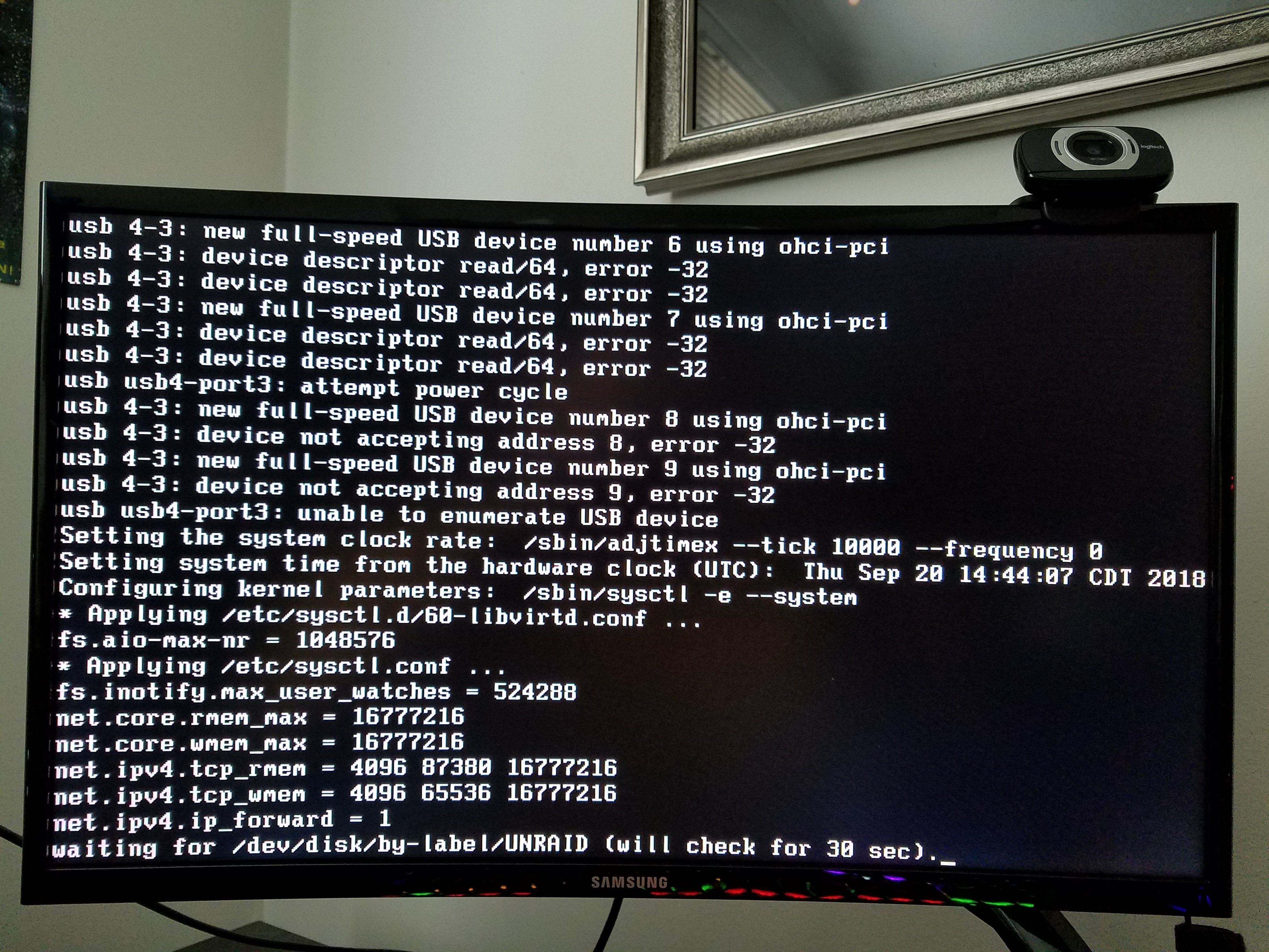

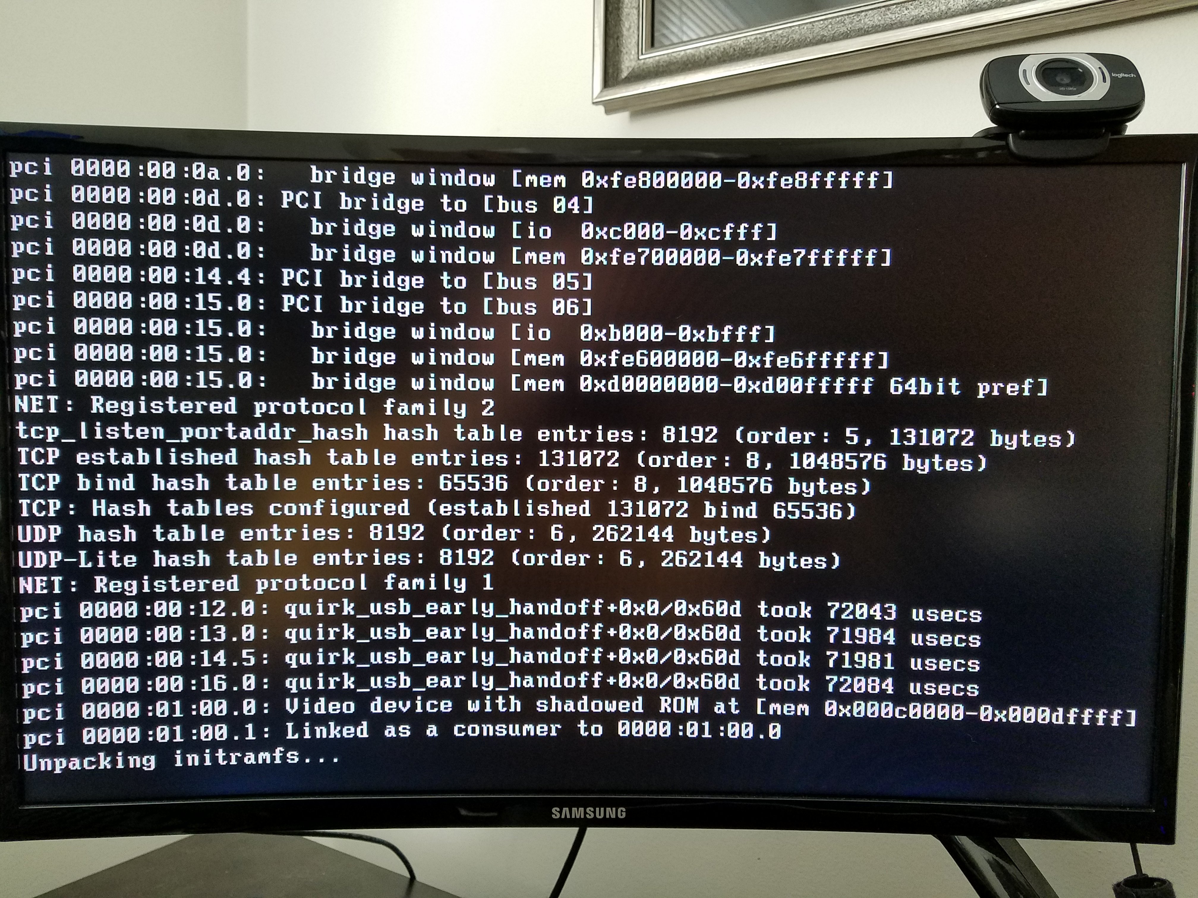

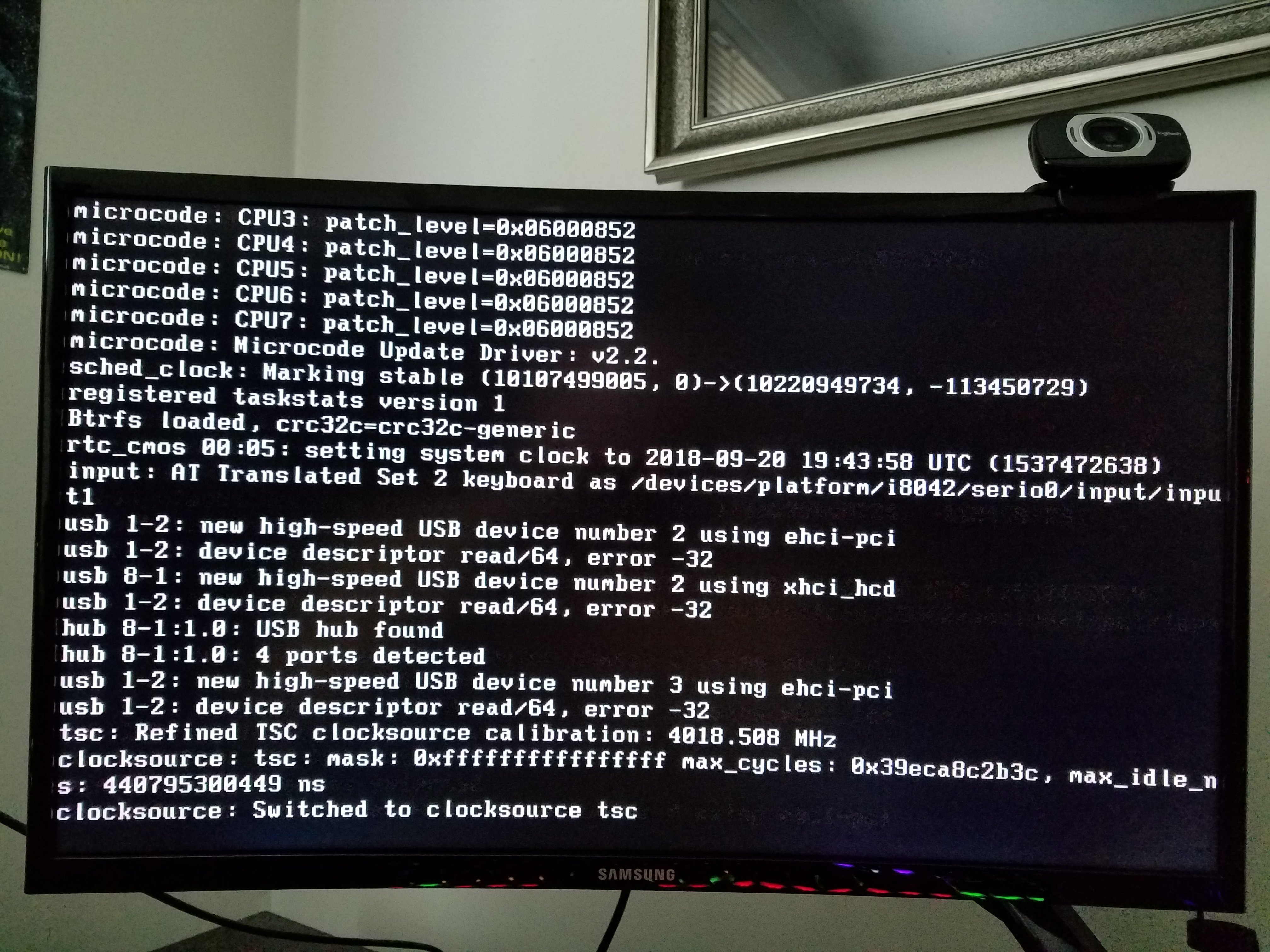

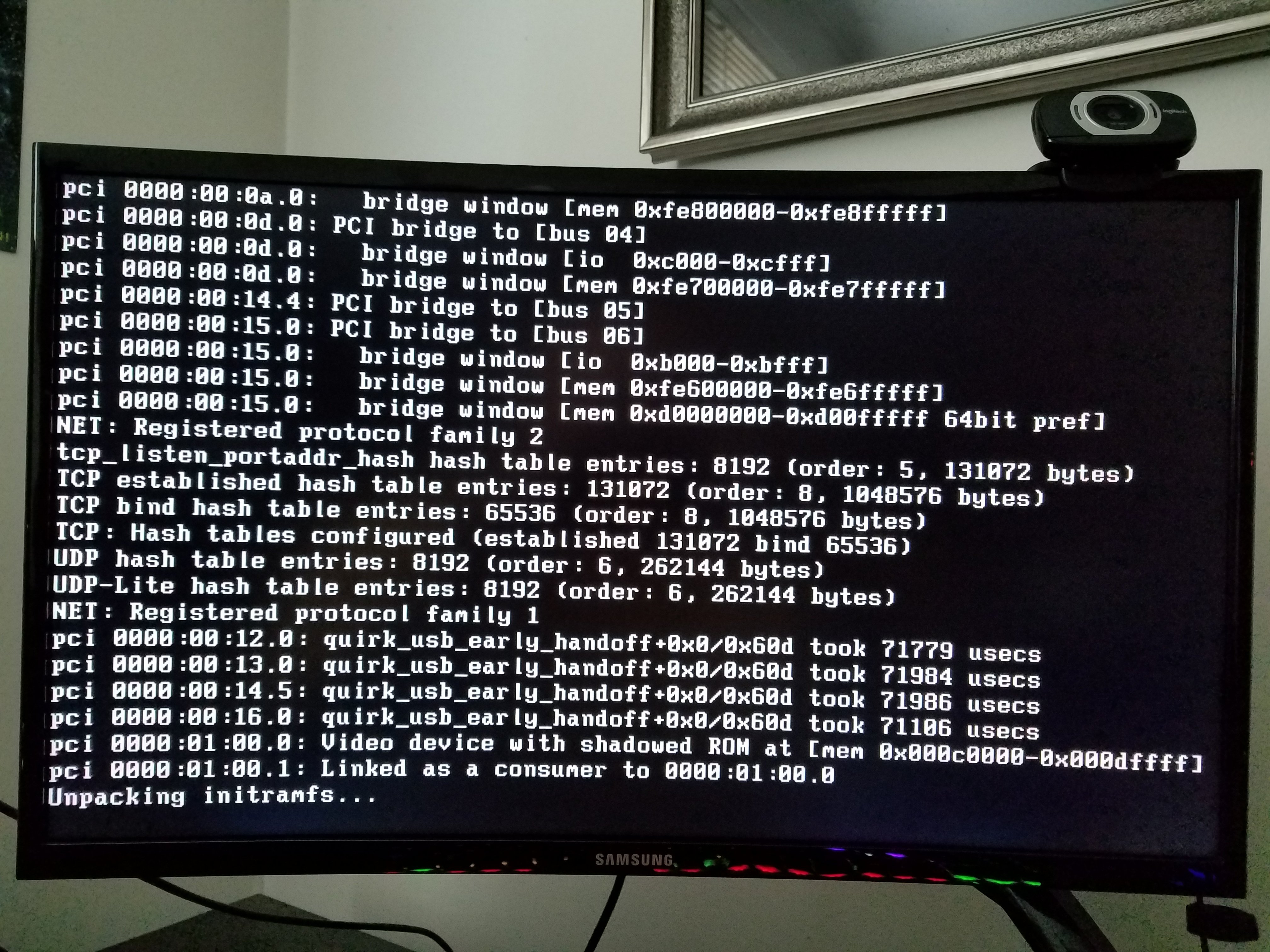

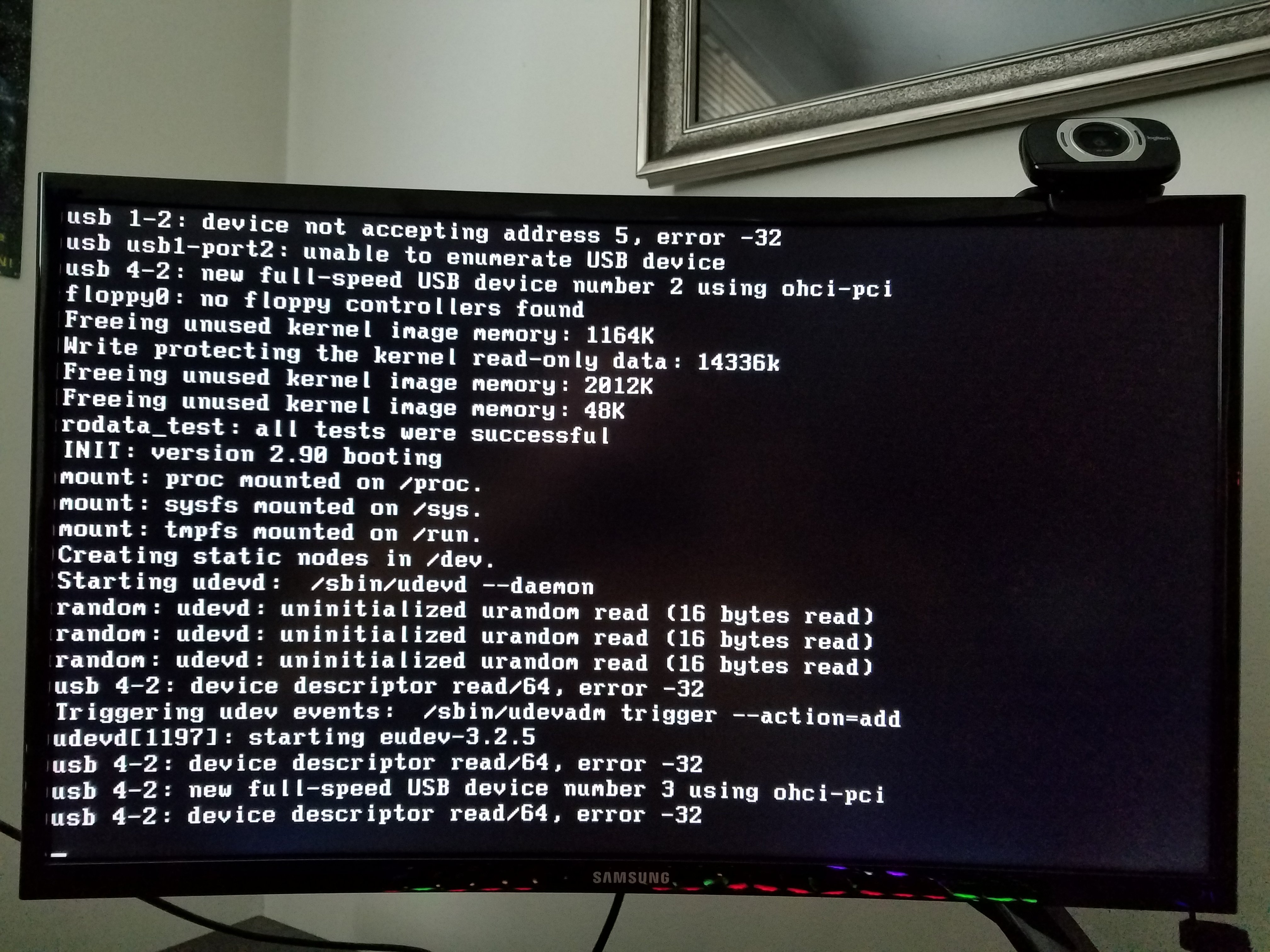

I took some pics of the boot up process.
Something goes wrong in reading your flash device.
Try the following:
1) Move the USB stick to another port, prefably USB2
2) Use a different USB stick alltogether
I have already tried 3 different sticks and all 8 of my ports on the back of the board.  I am so stumped.
I have an old 2GB USB drive that i will try.  But that is my last one.
Edited by UnlawfulMind
Something else you can try:
1) Reformat the USB stick (make a backup first if needed), label it as UNRAID
2) Download the zio file and unzip it to your USB device
3) Run "make_bootable"
4) Start the system with the newly prepared stick
I did what you recommended.  I went out and bought a PNY USB flash drive, 16gb.  Formatted, and unzipped the link you gave me to it.  made it bootable by opening in administrator.  Still doing the same thing.

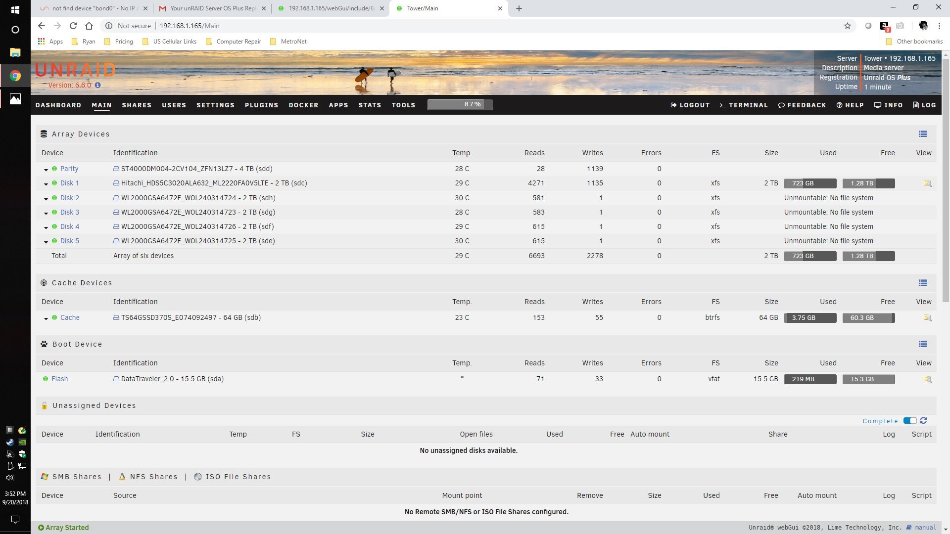

Im not sure what the issue was, but i finally got back in.  It must have had something to do with the USB drive.
I still dont have access to 4 of my drives though.Untitled.thumb.jpg.6719189e43c26fa2344750b264c9df61.jpg
I ran a check in Maintenance mode on one of them and got this.

This is now on the new server.  I was able to mount them.  THANK YOU!!!
I do have bout 200 GB of data in a lost+found folder.  Do you have any suggestions on how to restore that data or is it pretty much gone?
Not sure what you mean, the data is restored, but the filenames could not be automatically found. If you browse by size and have an idea of what type of files they were, you can manually rename them and they will probably work. Some file browsers will parse files and show content regardless of name.
It really depends how valuable the data is to you how much work you want to put into putting a name to each file.
I'd be concern to keeping using the new server without knowing what caused the corruption, unless the old server was using a RAID controller with a different config, but in that case I would expect the problems to be immediately visible when you changed to the new server.
I do see that there are a number of folders with different files in them that i can recognize.  The issue i have is the files that are not in folders.  They are just a bunch of random letters and numbers for names and no file extensions, so i dont know what kind of file it is.  Was there any software or anything that can look at the info and at least tell me what kind of file it is?
I think the issue was the USB and the ports.  It seems to not recognize the USB unless it is plugged in with a little force and quickness.  I cant just gently put it in the USB.
And again, thank you for your help.
