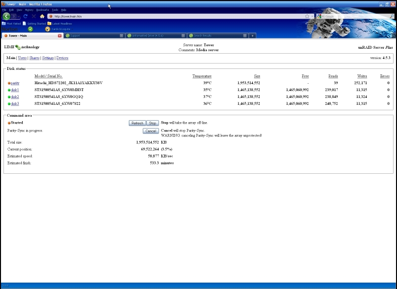

Here is the screen shot during the parity-sync. Hope this helps.

Would need more knowledgable folks than I, especially since I haven't looked at 4.5.3
But I think when you Format, it will Format (and therefore data lost) any drives that unRAID thinks is UnFormatted.
Since you stated that it appeared to unRAID that the 3 data drives were UnFormatted, when you choose to Format, it did all of them.
At least in 4.5.6 you don't have an option to specify what will/won't be formated that are marked unformatted
You've been bitten by the bug in 4.5.3.    When you pressed the "format" button with all those drives showing as unformatted you asked that they all be re-formatted.   (and they were)   Parity drives are NEVER formatted as they have no file system.
Fortunately, you can get back most, if not all of your data by running reiserfsck with the correct options to scan the entire disk and rebuild the file tree.  The instructions are in the following thread:
Here is a thread detailing what to do next: http://lime-technology.com/forum/index.php?topic=6199.msg60080;topicseen#msg60080
Also, please upgrade to 4.5.6 when you get a chance.
Until you do, if you see all the drives as "unformatted" just press "Stop" and then "Start" and they should all then show properly.

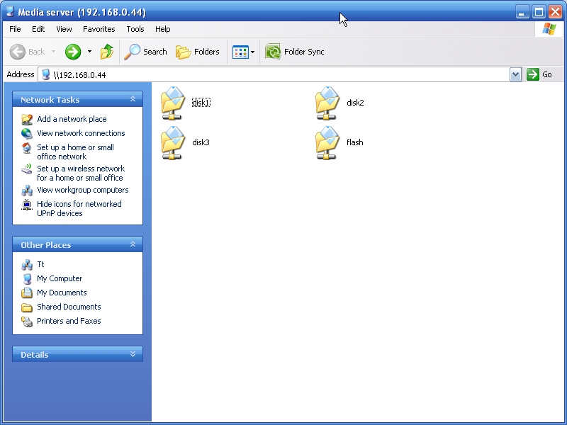

Also, why is it that if I go straight to the ip address I only see 3 HDD? I have 4 HDD in the server. JPG attached. Thanks again!
Thomas
The parity drive is not technically counted as a disk, as it does not store data..
From the image you posted above, you have:
  • 1 parity drive
  • 3 data drives
Hence why you would only see the flash share and disk1,disk2,disk3...
