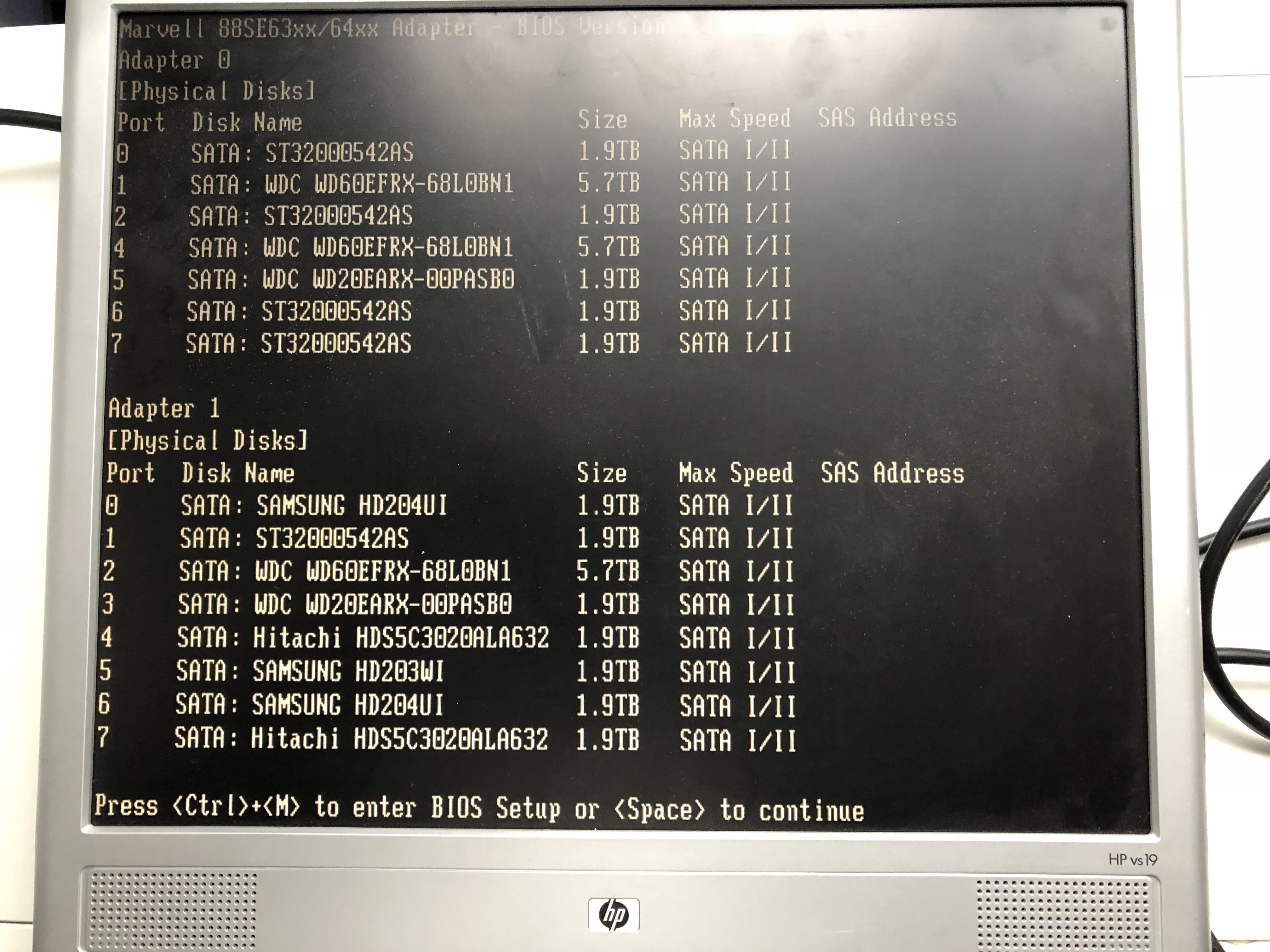

On rebooting, unraid no longer launches. The first issue is a long standing one, there is always a massive delay when restarting as once the disk groups are initialised as part of the server start up, it stops at “Press ctrl-M for setup or press space to continue...”
this is is a minor issue but it’s still annoying!

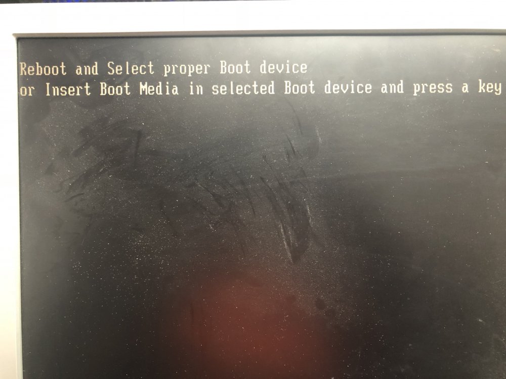

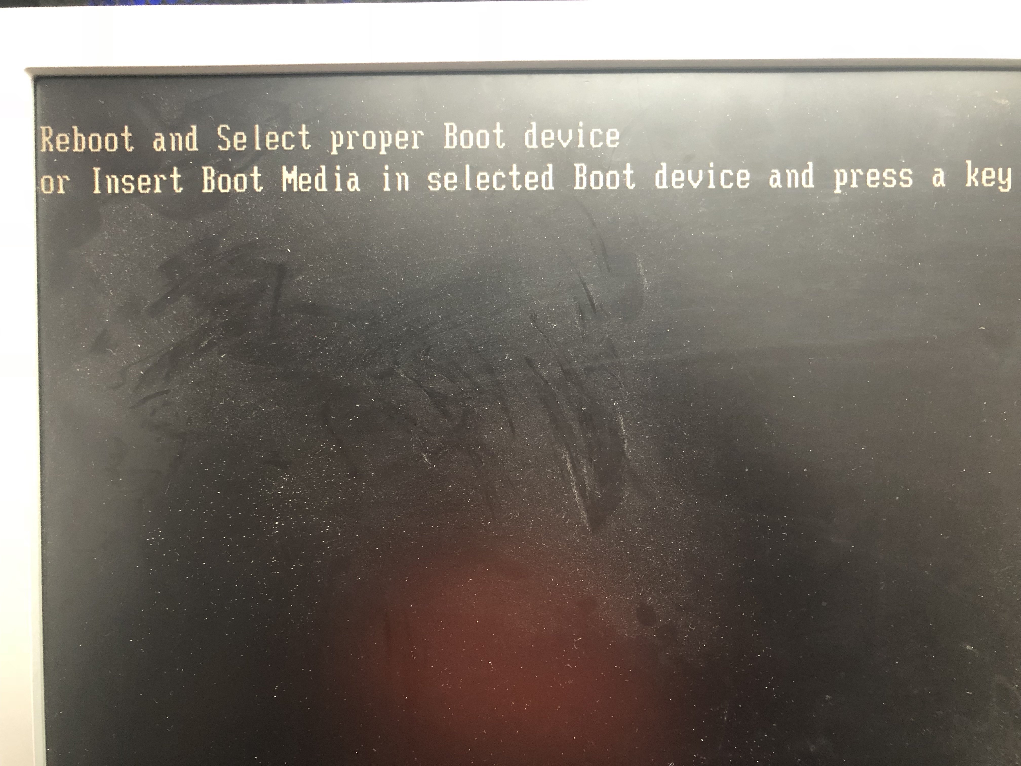

After plugging it back into the server, I now get “reboot and select proper boot device”.
any ideas how to fix both problems? (Obviously the major one being that my array is unusable right now).
Thanks
matt
Flash drive is not bootable, or correct boot device is not selected, if it is redo your flash drive.
