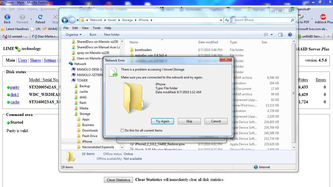

There is a problem accessing \\192.168.0.160\Storage (Or \\Tower\Storage)
Make sure you are connected to the network and try again

I am attaching a screenshot of what it looks like, that comes up and you can hit try again, over and over and over and over until eventually it attempts it again, but it seems like its not finding/recognizing it for some time causing it to error, then when immediately trying again it normally doesnt work, it has to be a little while before resuming.
