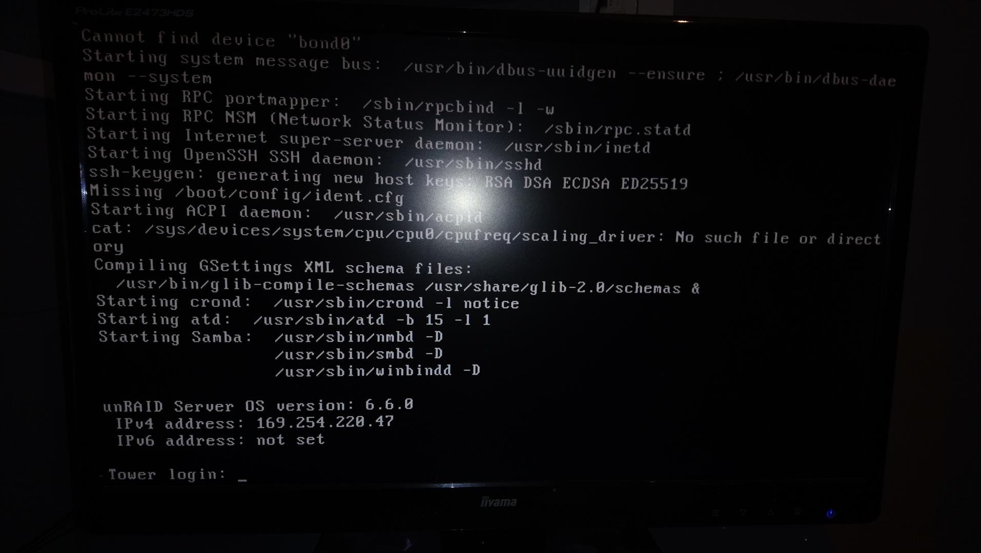

ok so just downloaded unraid 6.6 to usb drive and booted on my server but it cant get an ip from my network it just sets to
ipv4 169.254.220.47 but my network starts with 192.168.0.xx i have tryd the usb drive with unraid on other computers and its the same

There's something wrong with that flash drive or the way it was prepared, try using a different one, also use an USB 2.0 port if possible.
it was the flash drive just used the other usb drive that i had the older ver of unraid on now it works thanks
