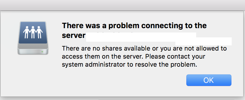

But when I tried to connect to the share files it says
I am not sure if there is something that I do. I tried smb://  and cifs:// nothing works.
Or do I need to add user?

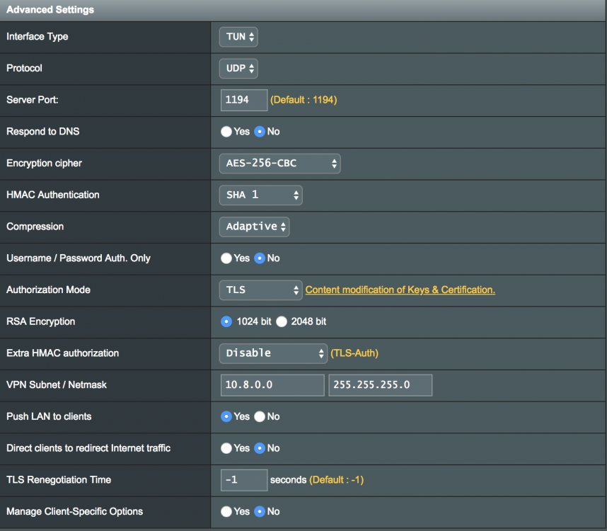

This is my open vpn settings in router, and i have done port forwarding too.

Now I am only able to access with Guest (through afp:// )but not the registered user. (root)
How do I do so that I can access with my root user?
Is there anything I should do?
