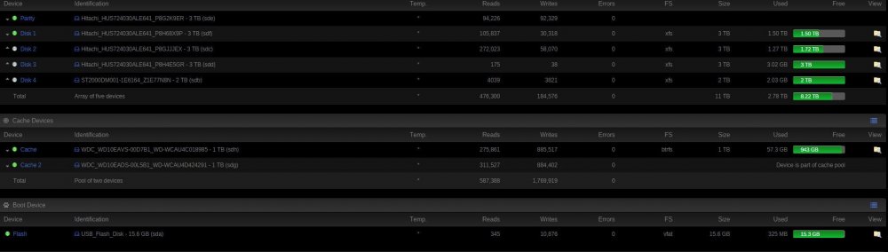

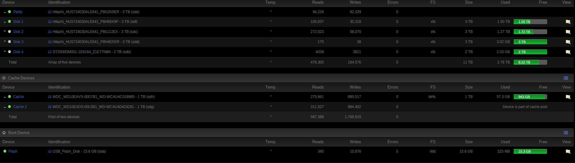

I am not sure where to go next I feel like it may be my cache pool but am very confused

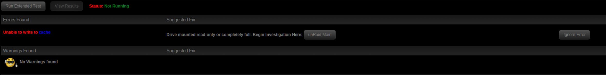

today i received a message from
Fix Common Problems - Server: 23-09-2018 04:31 AM
Errors have been found with your server (Server).
Investigate at Settings / User Utilities / Fix Common Problems
This is what i see on the fix common problems page plugin.thumb.jpg.acc4fa042dbd64102ce01a89a4d972bf.jpg
but when i go to the main page my cache pool looks fine main.thumb.jpg.f45bf60d6439a1de0380f783e7b5c9dc.jpg

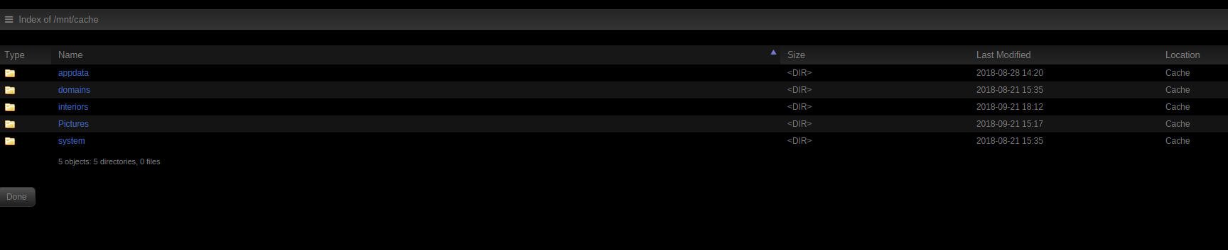

here is a view of cache pool cache.thumb.jpg.cf9474082072251ead3744c93158d773.jpg
