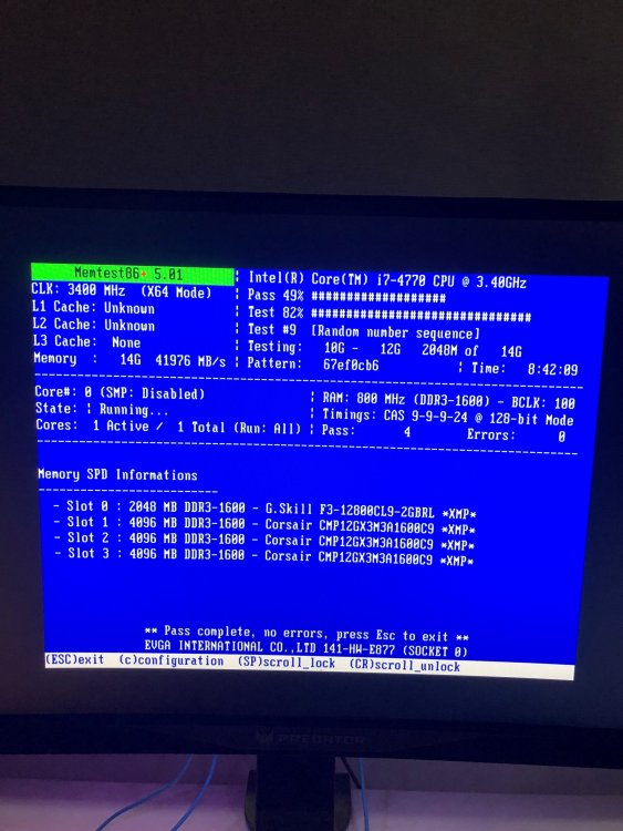

I've run a memtest over the system for 9 hours no issues there, i've now even removed one stick of memory that isn't matched with my other sticks.

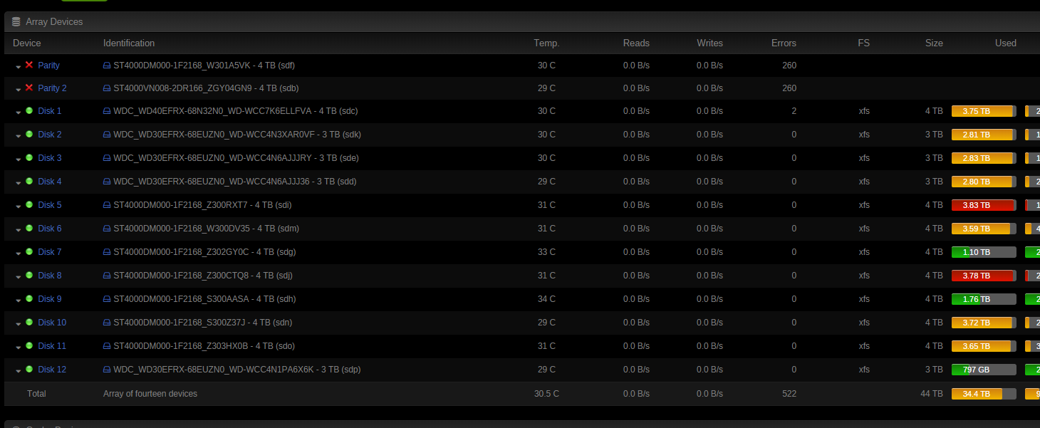

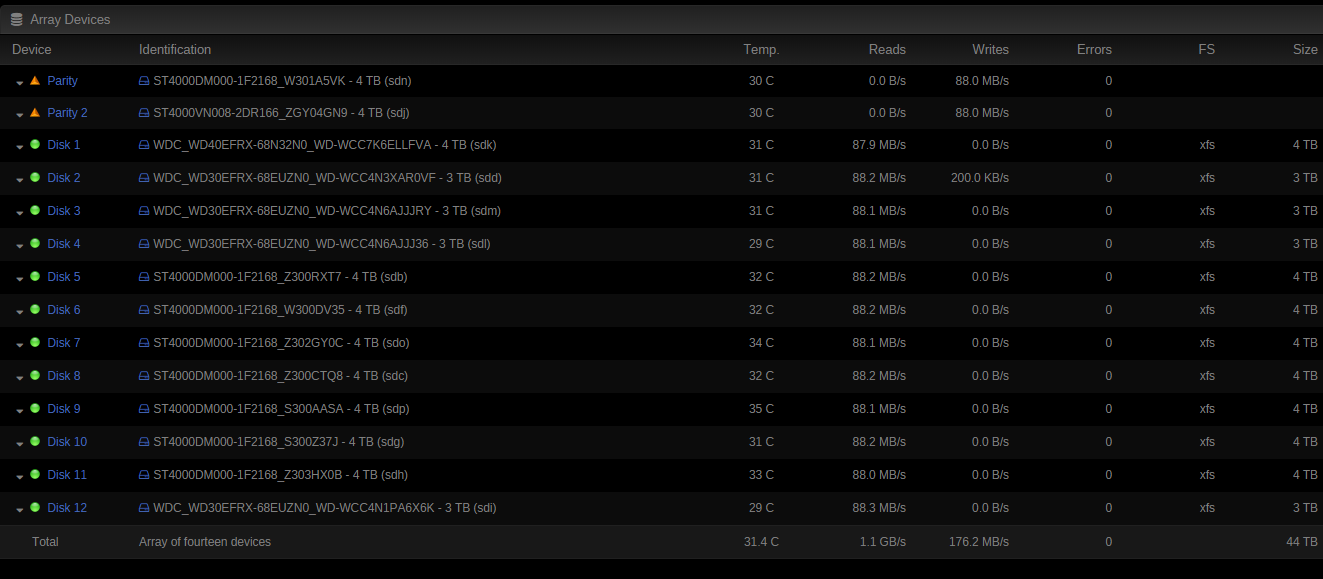

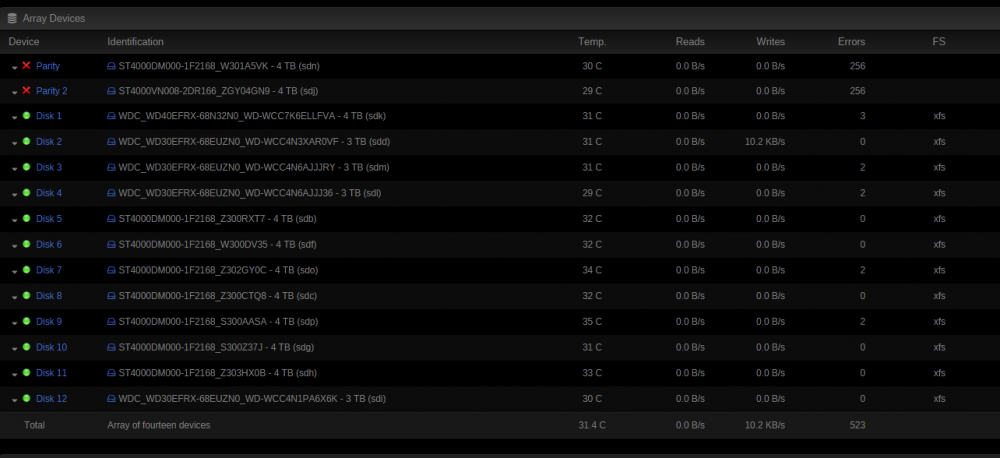

Some question

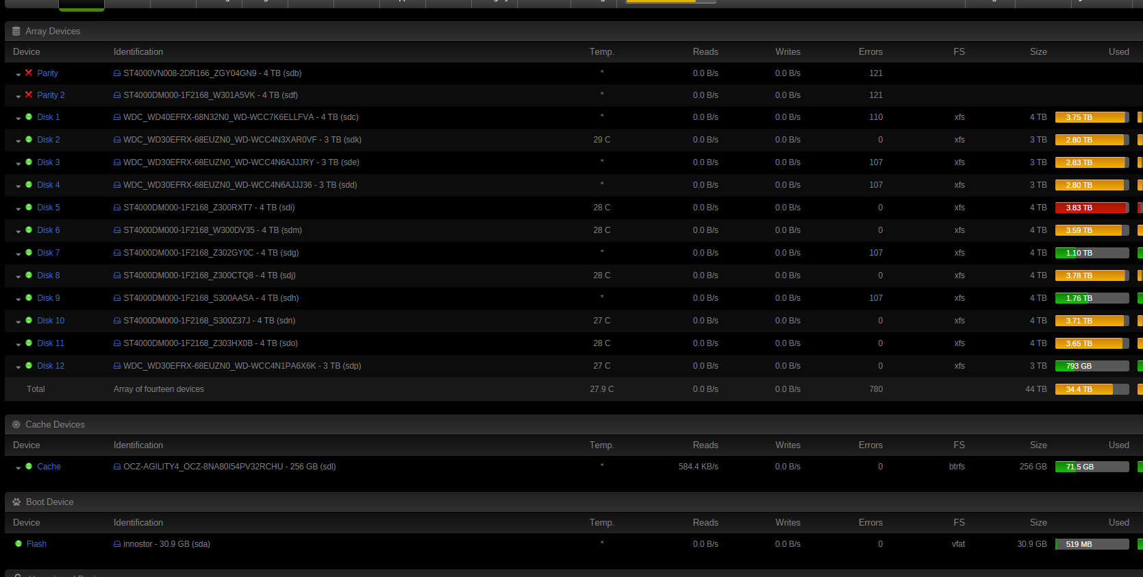

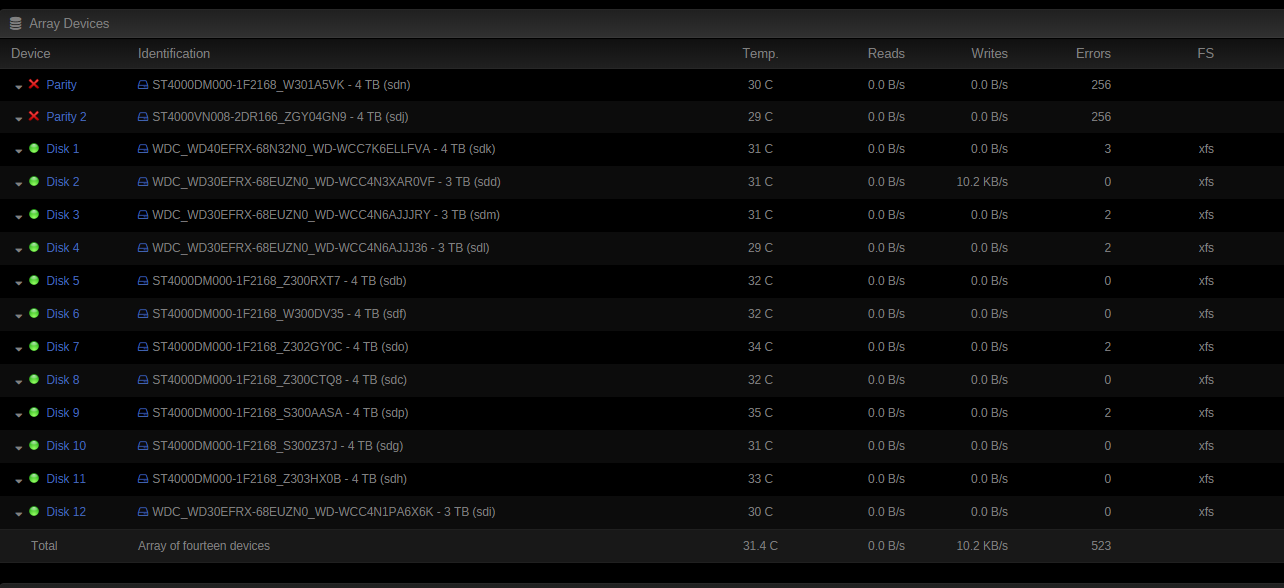

7 error disk under same controller ?
Does those error disk also got SMART error or just parity drop out disk have SMART error change ?
I'm thinking why those 7 disk haven't temperature reading but in green ball.
7 disks this time are on the LSI Card, the 8th one was fine on the LSI Card.
The reboot 2 days ago was Disk 1 and Disk 10 only, Disk 1 is on the LSI Card and Disk 10 is on the onboard controller.
The errors are only ever going to the system as read errors, they never hit the SMART.
After a reboot its like it never happened.
The *'s were because it was just booted up when i screenshoted it takes a few minutes for Unraid to pickup the temps.
There are there now as attached.

Disk 1 is on the on board controller and its erroring with the LSI ones. weidness at its best.
Diags of it are attached.

Hard Drives and CPU is all i use this system for no graphics cards.
FWIW I had a similar problem recently. Tried some hardware configuration changes (didn't have any spare parts), but they didn't help.
Most recently (8 days ago) I installed a new PSU, and I'm still keeping my fingers crossed.
I think that a month without errors will allow a good certainty that the problem is solved.

10 hours ago, Maticks said:
I have touched the HBA heatsink it doesn't feel that hot but who knows maybe it hits a high temp at some point and throws errors.
All my LSI HBA was hot ~70c.
Or you may ref. below case too ( disable disk spindown )
Edited by Benson
I've already disabled all my disks spinning down about 3 months ago.
I was suspect that the power spikes of disks spinning up might cause some issues with how many drives i have.
So that made no difference.
The memory switching didn't make any difference nor did picking different memory slots.

I upgraded to 6.6.1 and the read errors came back but it was a bit different this time.
It never broke the parity disks and it only happened for a little while and it was only 4 disks not like last time.
Truly weird, i've rolled back to 6.5.3 and attached the diag file maybe something in my system is too old for 6.6.1.
vault-diagnostics-20180929-0959.zip
Thats what started it off.
Sep 29 01:50:39 Vault kernel: mpt2sas_cm0: SAS host is non-operational !!!!
### [PREVIOUS LINE REPEATED 5 TIMES] ###
Sep 29 01:50:44 Vault kernel: mpt2sas_cm0: _base_fault_reset_work: Running mpt3sas_dead_ioc thread success !!!!
Sep 29 01:50:44 Vault kernel: sd 7:0:0:0: [sdb] Synchronizing SCSI cache
Sep 29 01:50:44 Vault kernel: sd 7:0:0:0: [sdb] tag#0 UNKNOWN(0x2003) Result: hostbyte=0x01 driverbyte=0x00
Sep 29 01:50:44 Vault kernel: sd 7:0:0:0: [sdb] tag#0 CDB: opcode=0x35 35 00 00 00 00 00 00 00 00 00
Sep 29 01:50:44 Vault kernel: print_req_error: I/O error, dev sdb, sector 0
Sep 29 01:50:44 Vault kernel: sd 7:0:0:0: [sdb] tag#0 CDB: opcode=0x88 88 00 00 00 00 00 5e 99 fe d0 00 00 00 08 00 00
Sep 29 01:50:44 Vault kernel: print_req_error: I/O error, dev sdb, sector 1587150544
Sep 29 01:50:44 Vault kernel: sd 7:0:0:0: [sdb] Synchronize Cache(10) failed: Result: hostbyte=0x01 driverbyte=0x00
Sep 29 01:50:44 Vault kernel: print_req_error: I/O error, dev sdb, sector 1588554072
Sep 29 01:50:44 Vault kernel: print_req_error: I/O error, dev sdb, sector 1588554384
Sep 29 01:50:44 Vault kernel: print_req_error: I/O error, dev sdb, sector 1588554504
Sep 29 01:50:44 Vault kernel: print_req_error: I/O error, dev sdb, sector 1588554560
Sep 29 01:50:44 Vault kernel: print_req_error: I/O error, dev sdb, sector 1588554624
Sep 29 01:50:44 Vault kernel: print_req_error: I/O error, dev sdb, sector 1588554640
Sep 29 01:50:44 Vault kernel: print_req_error: I/O error, dev sdb, sector 1588554744
Sep 29 01:50:44 Vault kernel: print_req_error: I/O error, dev sdb, sector 1588554808
Sep 29 01:50:44 Vault kernel: sd 7:0:4:0: [sdf] tag#0 UNKNOWN(0x2003) Result: hostbyte=0x01 driverbyte=0x00
Sep 29 01:50:44 Vault kernel: sd 7:0:4:0: [sdf] tag#0 CDB: opcode=0x35 35 00 00 00 00 00 00 00 00 00
Sep 29 01:50:44 Vault kernel: sd 7:0:4:0: [sdf] tag#0 CDB: opcode=0x88 88 00 00 00 00 00 5e 99 fe d0 00 00 00 08 00 00
Sep 29 01:50:44 Vault kernel: sd 7:0:4:0: [sdf] tag#0 CDB: opcode=0x88 88 00 00 00 00 00 5e b0 18 a0 00 00 00 10 00 00
Sep 29 01:50:44 Vault kernel: sd 7:0:4:0: [sdf] tag#0 CDB: opcode=0x88 88 00 00 00 00 00 5e b0 19 10 00 00 00 08 00 00
Sep 29 01:50:44 Vault kernel: sd 7:0:4:0: [sdf] tag#0 CDB: opcode=0x88 88 00 00 00 00 00 5e b0 19 40 00 00 00 08 00 00
Sep 29 01:50:44 Vault kernel: sd 7:0:4:0: [sdf] tag#0 CDB: opcode=0x88 88 00 00 00 00 00 5e b0 19 78 00 00 00 08 00 00
Sep 29 01:50:44 Vault kernel: sd 7:0:4:0: [sdf] tag#0 CDB: opcode=0x88 88 00 00 00 00 00 5e b0 1b 70 00 00 00 08 00 00
Sep 29 01:50:44 Vault kernel: sd 7:0:4:0: [sdf] tag#0 CDB: opcode=0x88 88 00 00 00 00 00 5e b0 1b 88 00 00 00 08 00 00
Sep 29 01:50:44 Vault kernel: mpt2sas_cm0: removing handle(0x000c), sas_addr(0x4433221103000000)
Sep 29 01:50:44 Vault kernel: mpt2sas_cm0: enclosure logical id(0x500605b003cc0de0), slot(0)
Sep 29 01:50:44 Vault kernel: sd 7:0:1:0: [sdc] Synchronizing SCSI cache
