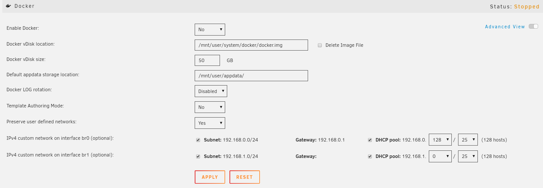

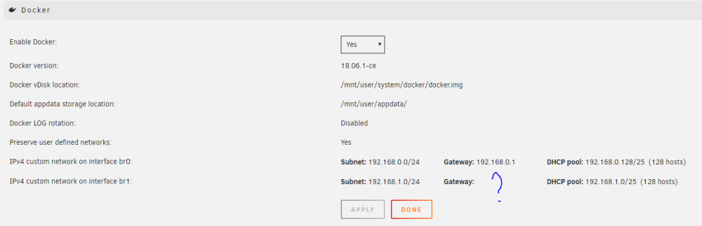

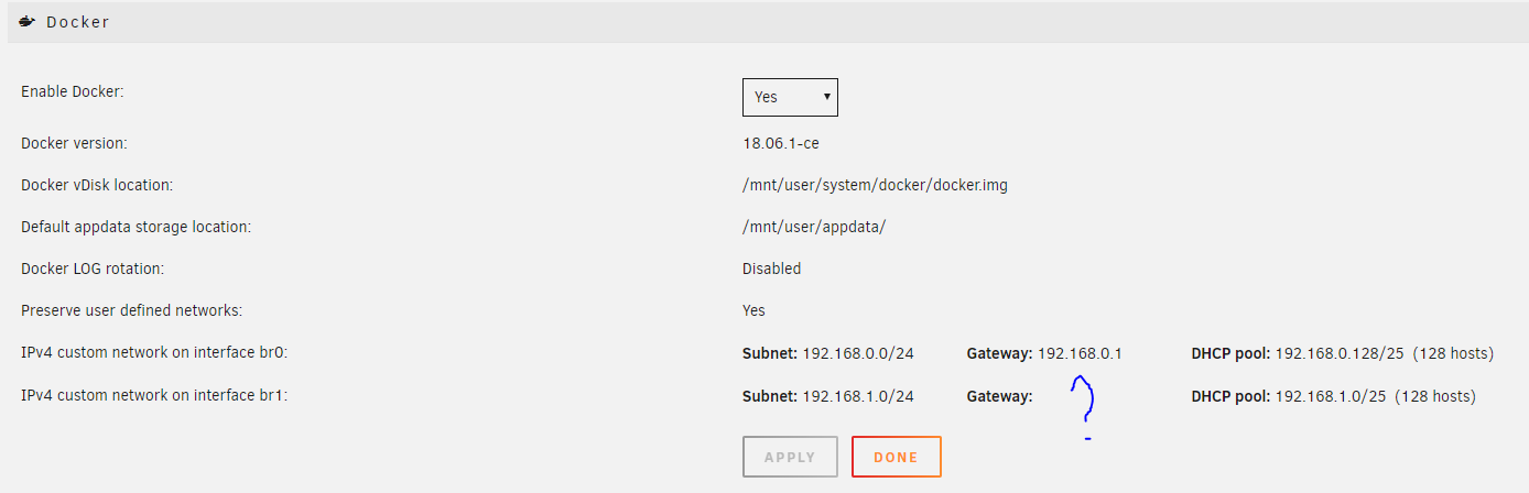

September 25, 20188 yr Author Under my docker settings, I see docker automatically two bridge network based on two NIC eth0 and eth1 which is labelled br0 and br1. Since eth0 is tied to br0 it received and shows its gateway value which is the lan ip of my router. eth0 is tied to br1 which shows and empty gateway? Can this be the reason that the WAN that is tied to eth1 cannot get its connection routed? Is there a way I can force docker to also identify the gateway for the second NIC (br1)
September 25, 20188 yr The missing gateway will definitely have an effect on the docker network not being able to use WAN2, Unraid itself would be unable to reach the WAN2 using router2, as it only knows about WAN1 Disable the docker service (Enable Docker: No) above to be able to edit the information for br1 Since you have a merged network now (routed and firewalled by pfsense) it might be better to delegate all the load balancing to it.

September 26, 20188 yr Author Yes all my dockers are on default bridge mode. Below is the result of docker network inspect br0 and br1: If you see only br0 has gateway value, br1 does not. So that is the reason why when I swap the WAN2 to eth0, it works because it then gets its gateway configured properly. BR0 { "Name": "br0", "Id": "a4e2c0c0fd4fbd13efb5397fcbf036e8e593c6d7e595dafb3f4fc7e57b6daa10", "Created": "2018-09-26T08:38:16.557359047+08:00", "Scope": "local", "Driver": "macvlan", "EnableIPv6": false, "IPAM": { "Driver": "default", "Options": {}, "Config": [ { "Subnet": "192.168.0.0/24", "IPRange": "192.168.0.0/25", "Gateway": "192.168.0.1", "AuxiliaryAddresses": { "server": "192.168.0.111" } } ] }, "Internal": false, "Attachable": false, "Ingress": false, "ConfigFrom": { "Network": "" }, "ConfigOnly": false, "Containers": {}, "Options": { "parent": "br0" }, "Labels": {} } BR1 { "Name": "br1", "Id": "d3a6bb0dc39b8c1e72eea65848a270a88cdc795e3466801bf276992a2edd7ead", "Created": "2018-09-26T08:38:16.834005583+08:00", "Scope": "local", "Driver": "macvlan", "EnableIPv6": false, "IPAM": { "Driver": "default", "Options": {}, "Config": [ { "Subnet": "192.168.1.0/24", "IPRange": "192.168.1.0/25", "AuxiliaryAddresses": { "server": "192.168.1.110" } } ] }, "Internal": false, "Attachable": false, "Ingress": false, "ConfigFrom": { "Network": "" }, "ConfigOnly": false, "Containers": {}, "Options": { "parent": "br1" }, "Labels": {} } ]
September 26, 20188 yr 6 hours ago, ken-ji said: Feels like a bug @bonienl Is this a bug? No, not a bug. When an interface is given an IP address, all fields are automatically filled in based on the network settings of the interface. To make Docker fields editable the interface must be set to NONE as IP address.
September 26, 20188 yr Author But even if it's fetching the ip automatically, why is my gateway address for eth1 is not populated? For your second line, how do I set NONE as ip address?

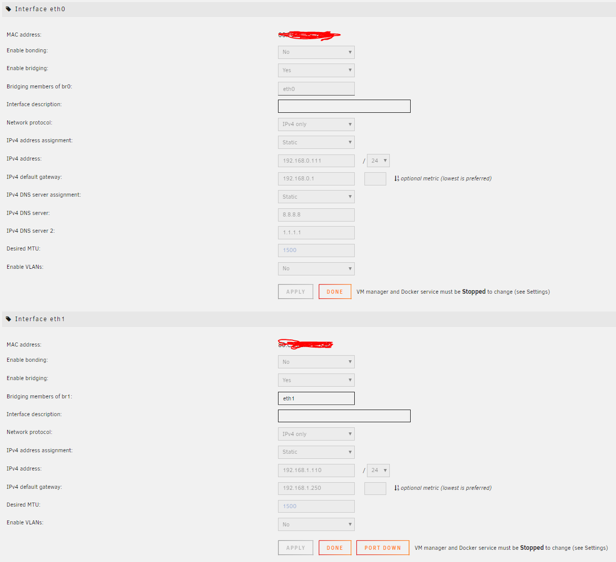

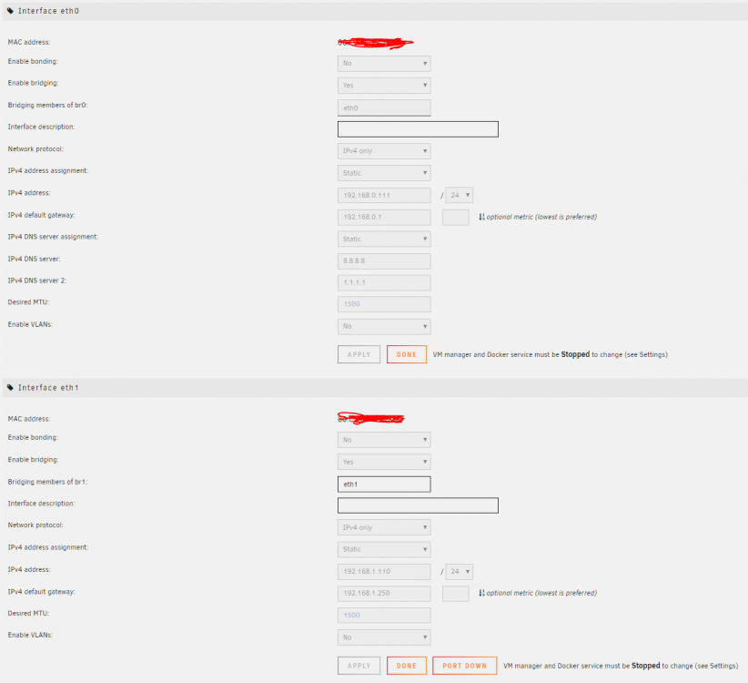

September 26, 20188 yr Just now, hus2020 said: But even if it's fetching the ip automatically, why is my gateway address for eth1 is not populated? When DHCP is used it is your DHCP server which must announce the gateway address in order to populate it. 1 minute ago, hus2020 said: For your second line, how do I set NONE as ip address? Stop docker and vm services, then go to Settings -> Network settings Change "IPv4 address assignment" for eth1 (br1) to NONE You can now edit under Docker settings the IP assignments for br1
September 26, 20188 yr Author I did it everything accordingly. Setting my second NIC to none allowed me adjust the setting in docker. I believe in this way, the second nic is not used by unraid and becomes exclusive for docker engine. However, my custom domain2 is still not reachable to my dockers. The forwarding only work when the subnet is set to eth0.
