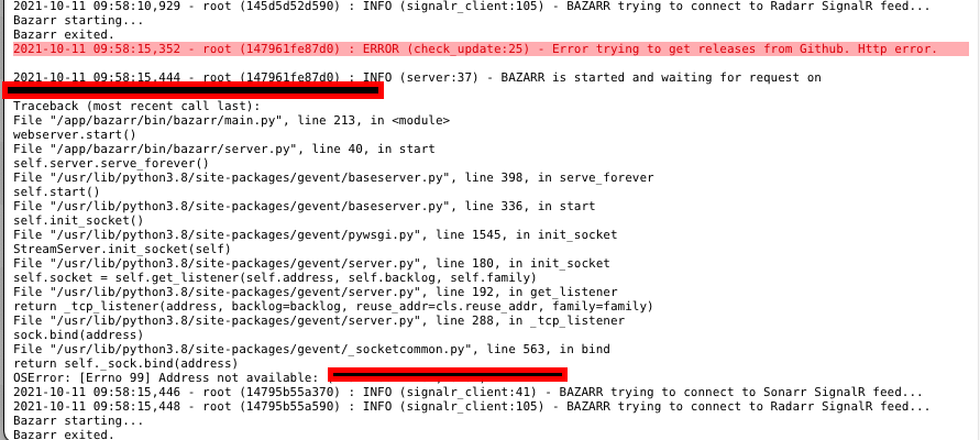

  • I fixed my issue by going into the config.ini and changing the IP address from 192.168.1.29 to 0.0.0.0

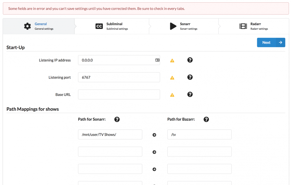

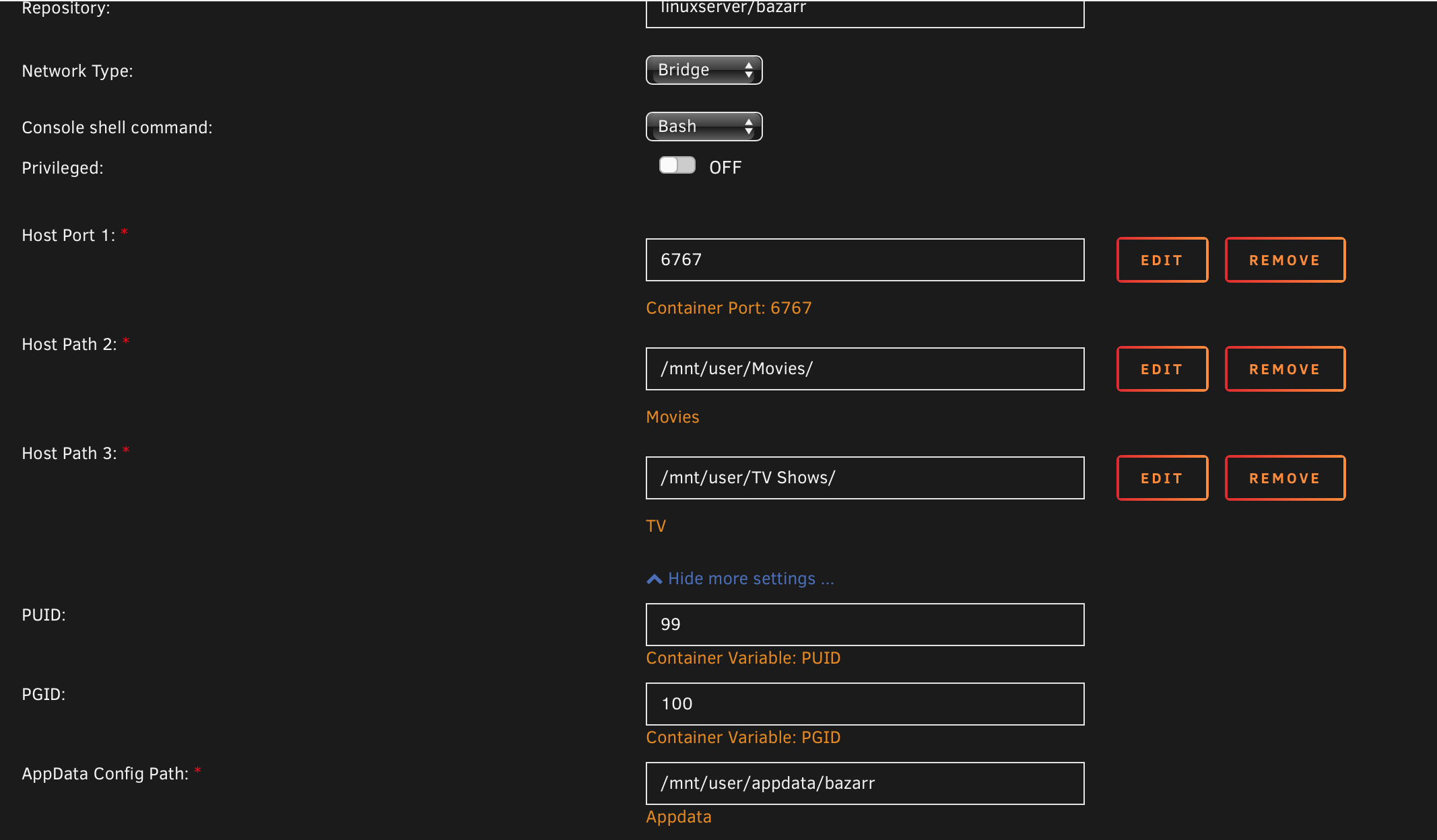

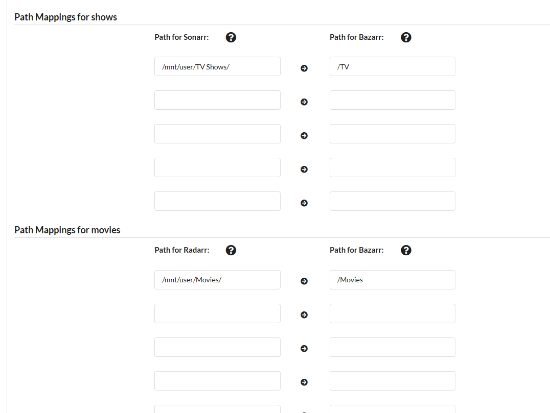

I'm having some problems with the Path Mappings that I cant seem to be able to figure out.
I had this working with the dockerhub-version but when I changed my cache-drive something screwed it up so I decided to reinstall using the CA-template but I'm obviously doing something wrong since I keep getting "This path does not seem to be valid" on everything in Bazarr.
This is my current settings: https://imgur.com/gallery/fj2vis2
I think this is how I used to have it but I could very well be wrong, I tried a couple of different variations but no luck.

You have to point the Path Mappings for Sonarr and Radarr to the same path as configured in the container's options!
Therefore replace "/media" to "/mnt/user/Movies" for Radarr and "mnt/user/TV Shows" for Sonarr.
Edited by InVisibleGoD
I tried that and it still says "This path doesn't seem to be valid" on all the files in the Series and Movies tab, any ideas?
Edited by XenapZ
I wonder if the space in "TV Shows" makes the path invalid...
I don't think it should, since I have had this working with the same shares before.
And besides, I get the same error on the movies-tab.

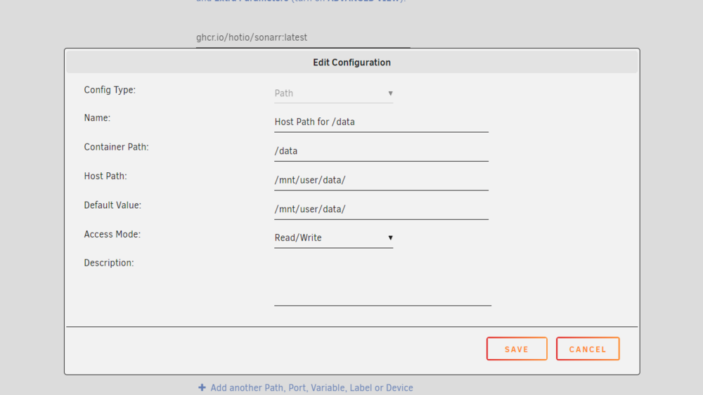

Your paths are wrong. The easiest way to fix this is A) Find the correct paths and B) Delete the Bazaar container & it's appdata folder and start again (I discovered that in some cases, changing to the correct path doesn't always work if it's already logged the wrong one and it was easy to just start over).
Step 1) In the Bazarr container note Host Path 2 and 3. You'll link 2 to wherever your movies are, like /mnt/media/movies and 3 to tv, like /mnt/media/tv. Note these are *not the paths you use in the applications!* Like all containers, this just maps to an internal container path. *That's* what you use.
For the Unraid Bazarr container Movies are mapped to /movies and TV mapped to /tv. Note the case! It is case-sensitive. Inside the container itself that is where Bazarr sees the content. You can easily test this by opening up a console shell for the container and cd'ing to /movies and /tv - if you mapped this correctly you'll see a list of your respective files in each.
Step 2) You need to use the same *container* path for Sonarr/Radarr - the ones those containers are using. For example, Binhex-Sonarr/Radarr maps your directories to /media for those containers. So /mnt/media/movies (if that is your actual Unraid path) is mapped to /media inside the Radarr container, and so on.
Step 3) Use the respective container path mappings in Bazarr. In the above example, you'd use /media for both the Sonarr and Radarr path (left side) and /movies for Radarr /tv for Sonarr for the Bazarr mapping (right side).
Obviously you need to use the actual paths you are using. Quickest sanity check is just to open a console shell for all 3 containers and cd/ls each container path. That will insure you are using the right ones.
This probably seems obvious but I know sometimes container paths, especially when using containers from different sources, can get confusing, and the Bazarr instructions are somewhat unclear at the moment.
Last tip: After you get it working and Bazarr correctly scans all your shows/movies (it can take a bit) you can mass-edit the list and choose the languages, or language, you want to apply to them. Then do a sync (or wait for it to kick off on it's own, it's scheduled) and it'll be able to show you what you have and what's missing.
I have this working and downloading subs for my movies and tv shows. It is quite handy, actually. Plex users can use the SubZero plugin but Emby users like myself have been stuck with the built-in Opensubtitles support which is pretty lacking. Bazarr lets you use more providers by leveraging Subliminal, which is what SubZero leverages as well and is one of the better, if not best, subtitle matching apps around.

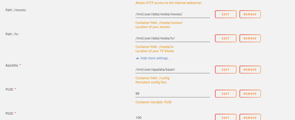

Thank you for your detailed answer.
It appears I initially thought right in using the specified host paths but the template showed them wrong.
When I bashed in as you suggested I saw that TV is actually tv and Movies is actually movies.
Maybe the template should be updated so others don't make the same mistake?
Got it working now anyway, thanks for your help!

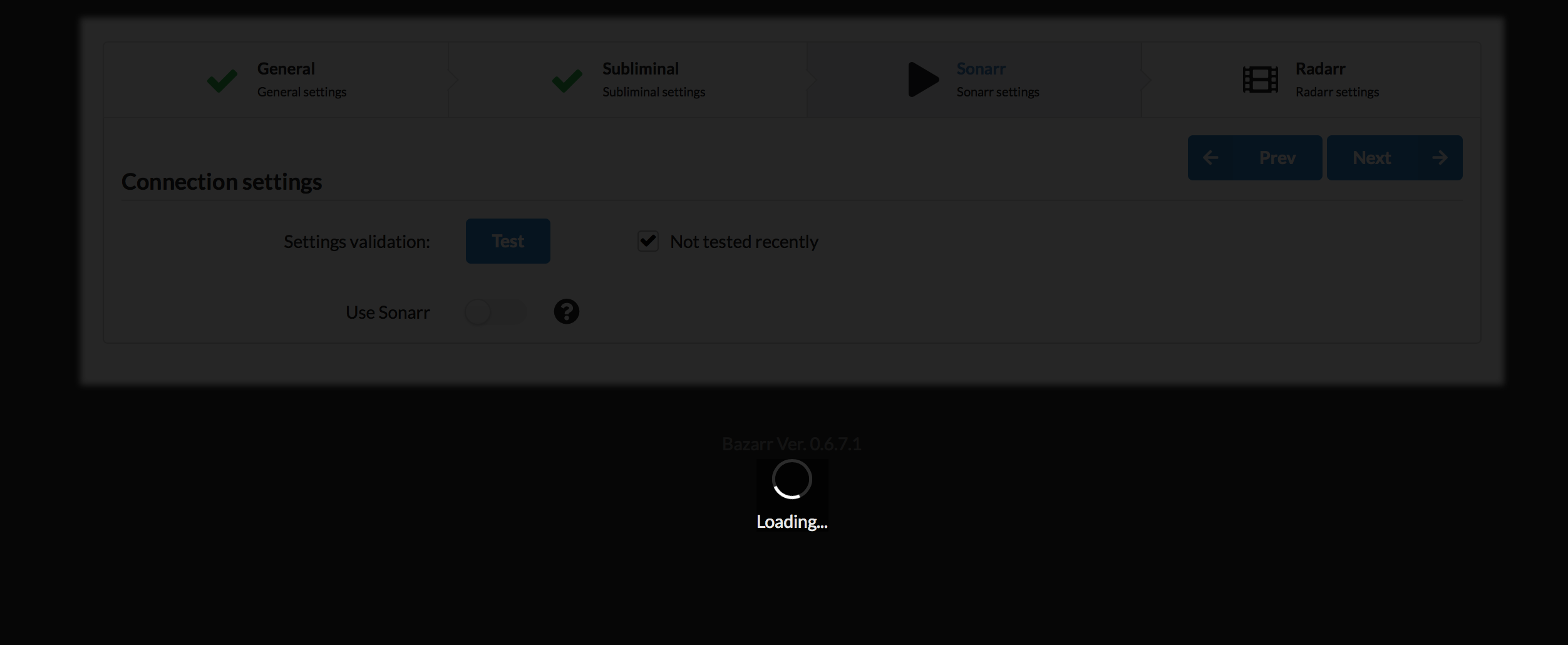

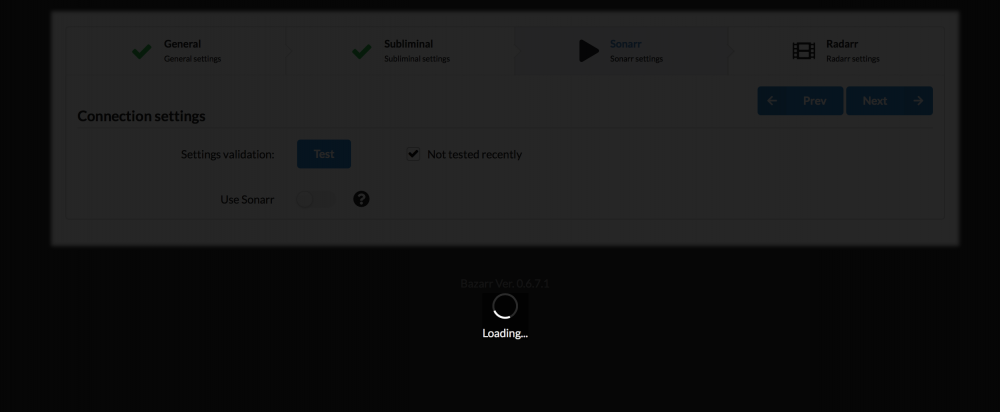

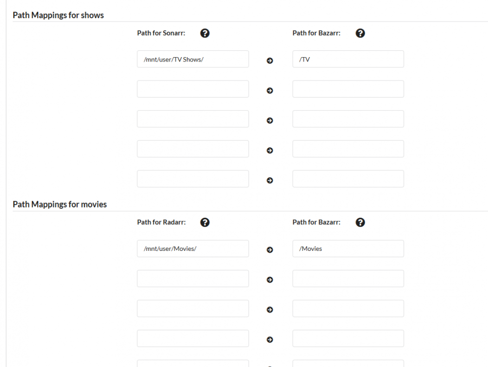

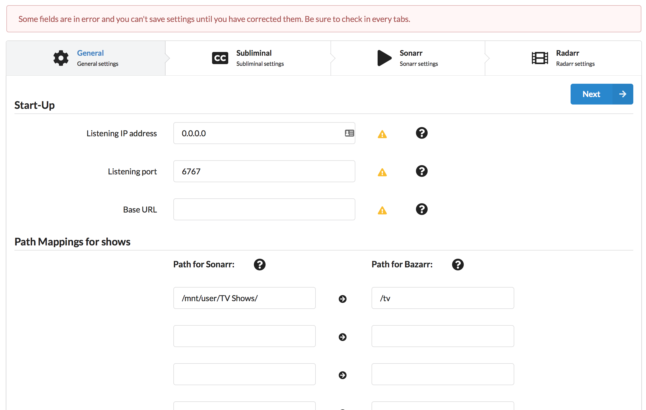

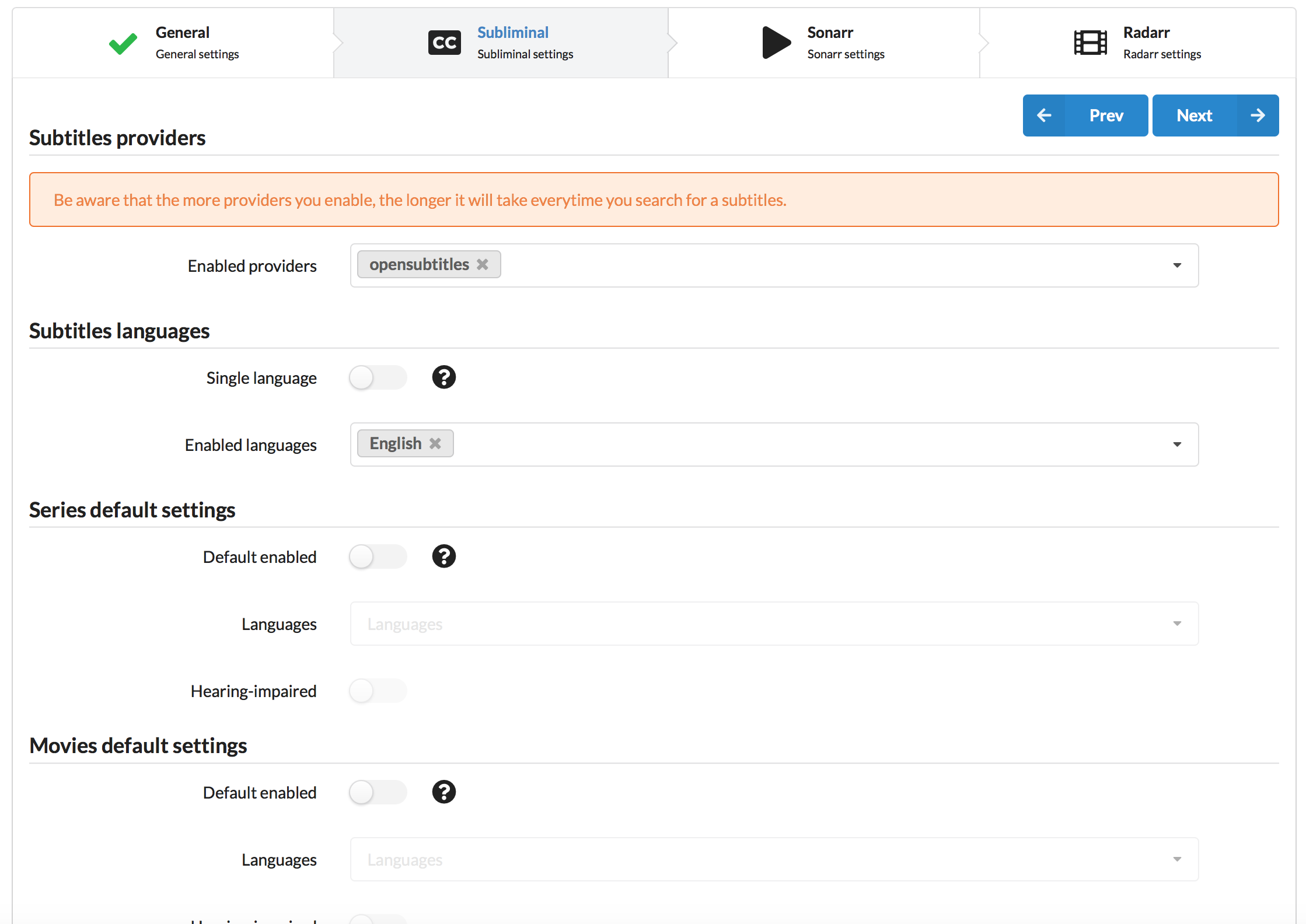

I am having some trouble getting this to work properly. I read the preceding posts about paths and feel sure that I have them correct. My problem is that when I have done the general settings page in the UI as well as the Subliminal page, I am left with a "Loading page" that just seems to be stuck.
Note that I am not using Radarr which is why there are no entries for that in the UI, but only in the docker template (as I didn't want it to throw an error if it was missing.
I have attached screenshots and would appreciate if someone who has it working could point out where I went wrong ;-)
Thanks in advance!
Edited by t33j4y

I did notice on the last screenshot you don't have Sonarr enabled (use Sonarr). I doubt that's causing the issue though. Additionally, one of your paths in the screenshot for Sonarr doesn't have a "/" at the end. Believe it or not, I've had programs break before because of that (sloppy programming IMHO). That might be an issue here.
Edit: I'm pretty sure that's it because I removed the trailing slash from one of my paths and now it's freaking out about invalid paths and instead of /movies/movie_name it's showing /moviemovie_name. I'll submit a bug on the project page. Again, sloppy programming. Add a trailing slash and that should fix it.
Edited by bobbintb
Thanks - nice to hear from others who also have problems getting this to work - one starts to think he is the only one who can't get it working when there are no responses 🙂
Anyway, I've fixed the trailing slash which unfortunately didn't fix anything 😕 Regarding the enabling of Sonarr, that is unfortunately part of the next setup page in the WebGUI which I can't access (it is greyed out in the background while it loads)
So I'm still stuck 😞
Btw, the template also didn't suggest bridge or host for network mode for me, so I manually chose bridge.

hi, I tried starting the container for the first time yesterday, and I keep getting this error
RROR:root:Error trying to get releases from Github. Connection Error.
File "/app/bazarr/bazarr/check_update.py", line 54, in check_releases
r = requests.get(url_releases, timeout=15)
File "/app/bazarr/bazarr/../libs/requests/api.py", line 72, in get
return request('get', url, params=params, **kwargs)
File "/app/bazarr/bazarr/../libs/requests/api.py", line 58, in request
return session.request(method=method, url=url, **kwargs)
File "/app/bazarr/bazarr/../libs/requests/sessions.py", line 512, in request
resp = self.send(prep, **send_kwargs)
File "/app/bazarr/bazarr/../libs/requests/sessions.py", line 622, in send
r = adapter.send(request, **kwargs)
File "/app/bazarr/bazarr/../libs/requests/adapters.py", line 513, in send
raise ConnectionError(e, request=request)
ConnectionError: HTTPSConnectionPool(host='api.github.com', port=443): Max retries exceeded with url: /repos/morpheus65535/Bazarr/releases (Caused by NewConnectionError('<urllib3.connection.VerifiedHTTPSConnection object at 0x14df434f3990>: Failed to establish a new connection: [Errno -3] Try again',))
Today it doesn't start either with same error
