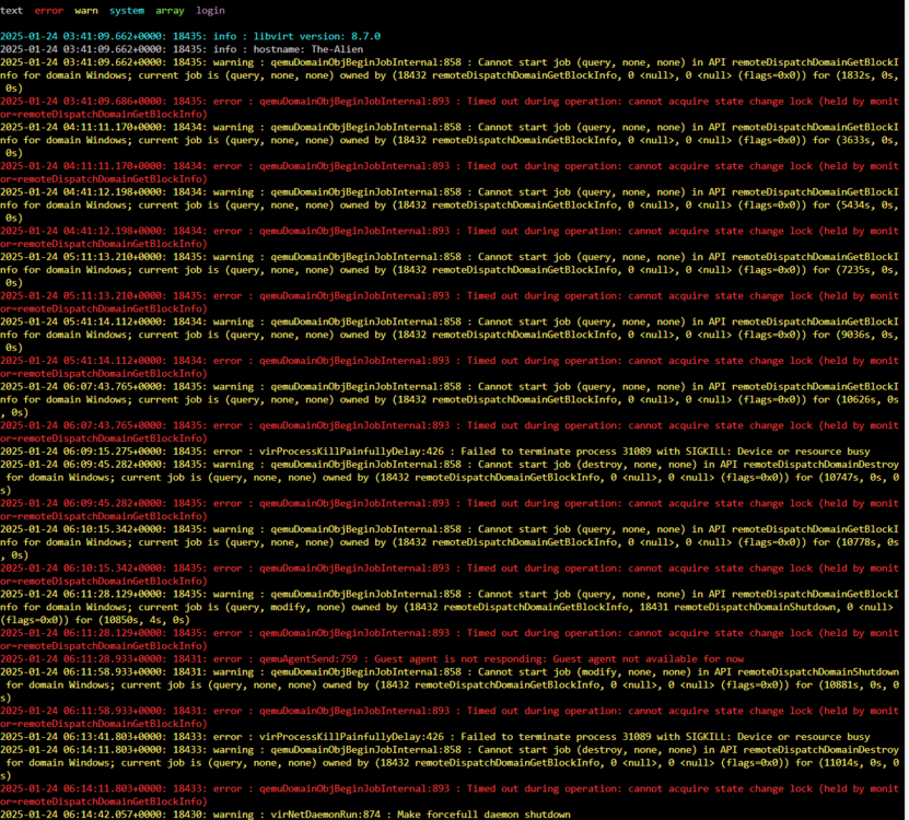

Hello, I know that this thread is a bit old but I didn't want to create a new one.
I have similar problem, doesn't even try to create a libvirt.img file and the path in Settings->VM-Manager-> is  /mnt/user/system/libvirt/libvirt.img
I cannot see anything in syslog when I enable or disable the VMs
