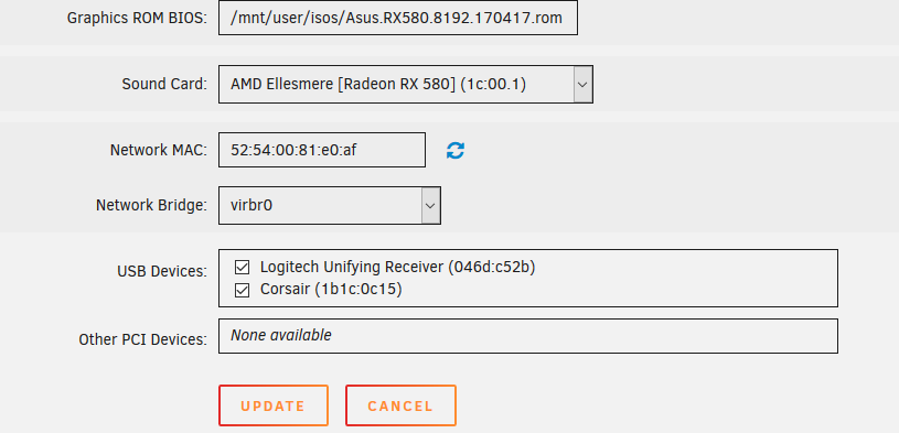

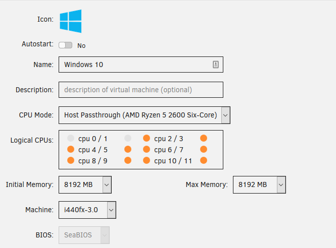

I have been having issues with getting a windows 10 vm going stable.
image.png.2f9f83fc764b6f3ba2f88943b1c5ad00.pngimage.png.988a9a2ff96725655b6e6f8216625a2d.png
I originally thought that I was having an issue with the GPU, but the more I look at the IOMMU list, it appears to be sata controller and USB????
Suggestions would be appreciated... thanks in advance..

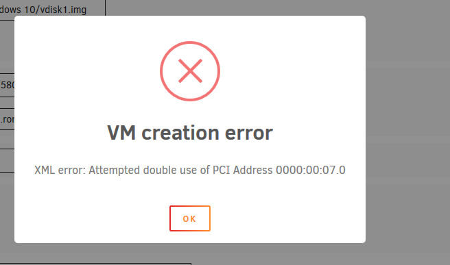

added error message
There's a few things I'd suggest.
To check what might be causing this on the command line try:
lspci
This command should show you all the addresses in use for the pci bus - it'll probably reference the 'problem' one as 00:07.0 or similar.
To initially get this running, I'd probably turn off the two usb devices for now, get everything installed, working and stable, then turn them back on one at a time if necessary. It might even be as simple as moving one of those devices to a different usb port on your machine.

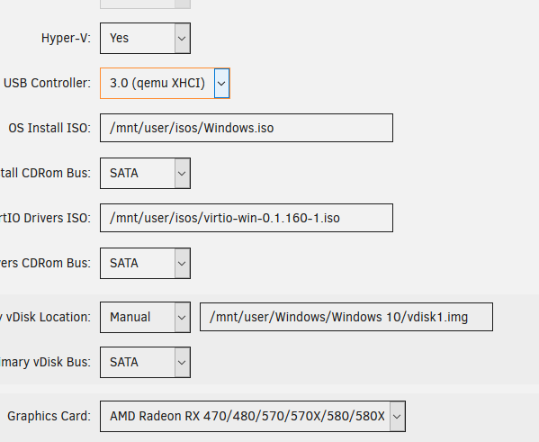

Eventually you're going to want that primary vdisk to show as using the virtio setting but that's just a matter of how you install the drivers in Windows (you'll typically have to do it before it even sees the disks - but that's a story for a Windows 10 install post.)
I think some people will point you towards using an UEFI bios setting - I probably would too except I run my Win10 guests using settings similar to yours and being inclined to laziness have never bothered to switch them. They run perfectly well for my use cases.
Another thing is the network setting, depending on how you've set things up virtbr0 might not be the network you need - if it seems like you're only getting an internal/server address without external access - try switching that to br0 if possible. There's many things to consider.

Another thing regarding the instability - I had this initially too - specifically that at idle my Win10 vm's would use 50-70% cpu on the host which under load caused some freezing. I found some information on these forums which might be helpful and has helped some others:
Some people reported the hpet item was what fixed some of the instability for them.
