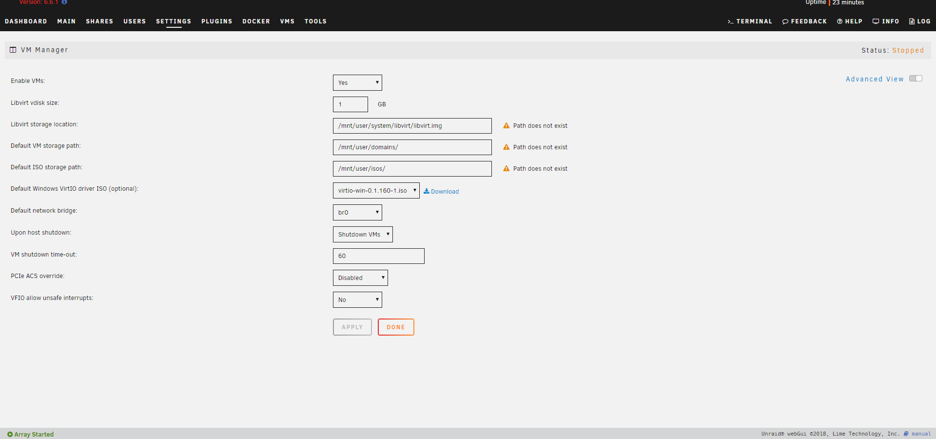

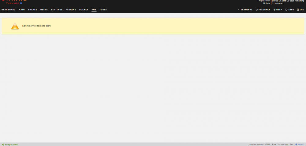

I'm using an windows host with an unraid virtual machine in vmware. When I go to the VM's page and I get this first error. Libvirt service failed to start. So I went to the VM settings and get my second error. I get similar errors in the docker section as well. How do I fix this image.thumb.png.051a160c258cae27c11dfd85d61de231.pngimage.thumb.png.454dd7386f20df206d4c8a4cf8707c25.png

You don't have anything for those paths to exist on. You seem to have unformatted flash drives assigned as disks 1 and 2, no other data drives, no cache drive. Also no parity but you do have a (2.5") parity2. O.o
So you really haven't setup any storage that Unraid can use for VMs and dockers.
