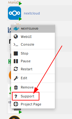

This really should be in the Nextcloud support thread rather than general Unraid support.
Sent from my Mi A1 using Tapatalk
Yes it should... BUT, I can not ask a question there ...   just respond to topics already existing......
Edited by Anne
spelling
That's why there is a dedicated support thread already created for each container.
I already looked through the thread for NextCloud and found nothing related to my question.. Did I miss something ??
Yes, you ask your question in the thread. You can't create new posts, but you can respond to existing ones.
Nothing is stopping you from asking the question in the support thread.

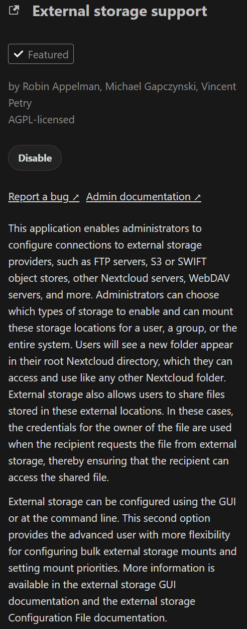

@Chrysen Thanks for this info! This was already installed in the latest version of NextCloud. I just had to enable it.

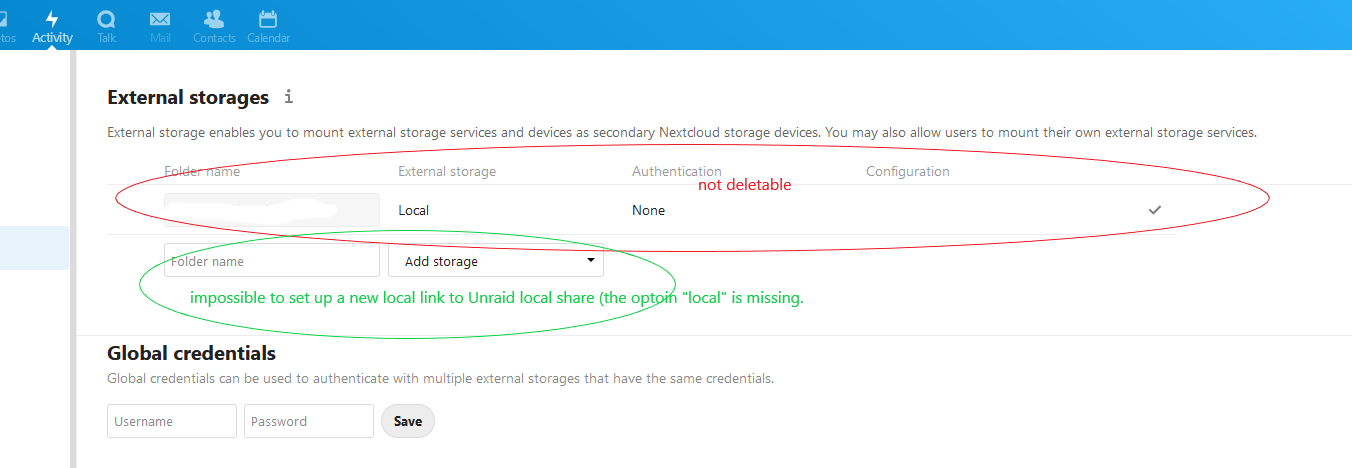

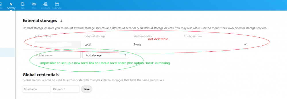

Hi there,
After a failed attempt to link nc to an internal unraid share, i cannot delete the old entry and neither set up a new. Any suggestions? Thanks in advance.
