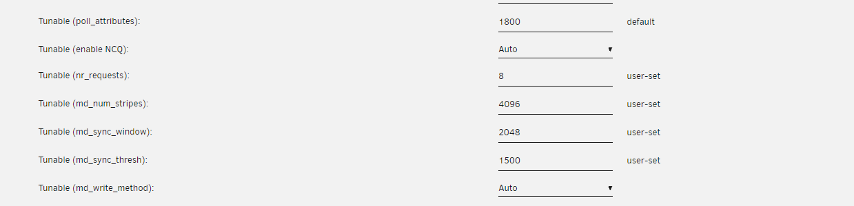

Apparently mine were adjusted at some point in the past as they indicate they are user set rather than the default... Screenshot_20181205-075532.thumb.png.7cb3ba3ca3d2fac5776a543b2da98b24.png
Yes, those are the tunables I recommend and they generally perform better than defaults, and up till recently there were no call traces with them, but for a few releases a few users start getting some, and usually just lowering the sync_thresh tunable is enough to get rid of them, start lowering it little by little and stop when there are no more traces, you can change the value during a parity check.

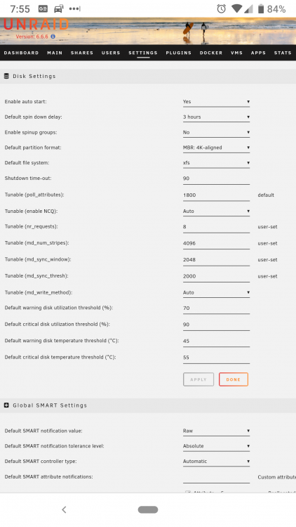

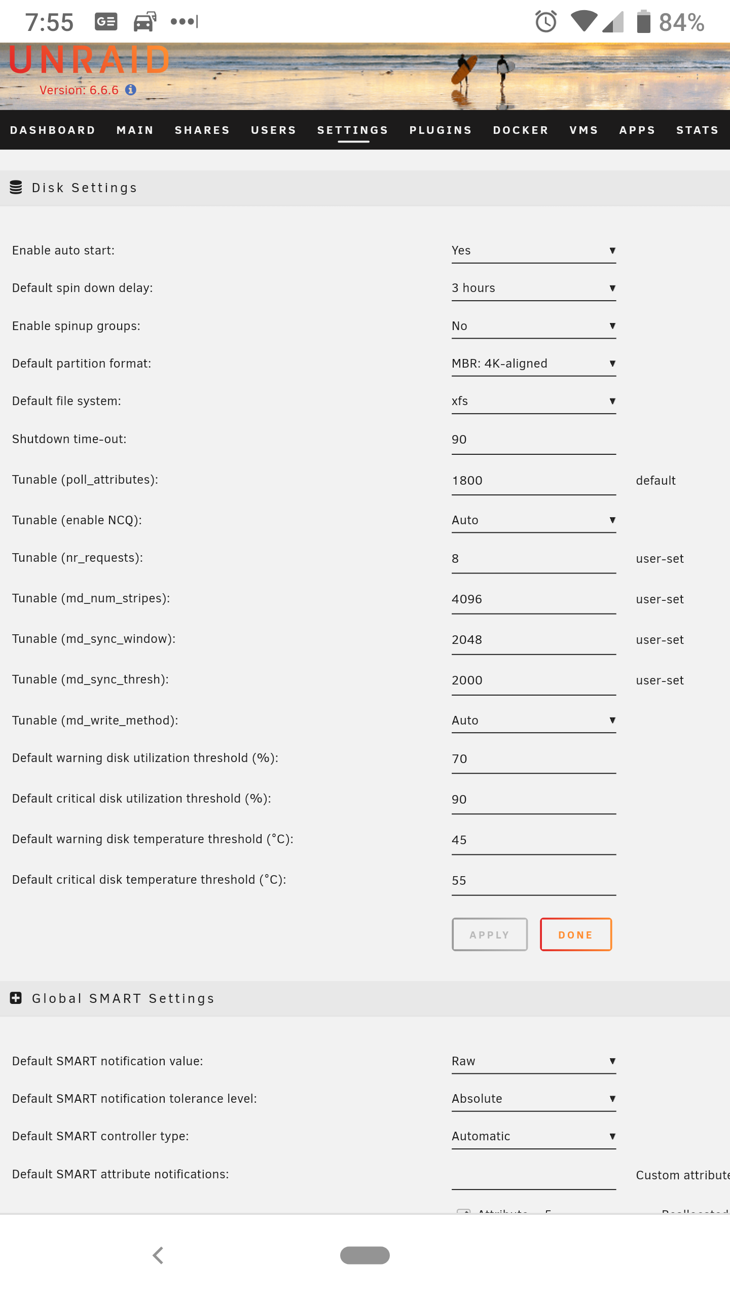

Adjusted the sync_thresh down 20 and so far 25% done and no call traces yet.

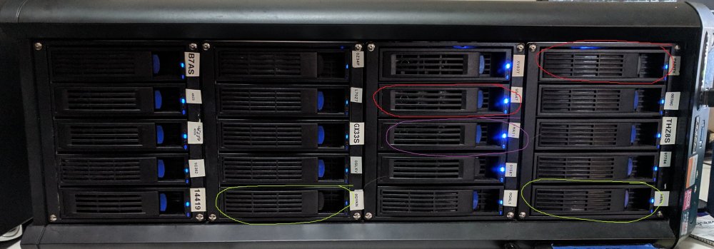

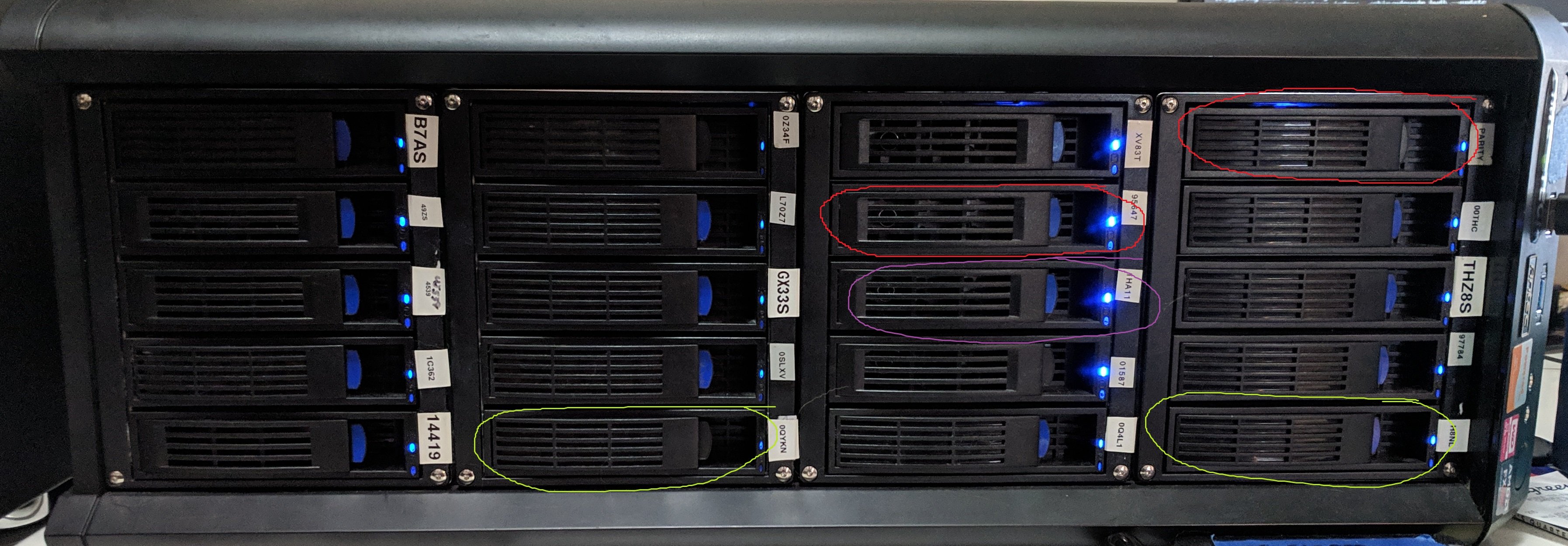

I can't be 100% sure as the cabling runs behind the case wall for this drive and I would have to pick up and flip the entire server to get back there, but I believe it is hooked up directly to my motherboard SATA controller. void-diagnostics-20181210-0758.zip
EDIT: To illustrate what has been swapped where so far I took a pic of the server and made some colored circles. Red was swapped with red, green with green, and purple is my latest troublemaker in this post.
Edited by weirdcrap
It is, you'll need to start swapping some things around to rule them out, cables, PSU, backplanes, etc.

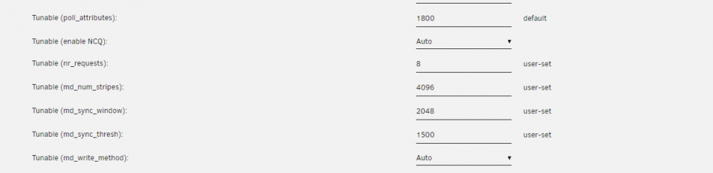

I am still receiving call traces though, do I still need to crank sync threshold down more?
Current tunables:
void-syslog-20181214-0539.zip
Yes, keep lowering until they stop.
down to 1024 and it still happened within an hour of adjusting the values.

Down to 800 now to see if that will be stable.
EDIT: already call traced at 800

EDIT2: I'm just going to take it all the way back to the default 192.
EDIT3: After further tweaking, I got no more call traces with a sync_thresh value of 256 or lower. Running a second check now to ensure my results are consistent. IT doesn't seem to drastically affect my parity check speed either which is always nice.

256 sync_thresh and the new PSU seems to have fixed all my problems.
Going to start swapping disks back into their original locations and see if they continue to behave themselves.
EDIT:
Final result, it appears to have been all down to an underpowered PSU. After putting the new PSU in and swapping all disks and cables back I have had zero issues.
Thanks for all your help Johnnie.
