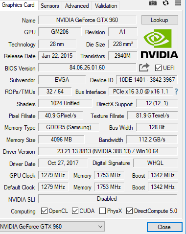

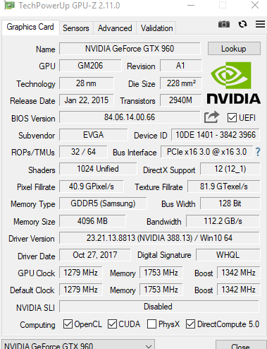

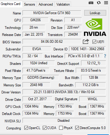

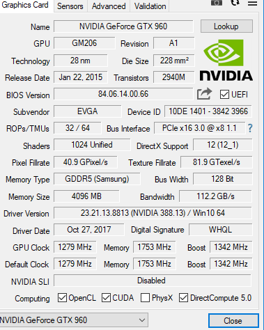

Code 43 with nvidia gtx960
It seems that no matter what I do, I can't get the code 43 error to go away with passthrough GPUs.  I have 4 GTX960s and am trying to get a 4 gamers 1 cpu build going with my threadripper build.  Here is what I have:
1920x threadripper
X399 Asrock TaiChi (bios 3.20)
1kw EVGA PSU
64 Gb vengeance corsair RAM
4x EVGA GTX960 SSC
I have dumped the bios from those cards and am selecting the .rom file within the machine setup.  It does recognize the card- but will not load the driver with a code 43.  It obviously has something to do with not loading because it sees the virtual machine.  I need some help getting things going- and am willing to pay if needed.  This is driving me a little crazy since I went through the guide:
https://forums.unraid.net/topic/69670-guide-fix-nvidia-code-43-issue-on-nvidia-gpu/
and even got an older image of windows 10- but am still having problems.
I ran through the process in the guide with versions 388 and 411 but am having no luck installing- code 43 every time.

image.png.8923eb54616eefb94e72e5e6dc2309a4.pngimage.png.6fd6dda7871d07445c3eb7d8a1424296.pngimage.png.3bf79c173a767113fac8caac13a397c6.pngimage.png.05010f613ad6df757eb746bfea279d4e.png
I have dumped each of their bios and hex edited the header.  I am removing all but 2 of the cards, the one that has always been in the top slot and unraid will choose, and the one faster card of the 4- ftw edition.  I can load windows without unraid and put full loads on all cards and p95 the cpu for hours on end with no thermal throttling- so this thing should be rock solid if I can just get unraid working.
Still getting the same result for 2 cards installed. VM Windows won't boot without the vnc card added.  It will still load if I add a card, and usually let me install drivers, but on reboot, it won't boot.

Nope, having some success now- no bad hardware- thank god.  Here is what I have found...
If I install vnc for graphics, it will not install the graphics card drivers, and nvidia detecting virtual systems is for real.  I'll get a code 43 if I install the regular drivers but if I get wdk and use the powershell script for hacking the drivers with version 388.0, I can install those- then upgrade to the 411 branch with no issues.  I just have to do the full install on hardware without ever adding the vnc video.  Never had to pass a rom doing that- just install on physical monitor and thnings go better.  Bios is latest, OVMF for bios- may try some additional testing to see if I can pin down the issues.
I got all 4 up and running! Now I'm on to the audio issues.... demon sound? Seems like a couple of scripts put together the right way could iron some of this out... did the msi edit, but no dice.
