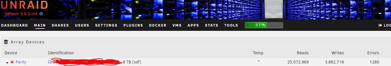

I got a parity disk disabled for no reason i know it got like 1280 errors on it.
Its an 8TB nas hdd drive.
Can someone help me please!!
Edit:
I tried to reboot and now i don't see the hdd.
Its says unassigned and no hdd option.

Parity disk disk dropped offline, so there's no SMART report, power off, check connections, power on and post new diags.
ok will do that thx
Here is the new diag
Juste power off server and power on and the hdd is reconized.. strange
unraid-diagnostics-20181004-1250.zip
Disk looks fine, earlier looked like the disk lost power/connection and immediately dropped out, suggest you replace both cables to rule them out and re-sync parity, if it happens again with different cables it's likely the disk.
