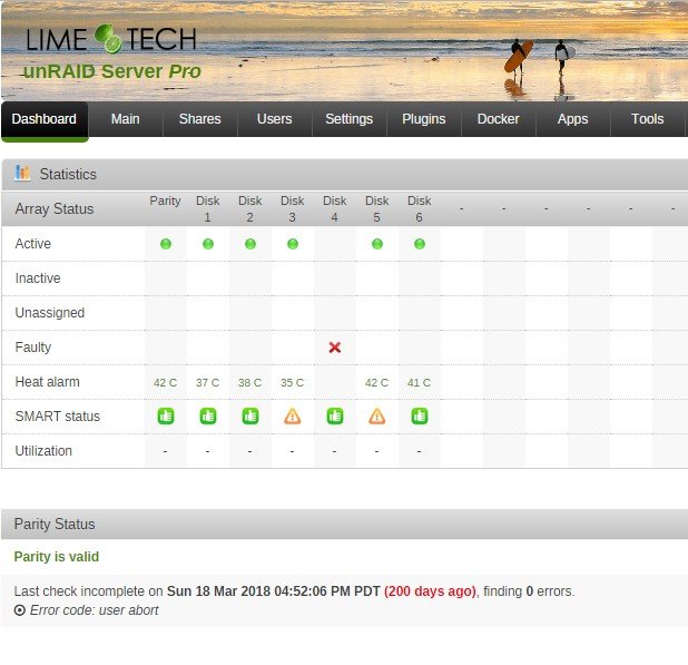

Drive 4 is showing Faulty.  Why?  it is showing good SMART indicators and it feels like it spins up.  I have placed this in a linux system and was able to successfully mount the file system.
Attached is a picture of the Dashboard

Disk got disabled, doesn't mean it's bad, it could for example be a cable/connection issue, please post your diagnostics: Tools -> Diagnostics
Also,  last parity check 200 days ago no bueno.

Diags are after rebooting, so can't see what happened when the disk was disabled, but there are already 696 reallocated sectors, worrying especially for such a new disk, prudent way to go would be to replace it.

Not really, only if you had those diags, but due to the high number reallocated sectors it was likely a disk problem.

reallocated sectors, where did you see that?
The SMART reports show that you have 2 disks with a large number of reallocated sectors.
