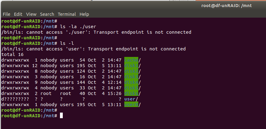

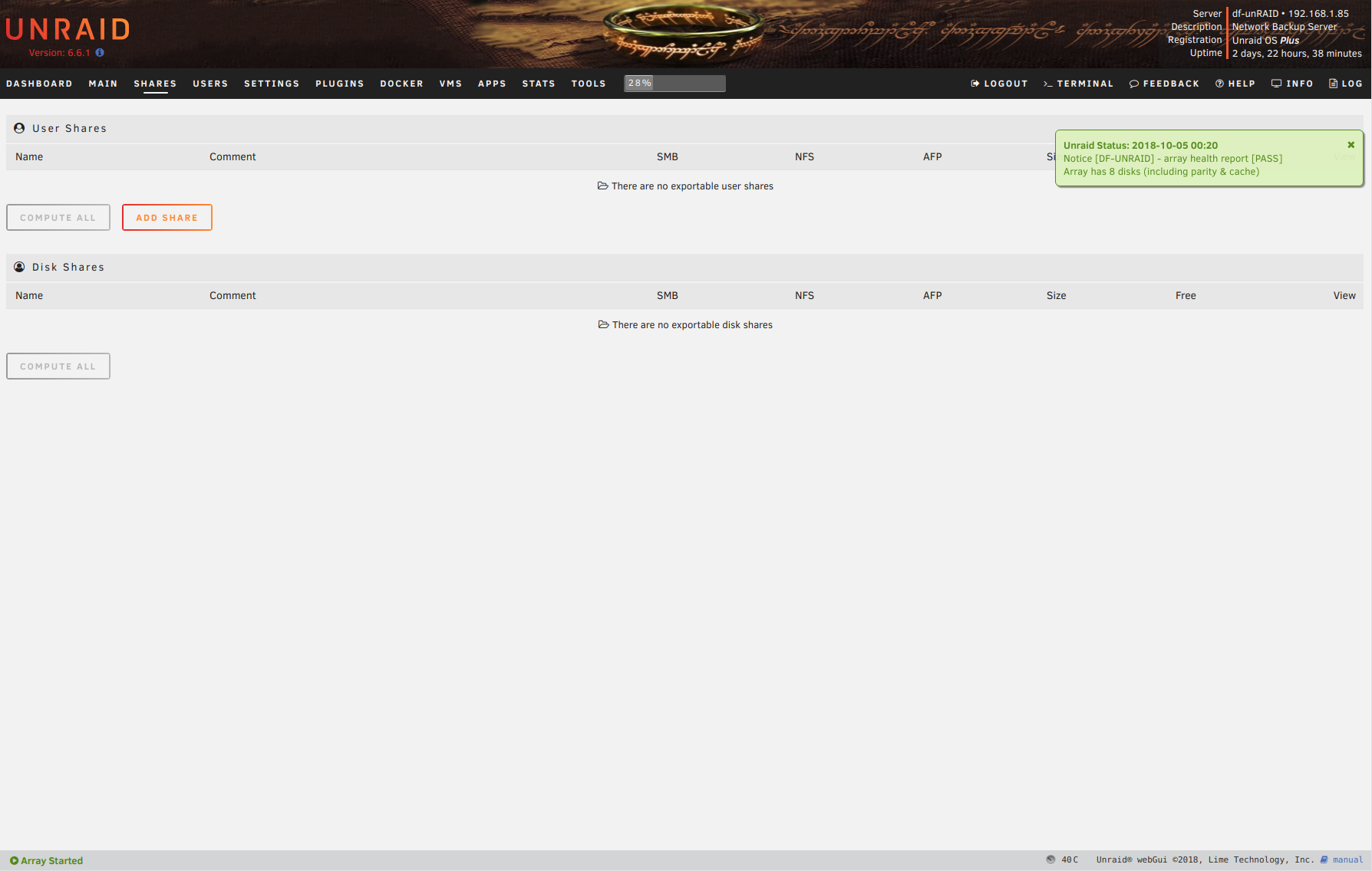

Today, when I login, the /mnt/user folder is *inaccessible*.  All the shares that were there in the unRAID GUI are *gone*.  The GUI says "There are no exportable user shares".
If I SSH into unRAID and check /mnt/user0, the files are still there so doesn't look like there's been any data loss at this point (I'll do more checking).

Attached are some screenshots of what I see via SSH and GUI.
I have not yet stopped and restarted the array, in case something's going on and it doesn't come back.
As you can see, there's a notification on the screen right now saying the automatic health check has passed.
What's going on?  Can anyone help diagnose this?

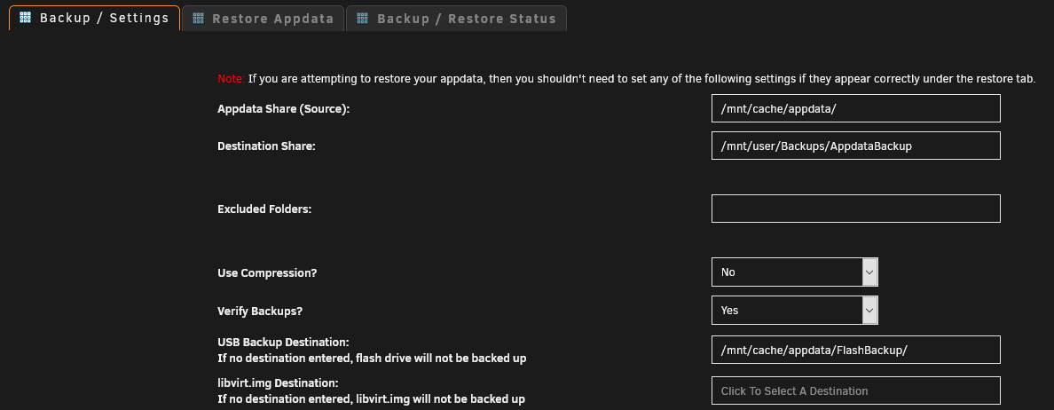

Install the CA Backup/Restore Appdata plugin.  As you can see from the screenshot of my plugin config below, it can automatically backup the flash drive (USB Backup Destination:) to the array, or, another location you specify.
I  have mine configured to backup the flash drive to the cache drive weekly.  Technically, I guess it is also backed up to the array since I backup the flash drive to a folder in appdata and then I backup appdata (including the flash drive folder) to the array.
Yep, I know there are plugins that can do it and this one is a good one.  I have it installed and configured the same way.
