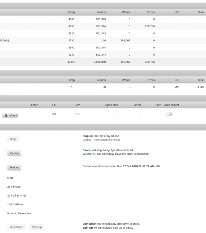

Long story short, I'm replacing disk3, out of 6 disks array (1 parity + 5 data drives). Within half an hour of rebuilding, disk1 thrown huge counts of read errors.
Screenshot and diagnostics attached.
I have preceded this replace/rebuild process with a quick SMART short self test on all drives, all returning 'Complete without error', including on the 7th drive (the original disk3 that I'm replacing, but this is for another topic).
Should i cancel this rebuild now, and if so, what's next for me? Letting the rebuild to finish, would still in the end leave room of doubt of data integrity due to those read errors during rebuild.

SMART looks fine, though your disks are running way too hot, replace/swap cables and try again, you can also run an extended SMART test, and try to improve cooling.

After watching the rebuild for a while and seeing there was no further error, I decided to let the rebuild finish. And it did so without any increment of the read errors. So what I have now is the new disk3 that's been rebuilt using the parity and combination read of 4 other drives, 1 drive of which churned out those huge read errors count during the rebuild.
I think I'll try to do a checksum comparison or dry-run rsync from the original disk3 (which I believe is still healthy though incorrectly disabled by unRAID).
