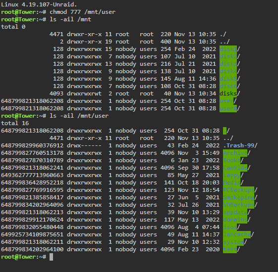

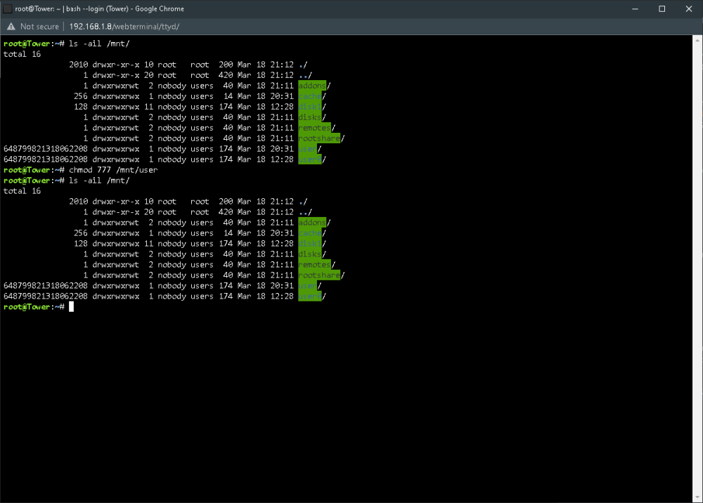

  • /mnt/user permission are wrong, type: chmod 777 /mnt/user then post output of   ls -ail /mnt
  • No, that's how it should be, something you did/ran changed that.

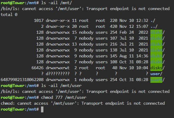

just happened to me on 6.8.3 while copying files from windows using WinSCP a transfer aborted and /mnt/user is gone
array wont stop and i do not have the Network app instaill everyone is talking about
diagnostics attached
root@Freya:/mnt/cache# lsof /mnt/user
lsof: WARNING: can't stat() fuse.shfs file system /mnt/user
      Output information may be incomplete.
lsof: status error on /mnt/user: Transport endpoint is not connected
