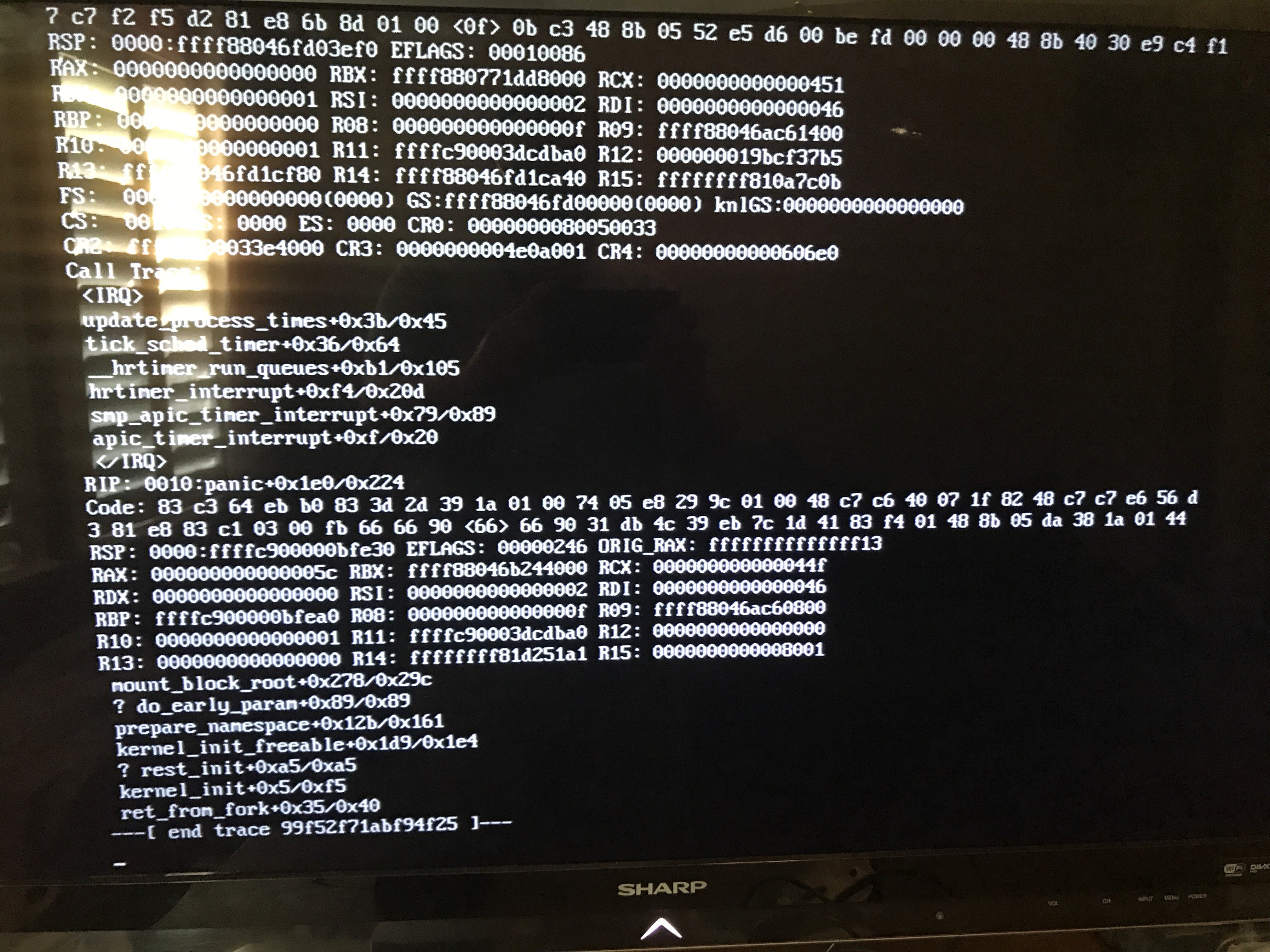

I have been testing some new hardware that I got and had my box plugged directly into the outlet without a surge protector. The power went out and now when I try to boot I get this and it hangs. I’ve tried booting in safemode and in safemode without GUI and get the same thing. I’ve tried the memtest boot option and it just restarts. Can anyone tell me what this means? I’ve been running unraid 6.6.0.
I copied everything from my usb drive to my computer, then used the usb creator to do a fresh install of 6.6.1. I then copied my config folder from my computer to the usb drive and replaced what was there. I ran the make bootable file and put it back in and everything booted right up. It's now running a parity check but I just got a notification saying usb drive read-write error. How can I fix this?2126693826_ScreenShot2018-10-07at11_24_26PM.png.15311e9b2969471bd2b0dc654637fc79.png
