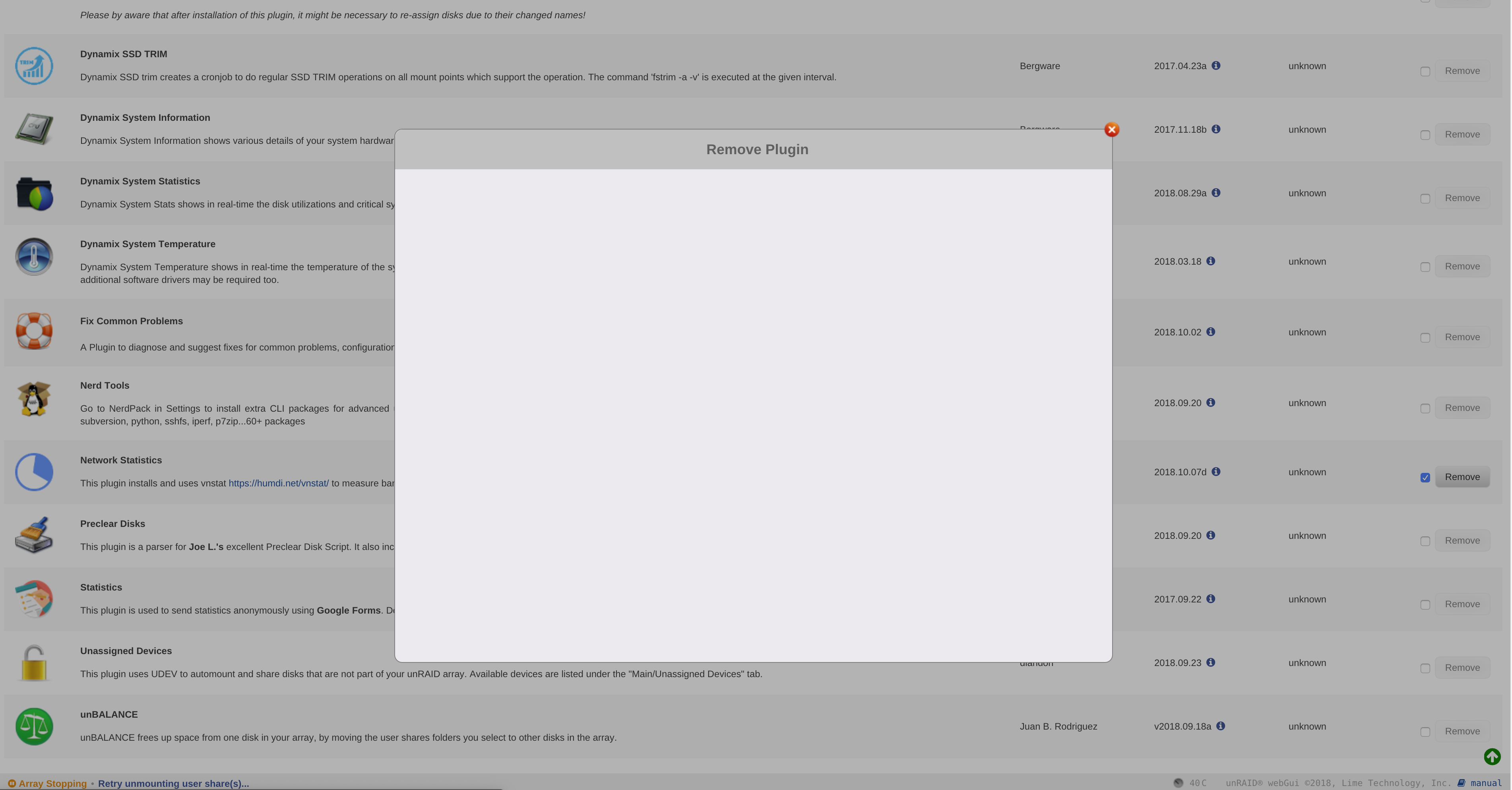

I tried that when I go to uninstall any plugin I get a blank window (see screen shot)
Shutdown the server, force it if you have to, and manually deleted the plugin from the flashdrive before powering back on, or boot in safe mode an uninstall it.
