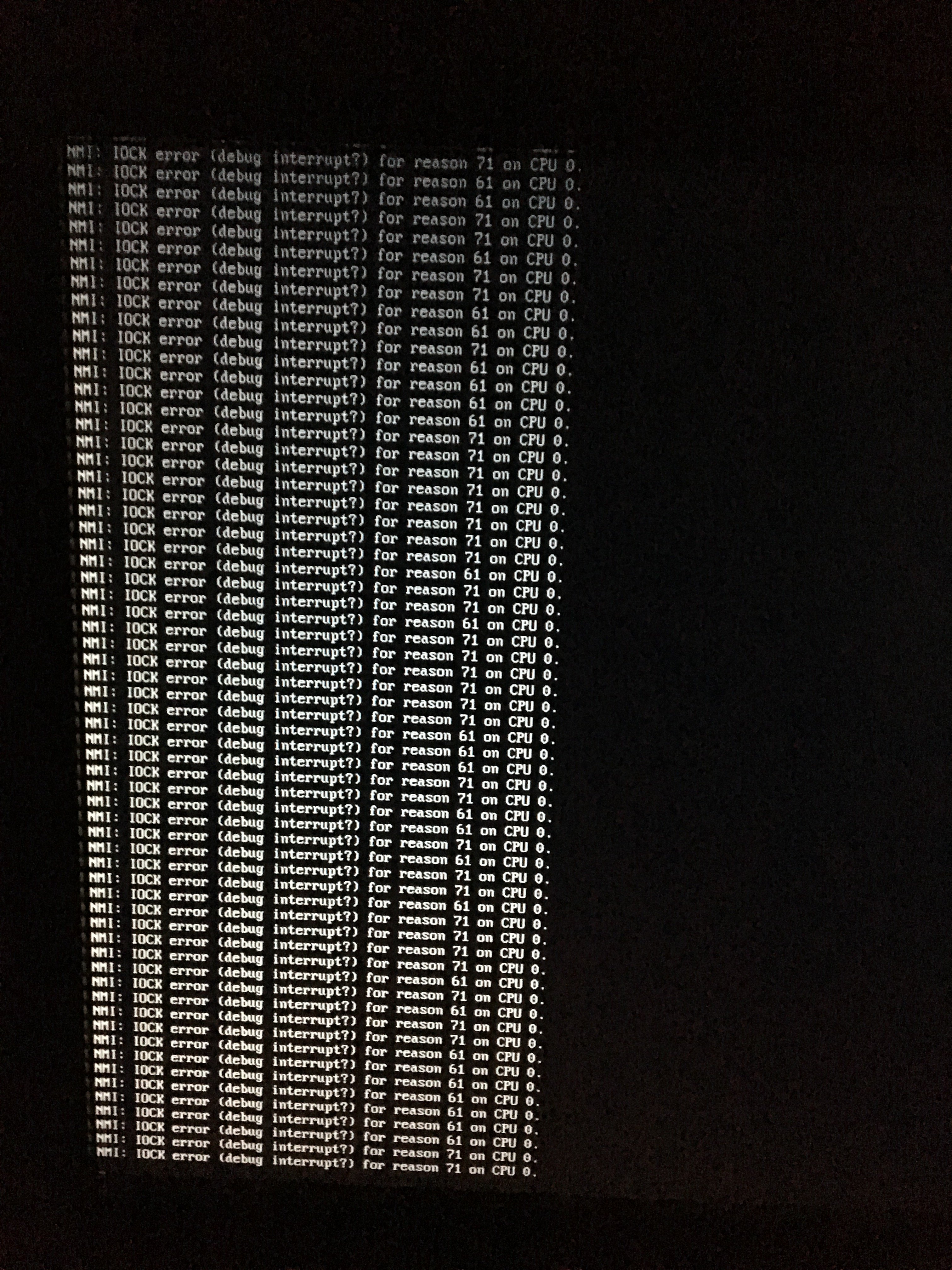

I could access my storage through Windows like normal, but when I'd log into my unraid web gui, it would accept my UN/PW but then 504 timeout and not load the GUI.
Attached is a screenshot of my server.
I did a hard reboot and nothing happens :-(
Things aren't looking good, are they?
Anyone have any suggestions?
