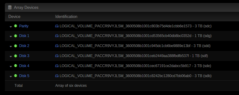

Recently decided to upgrade server but have an issue with my current setup.  Currently running each drive through a raid card without JBOD support.  Not a problem (I thought) Ill just run each drive in a raid 0 by itself.  Works but now that I'm looking to upgrade I realize what a mistake that was.  Is there anyway to build a new machine and use the same drives without data loss?

Most likely won't work, but it will depend on the RAID controller used, it might be possible to do a new config, you'd need to test if a disk mounts connected to an HBA or onboard SATA port.
As Johnnie said, whilst it 'may' be possible, in reality I would brace yourself for a rebuild.  I had the same issue after swapping to a JBOD card, in the end I started again and restored my data from a backup. :)

Solution (not ideal) but it worked for me.  As I had no backup at the time and could not afford to lose any data.
  1. Remove 1 drive from the raid card and plug it into the motherboard.
  2. Rebuild array.
  3. Repeat steps 1-2 until all drives are plugged into the motherboard and the final rebuild is finished.
  4. Swap into new system with a raid card in JBOD mode.
