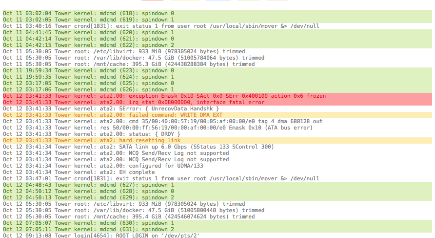

This morning, while checking unRAID, there was a warning that it had detected UDMA CRC error. Upon checking the log I saw several warnings, screenshot of the log is attached.
Should I just ignore this error, or should I do something about it?
A single error can be ignored, but if it happens again replace the SATA cable.
OK, thanks @johnnie.black, I'll keep an eye on the log, and if the error persists I will change the SATA cable for the drive.
