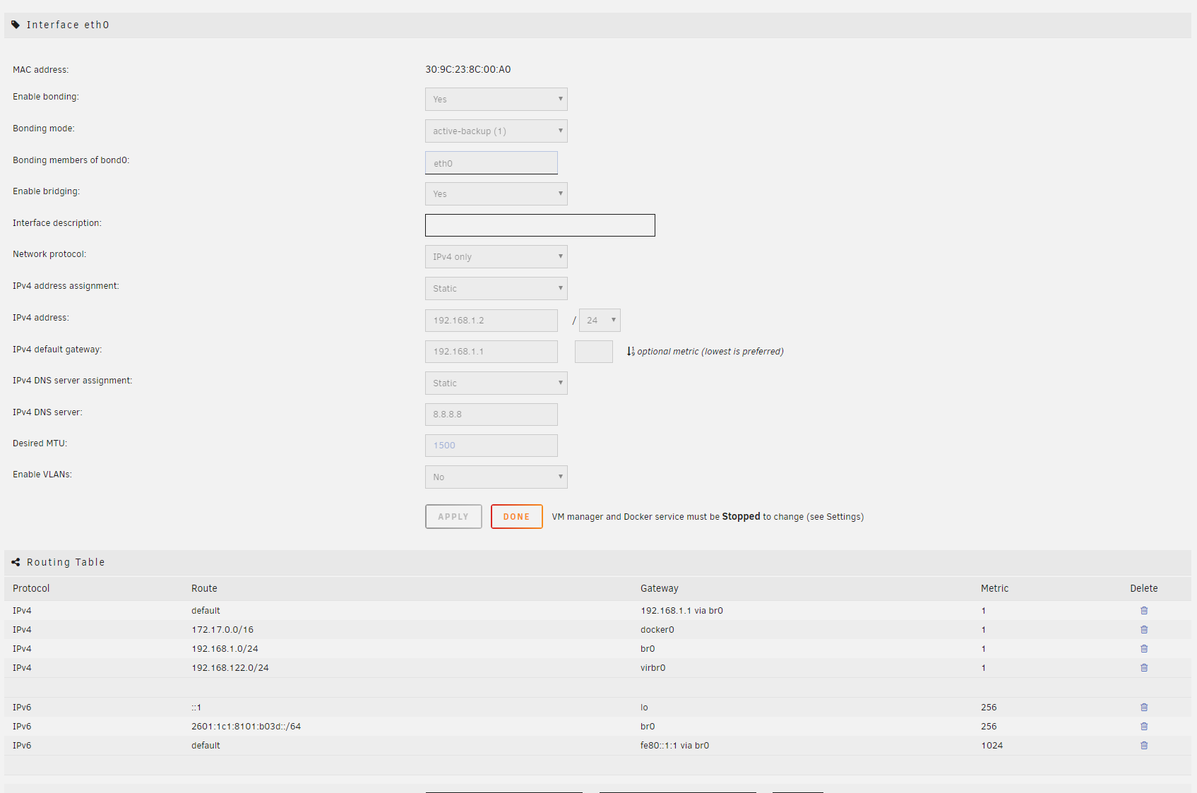

Here's my network config for your convenience:
root@RackServer:~# ifconfig br0
br0: flags=4163<UP,BROADCAST,RUNNING,MULTICAST>  mtu 1500
        inet 192.168.1.2  netmask 255.255.255.0  broadcast 0.0.0.0
        inet6 fe80::74c7:f1ff:feb4:9aab  prefixlen 64  scopeid 0x20<link>
        inet6 2601:1c1:8101:b03d:329c:23ff:fe8c:a0  prefixlen 64  scopeid 0x0<global>
        ether 30:9c:23:8c:00:a0  txqueuelen 1000  (Ethernet)
        RX packets 45091  bytes 11679872 (11.1 MiB)
        RX errors 0  dropped 0  overruns 0  frame 0
        TX packets 11747  bytes 4167642 (3.9 MiB)
        TX errors 0  dropped 0 overruns 0  carrier 0  collisions 0
root@RackServer:~# ifconfig eth0
eth0: flags=6211<UP,BROADCAST,RUNNING,SLAVE,MULTICAST>  mtu 1500
        RX packets 45289  bytes 12529068 (11.9 MiB)
        RX errors 0  dropped 7  overruns 0  frame 0
        TX packets 13090  bytes 4314753 (4.1 MiB)
        device interrupt 16  memory 0xdf800000-df820000
No broadcast address? Shouldn't that be 192.168.1.255? Why is it not set properly?
