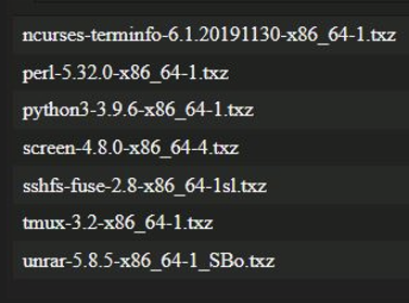

On another note regarding all of your popular docker apps, I was just reading that upgrading to 6.11 requires the removal of Nerdpack.   Some plugins are now part of unraid, but others have to be manually installed if they are still required.
One of the dockers I installed (maybe more) included instructions to install NP to add perl, unrar, Python, etc.  I don't recall if it was any of yours.   Does any of your dockers need any of these apps?
If not, I'm going to uninstall the above and NP and upgrade to 6.11.  If they are still needed, I'll have to dl and install manually now before upgrading to 6.11.
nope.
