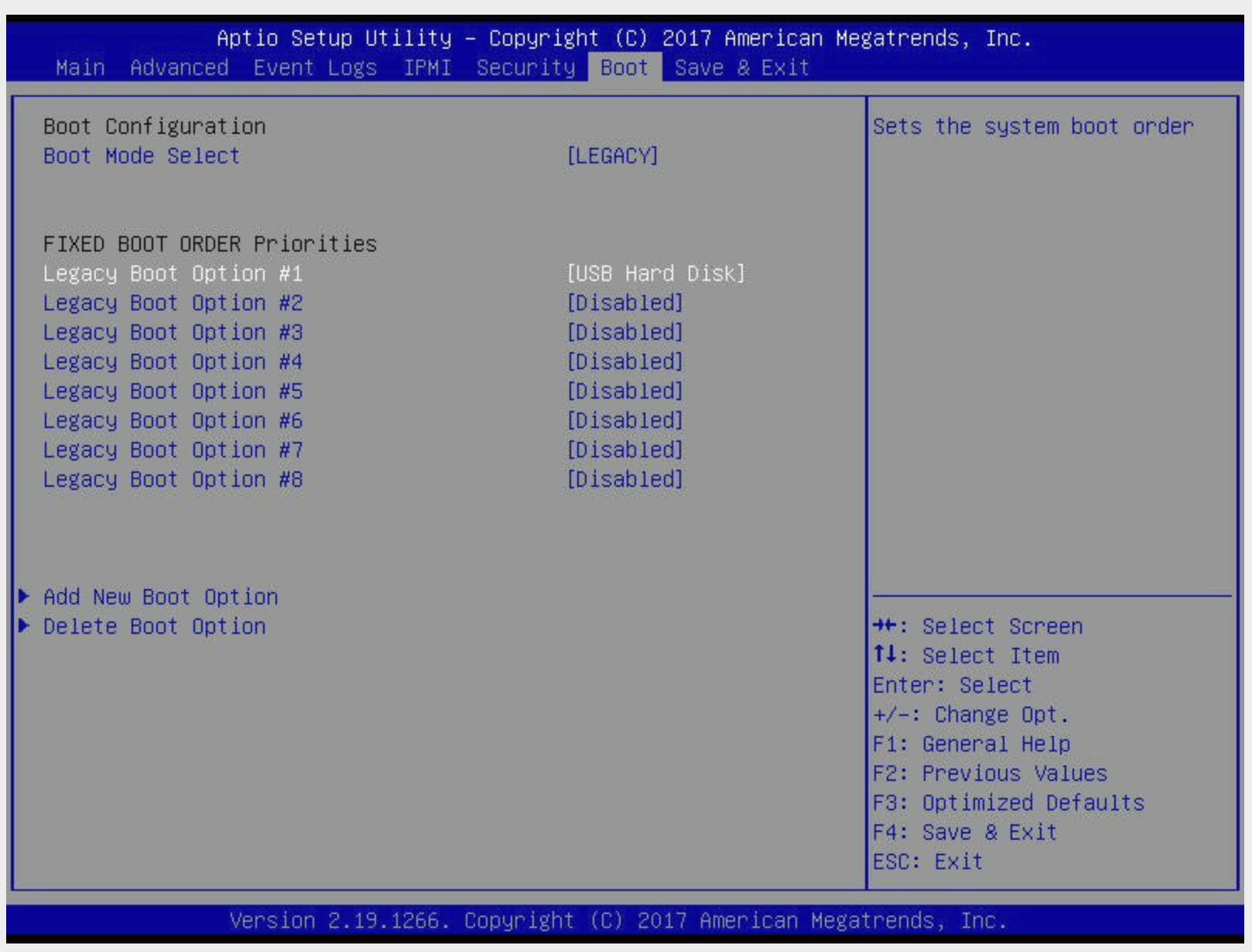

Another issue that I have is I could boot to the USB. I kept ending up EFI Shell screen. How do I boot to unRaid?
Change settings in BIOS to boot legacy or enable UEFI boot in unRaid. I think it's in release notes, something about renaming a directory on the USB drive.

I selected legacy boot and selected "USB Harddisk" as the only boot option and disabled the rest. When I restarted, it booted to EFI Shell again.
If I change the Boot Mode to UEFI, it sees the USB SanDisk, but it doesn't boot from it.

Read the thread I linked to if you're trying EFI boot. You need to do things.
Do I just need to rename the folder named "EFI" to "EFI-", is that correct?
I just checked the USB drive and the folder is already "EFI-"
I renamed it to "EFI" and it seems to be booting now and I think I am back online.
