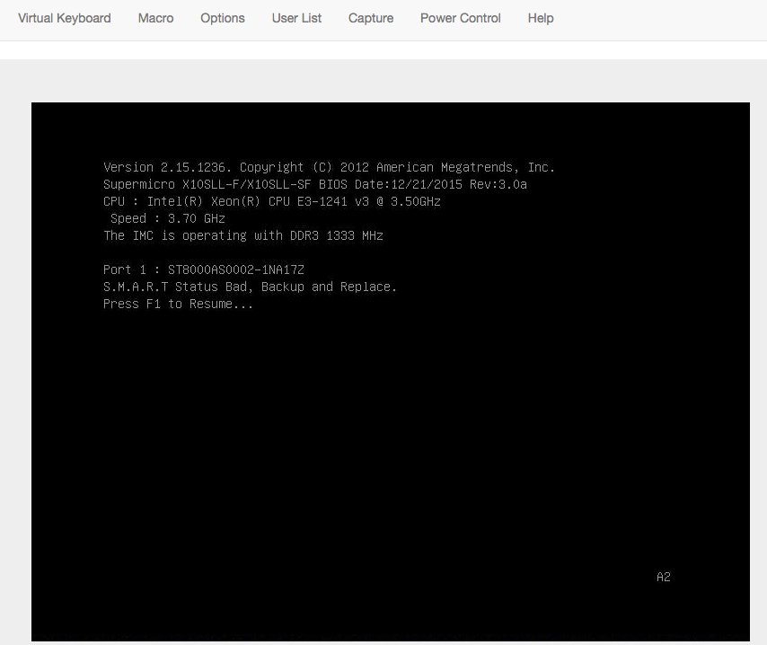

Doesn't look good for this drive. Shutdown the server and replaced the SATA cable with a new spare. When I attempted to boot I got this via IPMI-
I was able to reassign this disk as parity though. Parity sync/rebuild is currently in progress. Current smart report and diagnostics attached.

I wouldn't even bother. When SMART flags on boot, the drive is a goner IMHO. SMART is typically conservative on its recommendation. When it says failed, believe it.
I don't see anything in the smart report though other than the UDMA CRC error count. I really don't know much about HDD's but it's my understanding that this usually indicates a bad cable.
Did I miss something else? Or maybe I'm wrong? Happens sometimes.😄
Dunno what to tell you. Was that SMART report taken after the image you posted? If so, that's strange, I don't remember ever seeing a drive fail SMART and subsequently pass it.
That's weird, SMART status bad means there should be a failing now SMART attribute, still disk is showing some issues, mainly:
183 Runtime_Bad_Block       -O--CK   063   063   000    -    37
If it fails again I would replace it.

The SMART was taken after the boot up completed. I was surprised by it as well. Running a new one but with the parity sync running it'll take a while.
