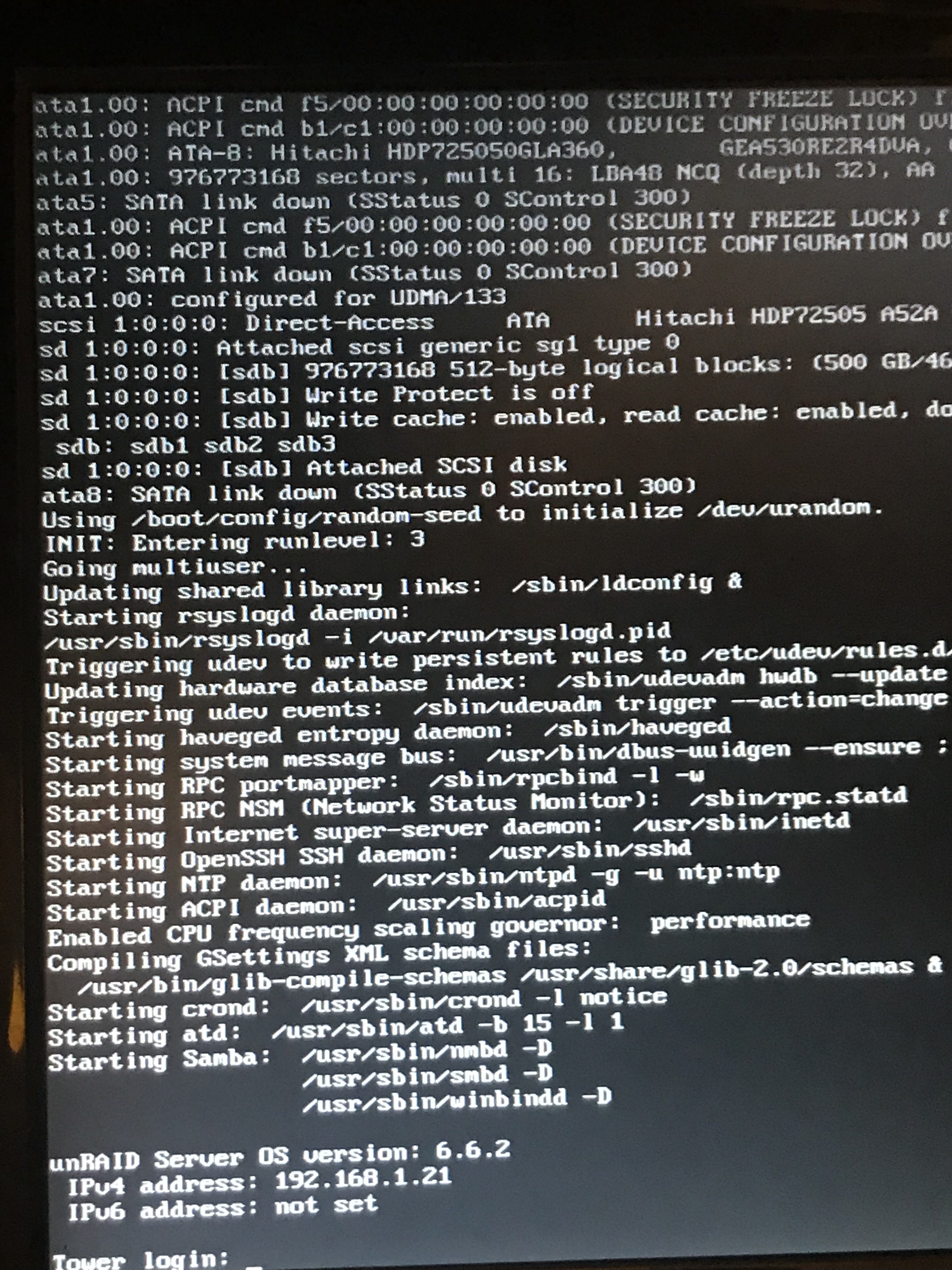

the pc start well, until I see:
IP adress
Login Tower:
( I can see it from my routeur )
