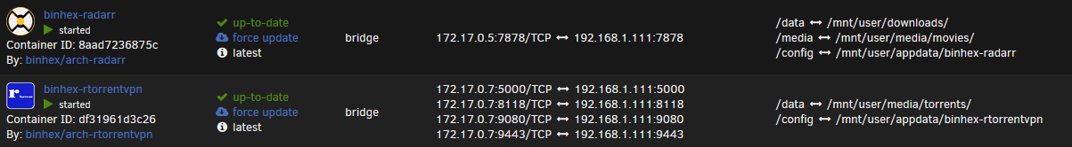

Do I have the settings correct?  I'm wondering if I might still be missing something here.  Thanks!
Edited by EC28
More Info:
