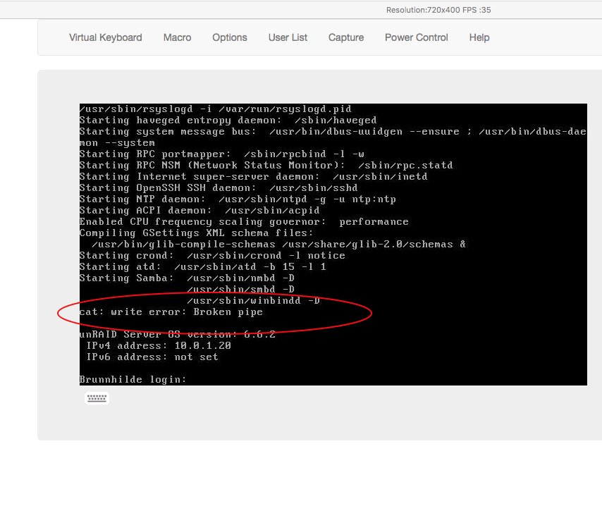

I'm not exactly sure when this started since I don't usually watch the console boot process, but I noticed a broken pipe error-
Boot completes ok and it doesn't seem to be causing any problems. Is it worth worrying about?

I believe its a typo in the cache_dirs update recently pushed out.
So the cache_dirs update pushed yesterday afternoon should fix it? Or is that the one with the typo?
Made sure all my apps are up to date and upgraded to 6.6.3. Still seeing the broken pipe on boot. I'm sure I could uninstall my apps one at a time to track down which one is causing the error but is there an easier way? Current diagnostics attached.

I updated to 6.6.3 today. Reinstalled the "user scripts" plugin since it was marked to have the broken pipe fix. However as soon as I installed it and rebooted, it's back again. Uninstalled it and rebooted, and it's gone again. So I think something is still off with it.
