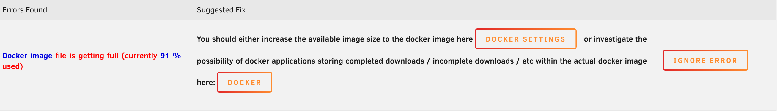

So I got this message via Fix Common Problems:
230810403_ScreenShot2018-10-17at9_04_04AM.thumb.png.d15b29274f02dea0c132ddcd0270b598.png
I don't know why this is and can't figure out how to solve the problem. There were a couple of downloads but they were only taking up 5% of space (and they get moved off anyway). Any suggestions?

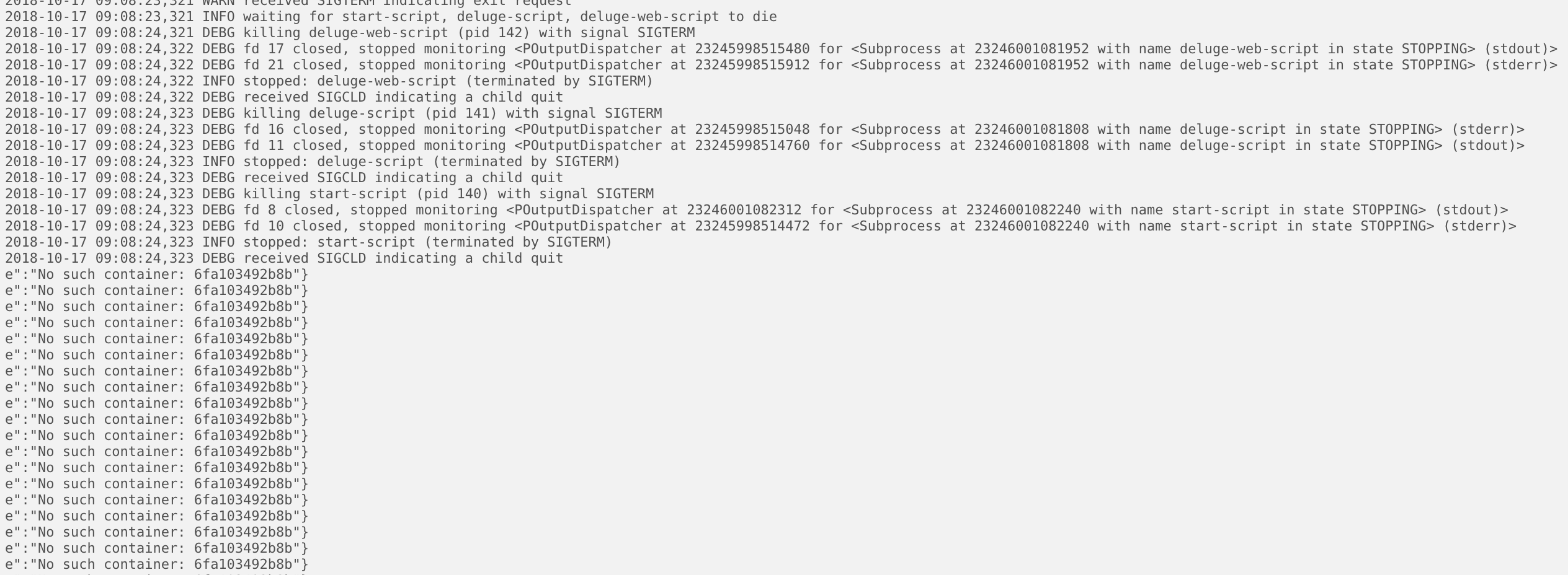

Meanwhile - deluge stopped working for some reason. I stopped the service and restarted it and here is what the log looks like - it says no container? which seems odd. I haven't changed any settings on it since i set it up and it worked fine last time i used it a few months back... any suggestions?997372628_ScreenShot2018-10-17at9_10_52AM.thumb.png.51302364836823a2a0ca136d75e005a1.png

Refer to the real Docker FAQ here.  There's a couple of entries on why the image may be filling up.  Deluge not working is most likely a by-product of that, and a reinstall of it (Apps - Previous Apps) should fix you up.
thanks, i'll check those out and report back if i'm still stumped.
