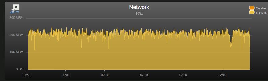

I have setup below case for testing ( Unraid, 10G in SFP+ optic ), no issue and will update the result for 1hrs test.
- Static IP on 10G br0
- br0 form eth1 + eth2 ( eth2 no SFP+ )
- XG Switch turn-on STP
** Update **
No issue found for above test with 1hr.
Edited by Benson
