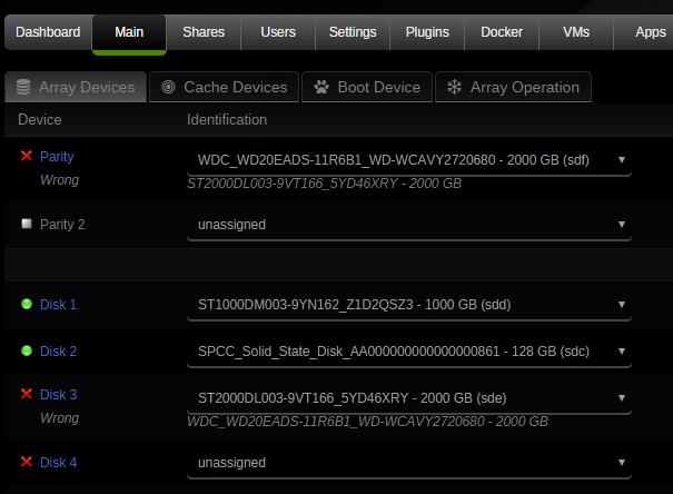

Okay, how do I get my unraid out of Array Starting to be able to make those changes, when I shutdown and power back up, it automatically starts
Disable array auto-start by editing disk.cfg on your flash drive (config/disk.cfg) and changing startArray="yes" to "no", then reboot.
Okay, that's changed but it wont let me change my parity device to my other 2TB drive it says it's the wrong drive for the slot.
What are you trying to do? You can't change two disks at the same time with single parity, and why are you trying to assign the failing parity as disk3?
I was just moving it around to see what disk I currently had in there. It wasn't for any purpose other than seeing what drives i had to replace. Even with removing the bad drive and replacing it with a good drive, it won't let that change take place.
You can't have two different to drives at once, if you move one drive from one slot to a different one you're trying to do that, since that disk will be missing in the original slot and is now a new disk on another slot, if you want to do that you need to do a new config (tools -> new config) , though and in case it's not obvious if you assign old disk3 to parity after a new config it will delete any data there.
So, should I wait till my new drives come in to make a change so I don't have to change Disk3?
If disk3 has data you have to wait or move it to other disks.
I get that part, I wanted to make sure that was the way I should go.
