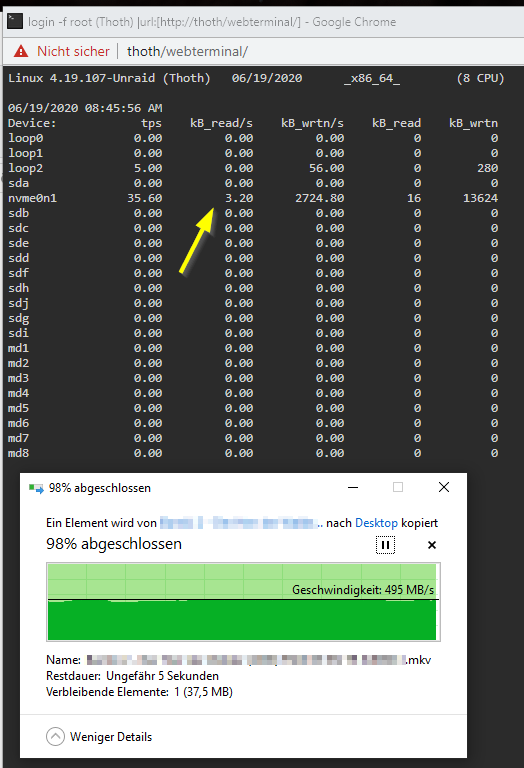

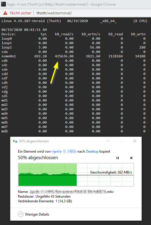

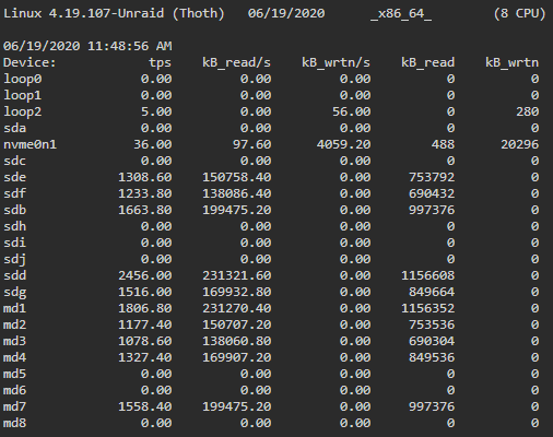

b) Started iostat as follows:
watch -t -n 0.1 iostat -d -t -y 5 1

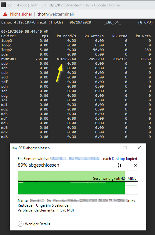

c) I downloaded through windows a huge file that is located on my SSD cache and as we can see its loaded from the NVMe as expected:
d) Then I downloaded a smaller file to test the RAM cache. The first download was delivered through the NVMe:
e) The second transfer shows nothing (file was loaded from RAM / SMB RAM cache):

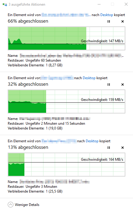

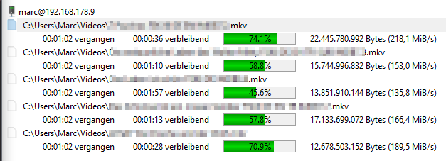

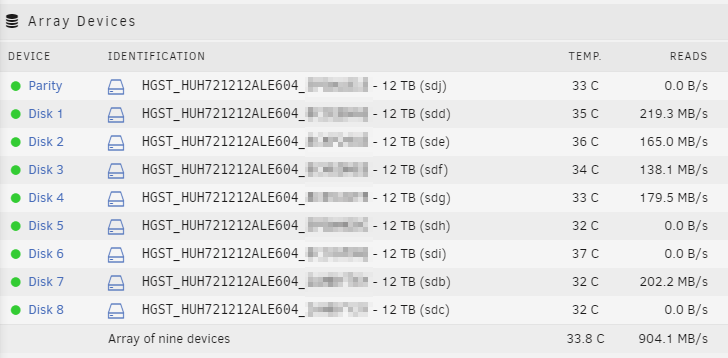

No need to test iperf. I enabled the FTP server, opened Filezilla, set parallel connections to 5 and choosed 5 huge files from 5 different disks:
By that I was able to reach 900 MB/s in total:

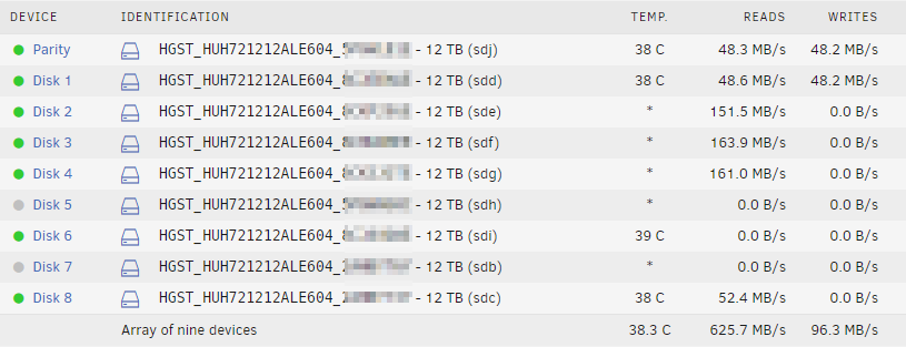

Similar test, this time I started multiple downloads through Windows Explorer (SMB):
This time my wife viewed a movie through Plex, so results could be a little bit slower than possible, but Filezilla was still able to download >700 MB/s so shouldn't be a huge difference.
So whats up with SMB? I checked the used SMB version through Windows PowerShell and it returns 3.1.1

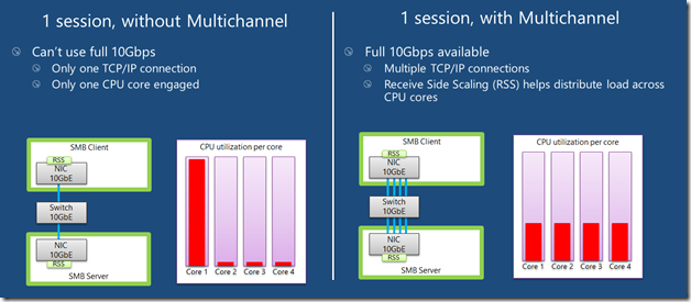

server multi channel support is still active because it enables multiple tcp/ip connections:
Side note: After downloading so many files from different disks I found out that my RAM has a maximum smb transfer speed of 700 MB/s. But if I download from multiple disks the transfer speed is capped at around 110 MB/s (and falling under 50 MB/s after it starts reading from Disk). All CPU cores have an extreme high usage (90-100%) if two simultaneous smb transfers are running. Even one transfer produces a lot CPU load (60-80% on all cores).
Now I'll try to setup NFS in Windows 10.

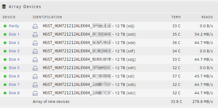

Ok, last test for today. Now enabled NFS in Windows 10 as explained here and downloaded from 3 disks (the 4th disk was busy through UnBalance). As you can see I was able to hit 150 MB/s per drive without problems:
Conclusion: Something is really wrong with SMB in Unraid 6.8.3.
