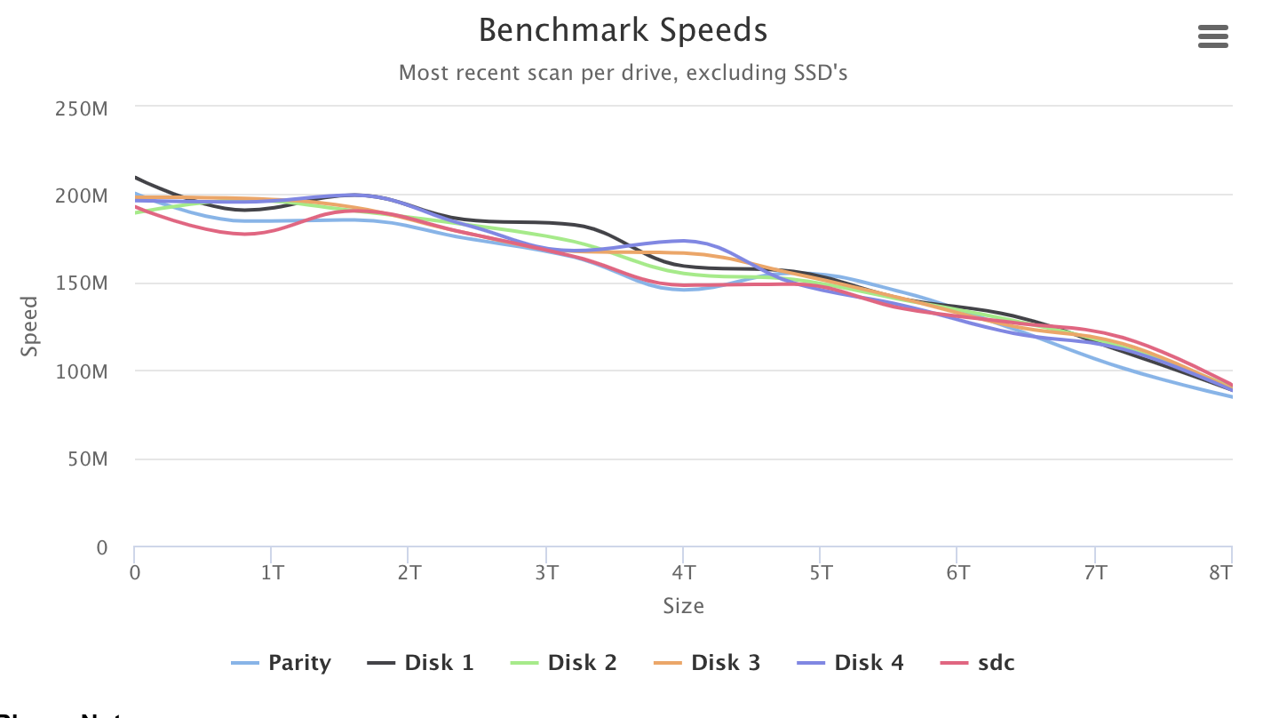

So I did install the speed test docker container and here are the results for all five array disks plus one not in the array for comparison:
I also copied a file over wifi, starts around 20 MB/s stays there until about 37 % an then drops off to 6-8 MB/s
sassrv-diagnostics-20181020-0727 (1).zip
Those look normal, though the test only scans a very small percentage of the surface, but likely the problem isn't the disks, you need to do some testing to rule things out.

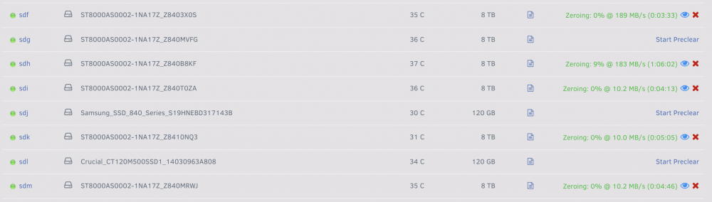

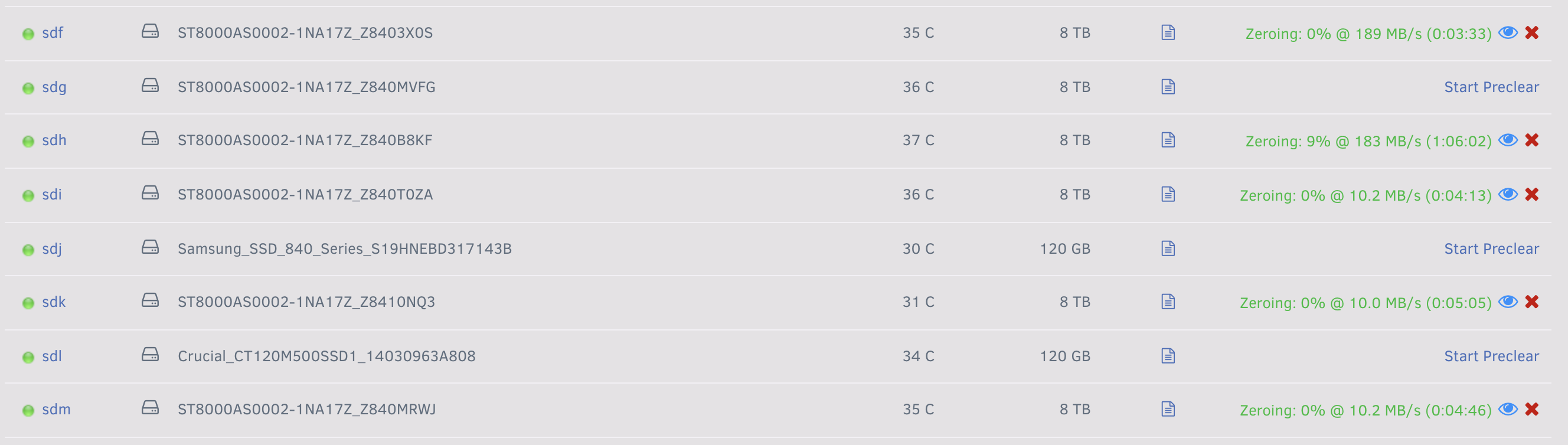

I started a preclear on the rest of the disks of the array. All connected to the same controller 2 run at about 183 MB/s, 3 at 10 MB/s
514967861_Screenshot2018-10-20at14_50_51.thumb.png.3204113f8a3834c472394a7f07b98df7.png
Something is going like you said, but still don't know what
I did switch the cables between a fast and a slow disk but nothing changed, so I wouldn't blame the cable
Edited by Faba
