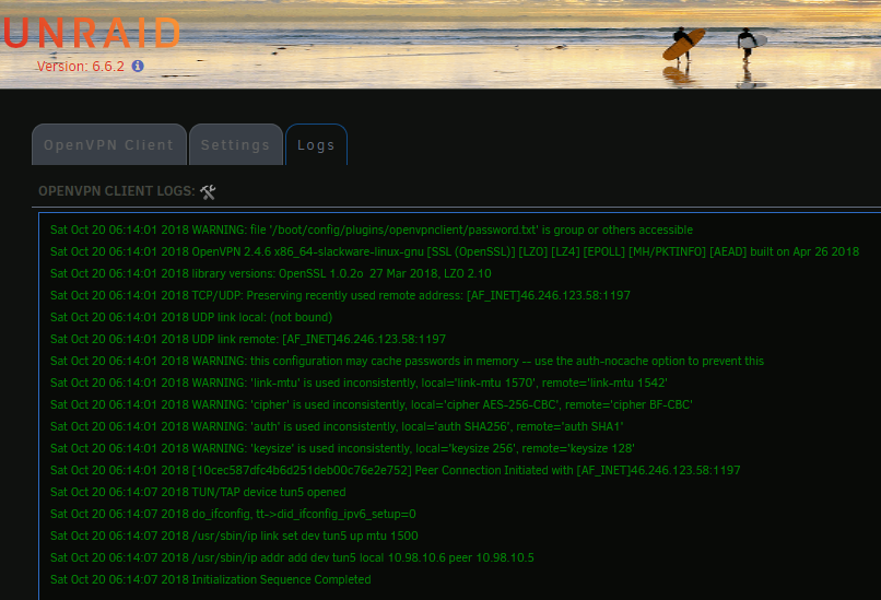

My Client plugin works fine here
982067963_2018-10-2006_14_56-Tower_openvpnclient.png.82dd3d9fd4a834251b174d15c2df0122.png
