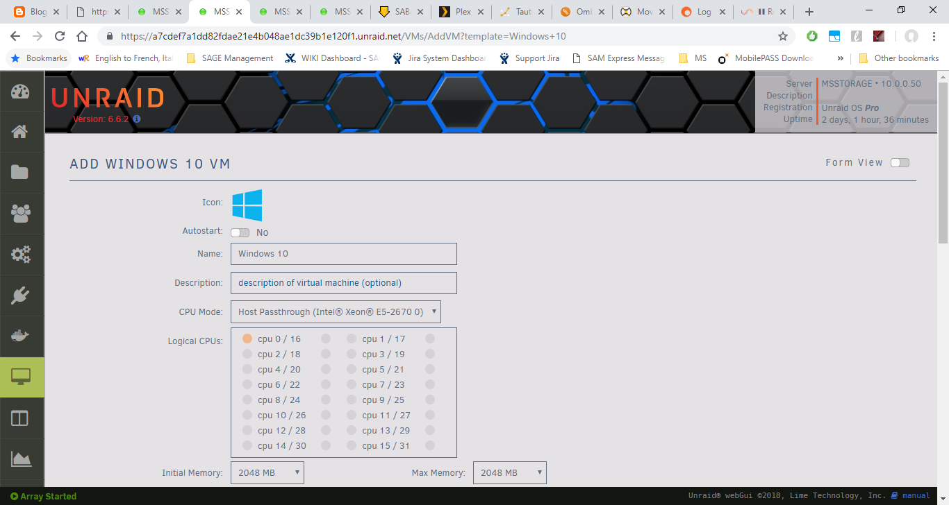

I'm assuming that you mean this as I have nothing else for Windows 10.

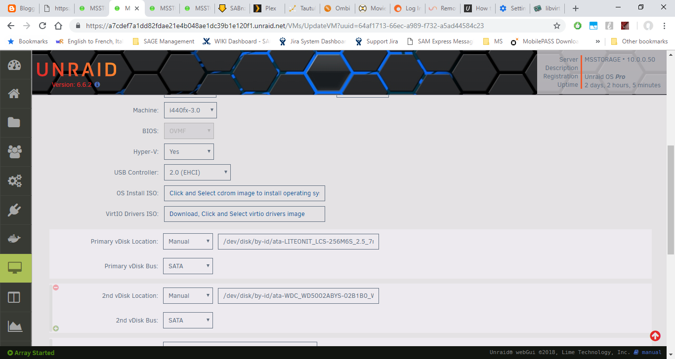

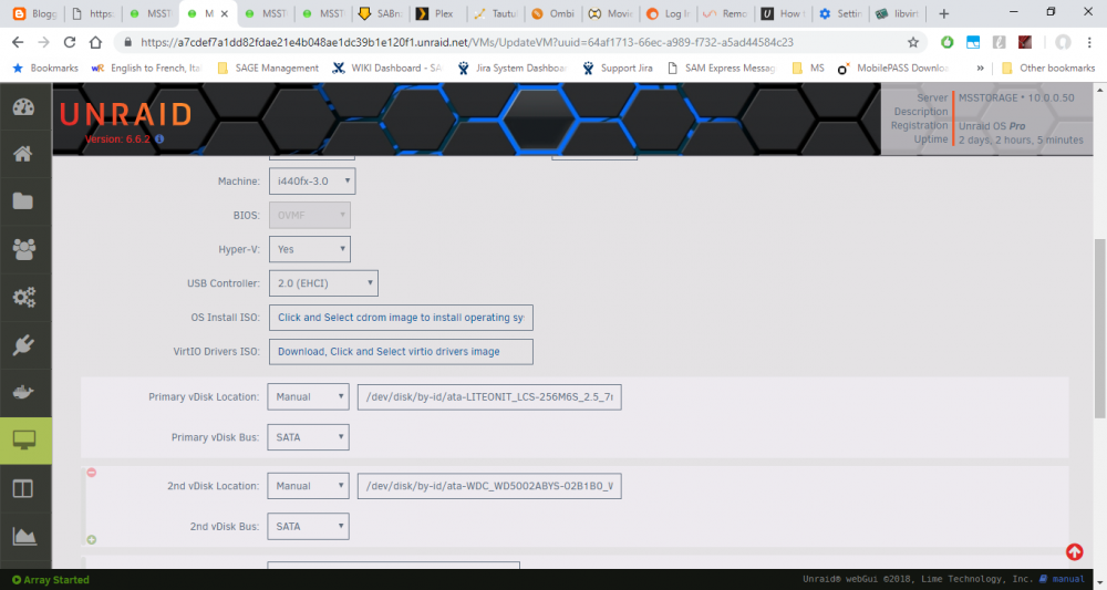

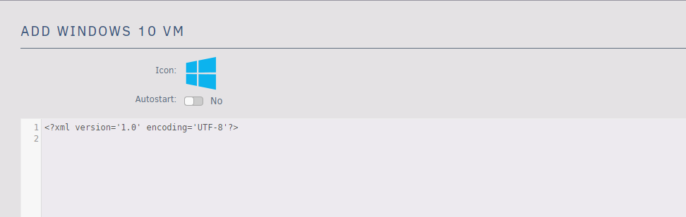

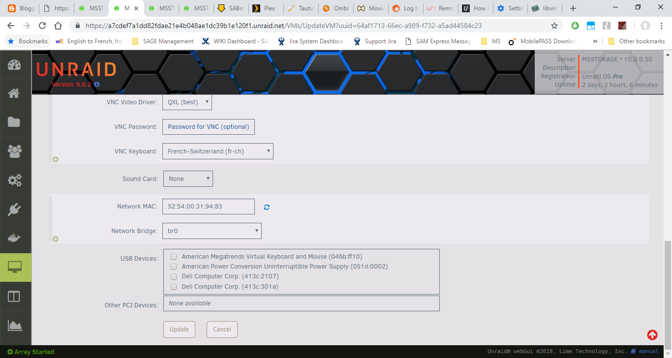

That is not the screenshot of the template. That is of the xml, but your xml is also missing. Switch off xml view and post a new screenshot.
 3.thumb.PNG.c2a32fd112c76f20b8483dcbfe7d593f.PNG2.thumb.PNG.f6c52a5512608d3c44cf13f9678db76d.PNG1.thumb.PNG.d0969a1a3b6c3a0739a875092e369cb1.PNG
ok, this way?
This might be a bug. Either report it or delete the hostdev tags for the devices in xml mode. On phone, so can't paste what you need to remove.
