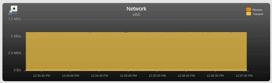

I've noticed since upgrading to 661, that my local network transfers are bottlenecking at 5.6MB/s.

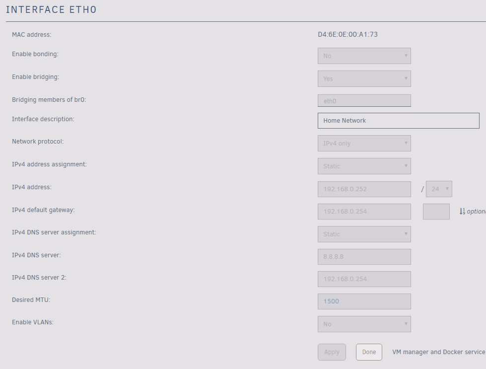

Here are some screenshots of the various network configurations... etho0 is the local network NIC connected directly to a DLink Smart Switch.
