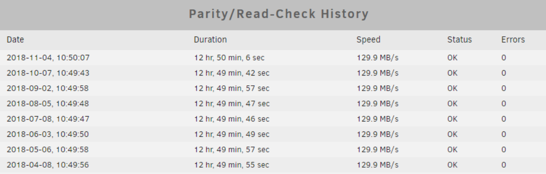

Has anyone noticed that schedule for parity checks is being ignored and seems to run on the first of the month regardless of what scheduler is set at?
I have had this since 6.6.2 and has happened again on 6.6.3.
Not really a problem but with exchanging drives throughout the month and running drive rebuilding  twice this month , I really didn't want a parity check until the 1st of the year, which is what the scheduler is set at.

2 minutes ago, bonienl said:
There is a bug report about this. It will be fixed in the next release.
1 minute ago, Frank1940 said:
You should probably post this issue here:
   https://forums.unraid.net/bug-reports/stable-releases/
Thank you it looks like it will be handled next release .
Might hold off adding new drives until then, just for the sake of not putting any more stress on server until necessary.
